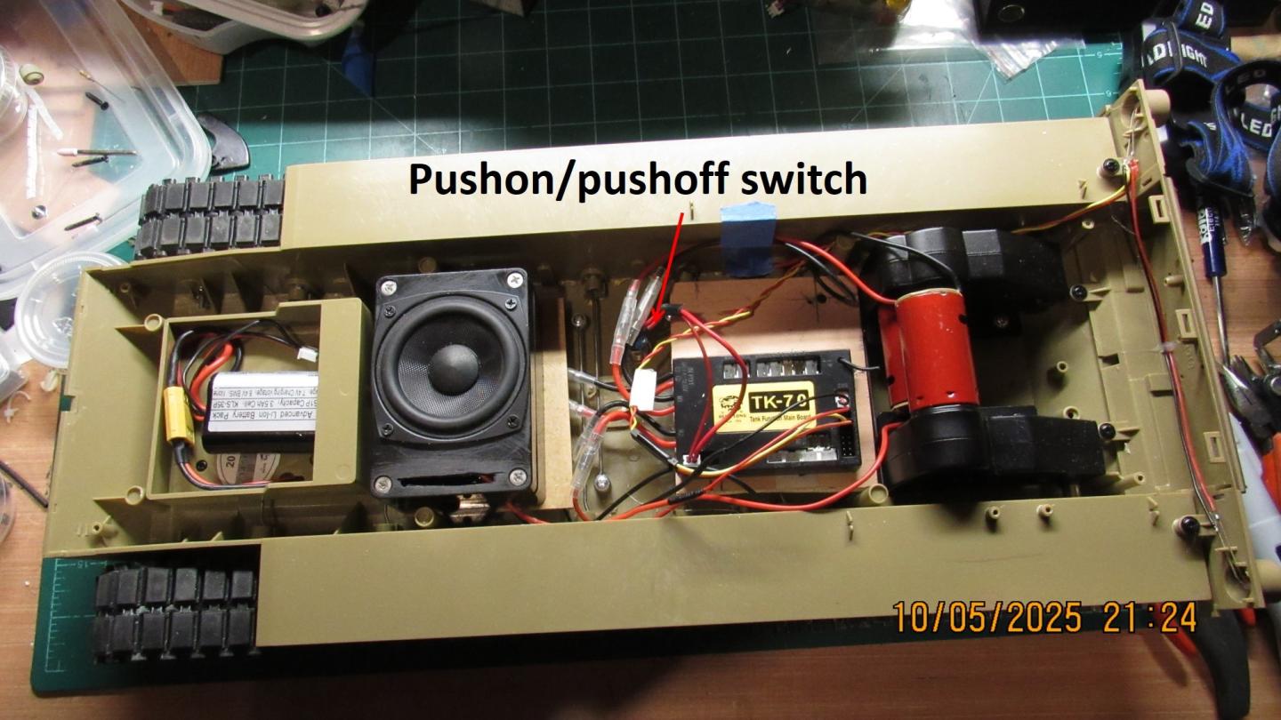

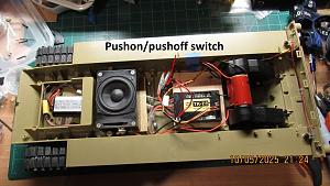

      The switch is a shorting switch connected to CN1. I relocated it to the tank floor with a water proof round pushon-pushoff switch. Drilling a round hole is much easier than cutting a rectangular hole.
