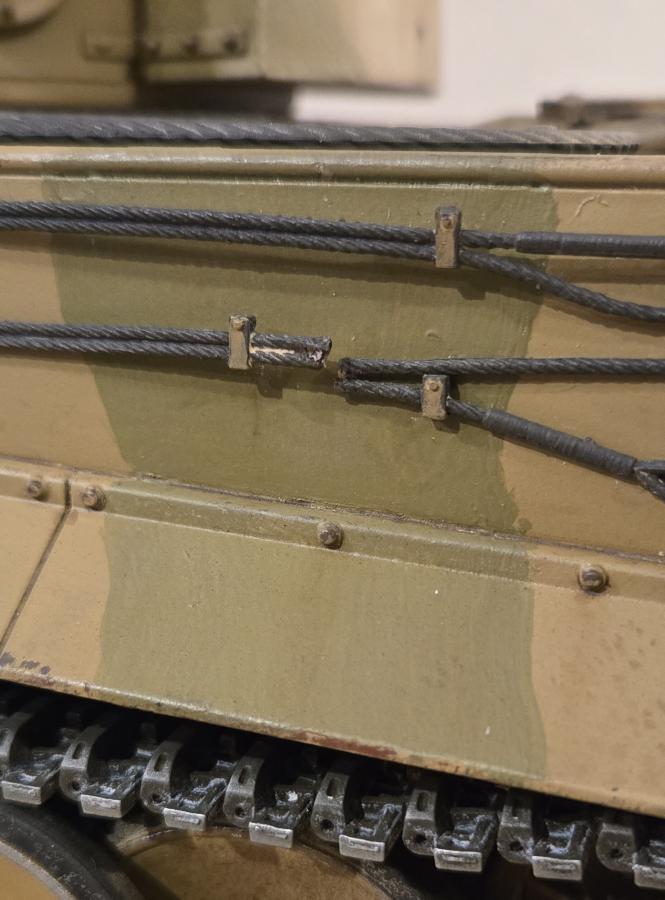

            Yea both sides on the turret. Would you also happen to have an extra side mounted tow rope? Somehow mine cracked apart. If not I'll just glue it. Thanks

              No extra track cable sorry. I cracked one of mine too and just haven't fixed it yet.
