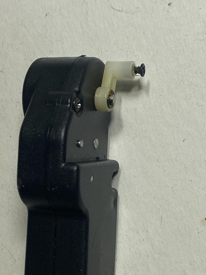

    I have a new King Tiger and the main barrel wont go all the way down. It does raise but acts like its loose inside. It will move up and down a freely by hand. Where do I need to start? Thanks

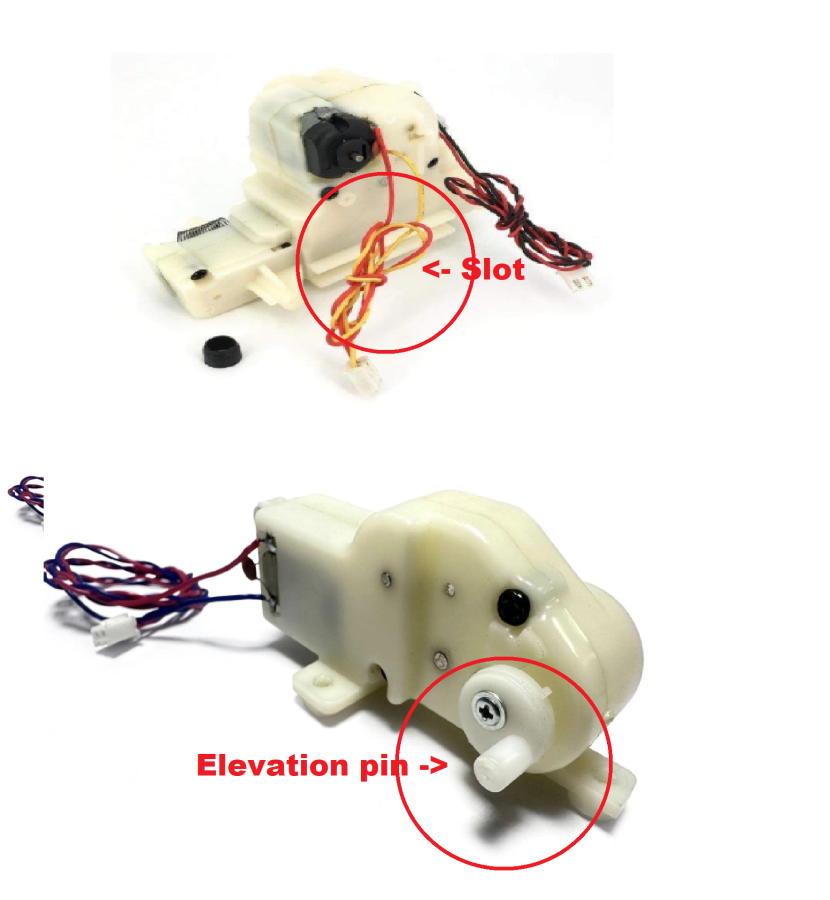

        In the turret there is the barrel firing/ elevation part in white plastic. The elevation part has a pin off the side that fits into a groove on the firing part. Sounds like yours is not in that groove (not sure if the groove in the picture is the correct side).

        • #5
          On some of my big tanks, I had to add a screw at the arm to ensure it stayed in the groove.

          • #6
            Thanks Guys I will disassemble and investigate!

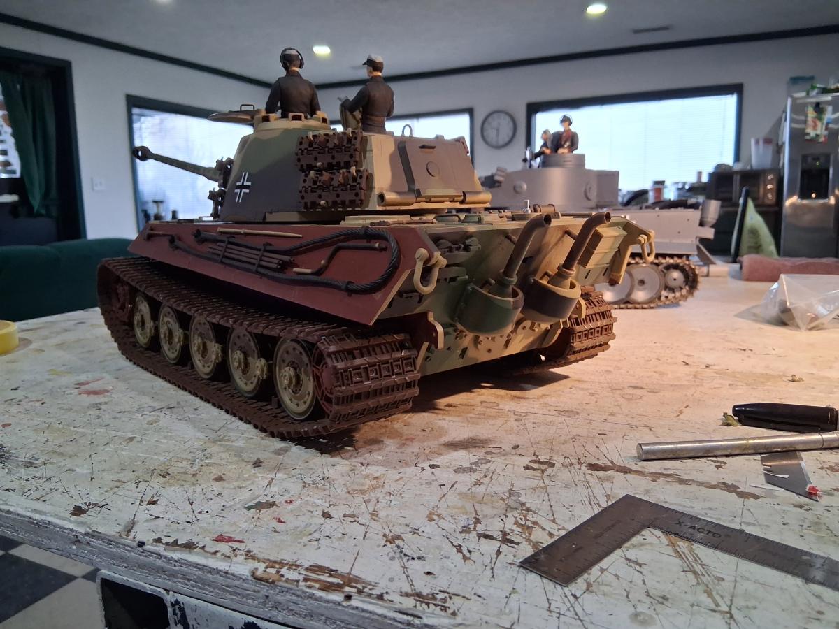

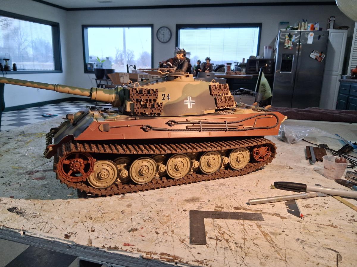

                Well here it is so far. Still getting ideas and trying to decide exactly how i want to finish it,markings colors weathering ect. Having a blast running it some on my tank area. Its a beast in stock configuration
