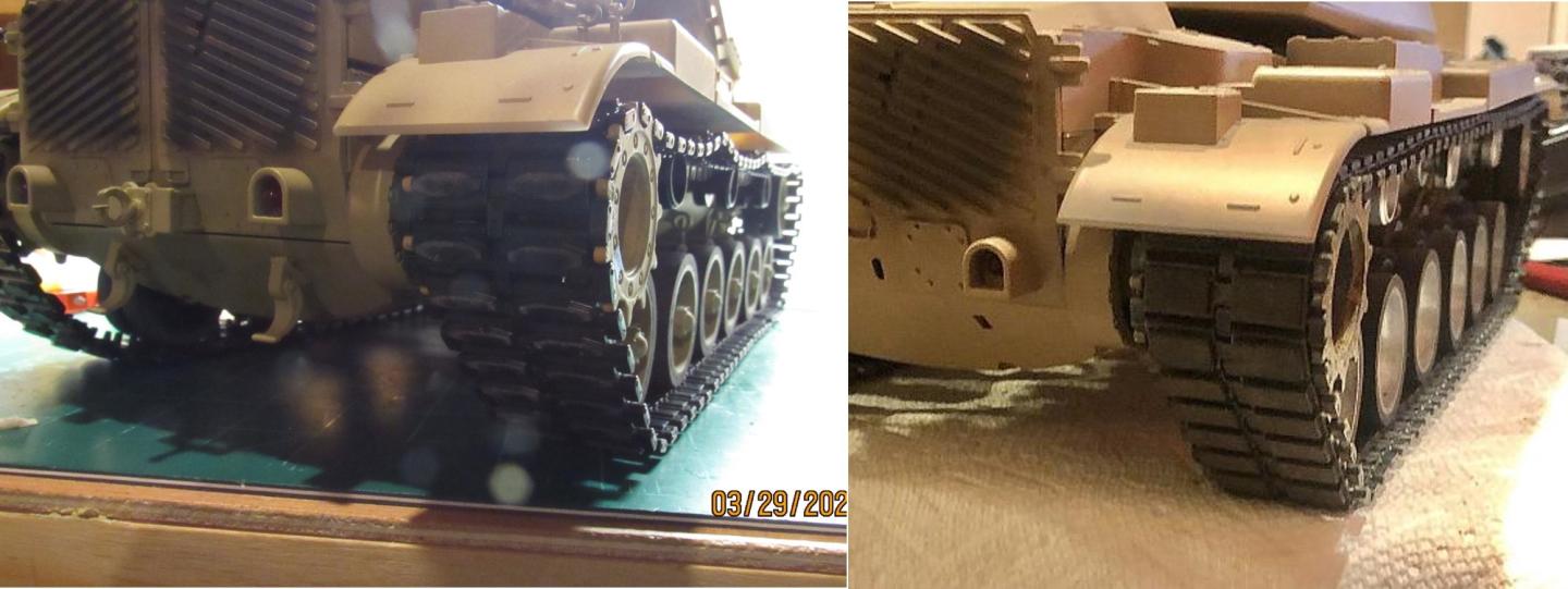

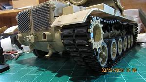

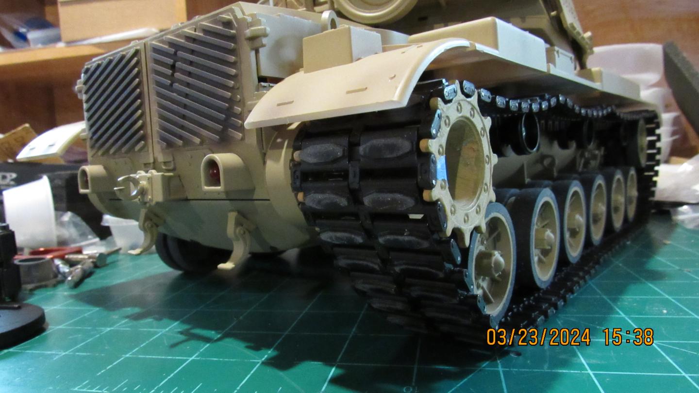

      I like the Tamiya hybrid track the best because it looks realistic in static display and flexes like the real track when running on both rough and smooth surfaces. The very hard rubber pad slides just like metal or plastic track and gives it the weight it needs. (Soft rubber pad is a disaster like RichJohnson describes.) The Tamiya track has the dual pin design to flex properly and has completely closed pins to prevent pre-mature stretching. Not perfect, but better than anything else.
      The Tongde plastic track is indeed a huge improvement over the Henglong version with solid back side and closed pin design. The single pin, light weight Tongde plastic track design is not my favorite. I got a second hand Tongde metal track from a fellow member (against his recommendation) and found it too heavy to run realistically and worse than the TD plastic. The M60A1 is now running on the plastic track.

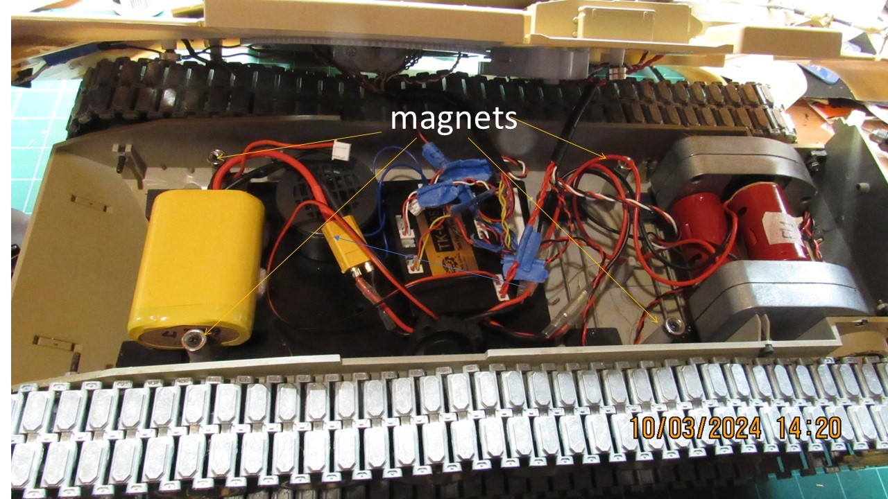

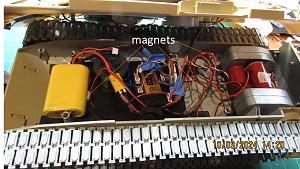

      I have received a plastic PDSGS gearbox last month. I will try it on the M60 with Tamiya track soon. It already has metal road wheels. I will use the HengLong sprocket and idler too.
