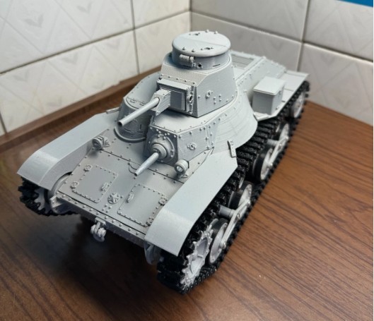

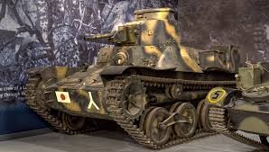

    I have a question about an online seller of 3dP tanks, in China of course. Has anyone tried him out? He's on eBay and elsewhere. I have an inquiry into him, but an independent experience would be great to hear about. He prints a number of tanks, don't know if it's his, licensed, or not. He says that most tanks are HL 7.1 compatible, but that's all the site says. His videos show full function, driving barrel recoil, lights, the works. What does he provide and what needs to be obtained elsewhere. I know there's no electronics, but do they have motors, gearboxes, any hardware?
    I'm fascinated by obscure tanks, those that will never be mass produced. This is one, the Japanese Type 95 Ha Go.

      I have two from said seller. They have changed their name online a few times. Consists of a guy in Canada (or he used to be), but the printing is done in China by his associates. I bought it believing they were authorized copies or their own original design, but that is far from the truth. A lot of them are unauthorized production of other peoples STLs like warprints and the ukranian guy, but they will assure you that isn't the case. The pictures and videos are of the best case scenario/already done but what you receive is gonna be very rough and low quality. I have a Churchill and a Hetzer. I forgot what type of material they use, but they warp in warm weather so I can't say it's PETG or anything like that. Print lines all over the place. Fitment was okay for the most part, and ass in other cases and required some significant smoothing and sanding. They run very rough. Print consistency and shape uniformity was rough so they drive like cars with bad alignment and very crunchy. He advertises these kits with hardware sometimes, but the hardware included doesn't match or make sense at all. The Churchill with its intricate front sprocket was lacking hardware to make it work like pictured so I had to come up with my own hardware and creativity to make it mount and adjust. I probably spent a good $30 on hardware and trial and error. The roadwheels on the Churchill were paper thin and broke under the weight of the tank assembled, as did the suspension arms. Probably the flimsiest 3d print material ever. I had my friend take one set and make beefy reinforced ones and that made it durable enough to use. I don't take this 3d one anywhere but it is all assembled and able to run, but by then, the Tongde came out and I got a battle ready Churchill out of that.
      Also note that he cannot provide instructions because he's not the original maker, so he'll point you to wherever the designer may post their notes, otherwise you have to be good at guessing. The items did arrive and with good communication. When I was missing something he did have his Chinese counterparts print them up and send to me at no charge, but that took a minute. So you will want to get cracking on the project right away or risk missing your window to get any problems sorted out.
      So in summary, to his credit, the sales part is fine. He was reliable and communicative. But the actual product is terrible. Don't buy unless you are willing to make it work and use inferior materials. When I am unburdened by a backlog I may attempt to build that exact model via the 3d files available for purchase just for fun. I can print in way better quality in PETG at home now.

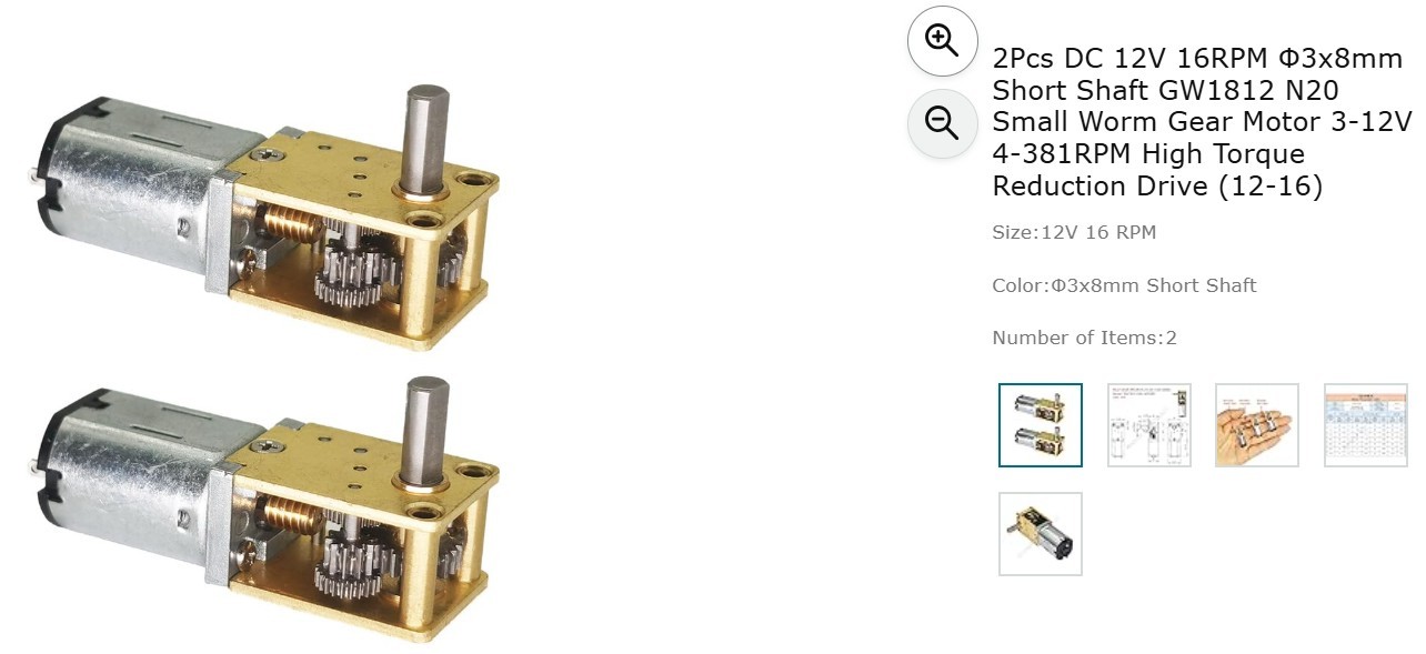

        I wouldn't expect the Ha-Go to be a rugged battler. It would be a fun project though. Given its size, I imagine HL motor/gearboxes would be too large. There is a motor gearbox that others have used for small tanks; N20 is the name I believe. Tang, maybe we can double up and take advantage of each other's expertise!

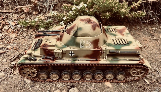

        Here's his turret on a HL Pz IV:

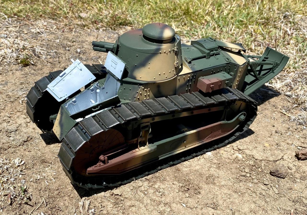

            Here's the motor/gearbox I was thinking of. This one is rated for 12V, but says 3-12V, so 2 cell li-ions should work. $19 for 2 on Amazon. I wish I'd know about these when I made my FT-17. I used the Heng Long 1/24 tank innards, and it made this run at light speed!

                Back to the topic. Inkor is the Ukrainian guy. He is aware and has talked to the guy in Canada and does get kickbacks...sometimes. I'm sure he's not delivering on every sale and Inkor is aware of it also. From what I know of him, most of the tanks are printed in PLA which will deform in the sun and it will degrade over time as it is made from corn to be biodegradable. PETG or ABS has much better heat resistance. Some have said the quality is OK, some say it's crap so it is a crap shoot. It is most definitely true that the guy does not have permission to sell all of what he sells. Warprints has specifically told him his not authorized to sell his stuff. Inkor sells all of his designs on Cults3D where he does get most of the money. Cults3D does take a cut as they are hosting the sale.
                https://cults3d.com/en/users/RC_3D_Tanks/3d-models
                If you click on any of the tanks, there is "Live View" link for the tank. That view contains a deconstructable 3D model of the tank so you can see the inside of the tank. It will show you the motor setup. I can't view it from my work computer. https://rc3dtanks.site/detail.html#ha_go He also has a Discord server where you can ask questions and report bugs under the channel name "RC 3D Tanks".
                The Ha-Go in particular does not use a standard Heng Long gearbox setup as it won't fit in such a small tank. It does use the gears from a Tamiya gearbox which from Inkor's link is the same one I mentioned about using in the FT17. https://www.tamiya.com/english/products/70168/index.html Having my own printer I've never ordered from him so I don't know how much he includes with his kit. The normal Heng Long 7.1 should fit as it does use servos for recoil and elevation.
                Info from Cults3D page:
                Based on Heng Long TK-7.1. Does not support BB unit.
                supported:
                - uses gears from
                Tamiya gearbox
                - canon lifting
                - smoke
                - fully functional suspension
                - recoil and elevation with SG90 servos​
                IMPORTANT!!!
                Tamiya set is the one that I found possible to use. The gearboxes itself are not being used, instead there's a custom made gearbox housing that you have to print and assemble. It also requires printing gear so use nylon or something tolerant to temperature and tension.
