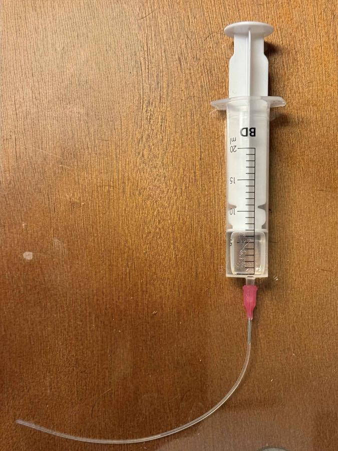

              Smoke Oil: The smoke generators on these I've found to be hit or miss, but if you like seeing the smoke pouring out of these like I do, the Mega-Steam smoke oil seems to be the best thing out there ( Coal Fired Steamer is the one you want ): https://megasteam.com/page5.html
              On the subject of smoke oil, I've tried a few different things to use to add this stuff and have found that needle oil bottles work great: https://www.brownells.com/tools-clea...oiler-bottles/
              - Another method I've started using is utilizes a syringe that has a small diameter flexible tube at the dispensing end, and a plunger that does not contain a rubber stopper. See image below. I get these from work but I think they can be found in a pharmacy.
              - As for the amount to add, generally I generally add about 2-4 ml if using a syringe, or roughly 4-5 drops from a dropper type dispenser
