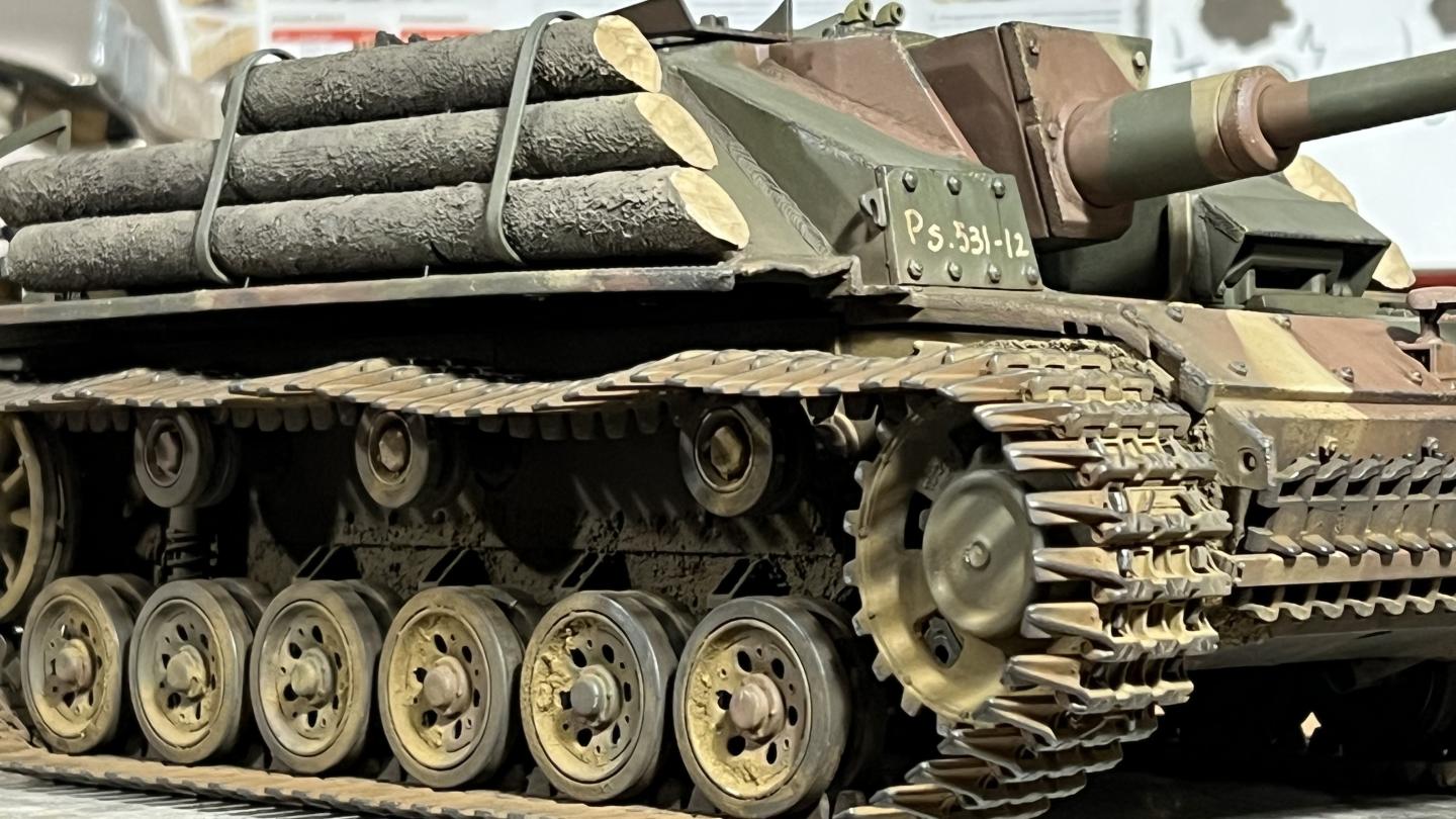

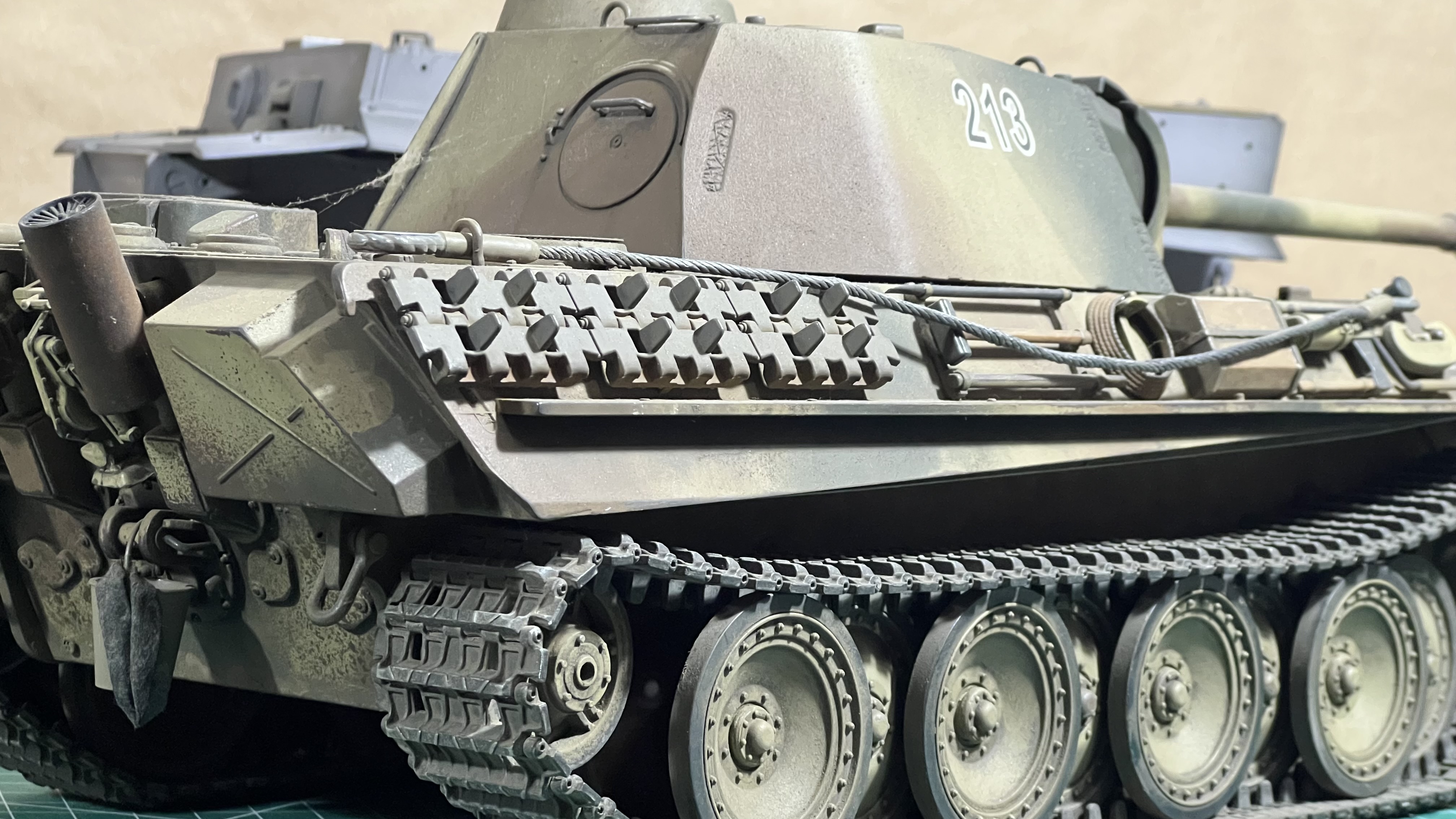

            If you are talking about the white metal tracks, you have a couple of options. You can burnish them using a Cold Gun Bluing solution (actually blackens the metal).This can be left alone or painted over as it acts as a primer for the metal tracks. You can also just paint over them, but a good metal etching primer is the best way to start this after a good full degreasing, then airbrush right over to the color of your choice. If you have plastic tracks you of course can paint them.
            Then you can also weather them with washes and pigments or just run em in the dirty wild till they develop a natural patina.
            This is just gun blue. I used Brownells Oxpho-blue.
            These were primed with Rustoleum Automotive Primer then airbrushed, washes applied and then pigments.
