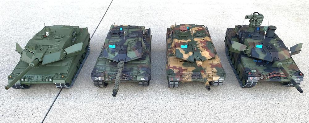

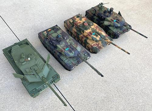

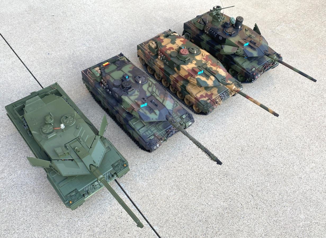

    I have 4 Leopard II tanks in my collection. I don't know what camouflage scheme I should apply on the 4th one (far left). It is a Tamiya. I don't want to mess up. Any recommendation? I don't like white that much. Thx!

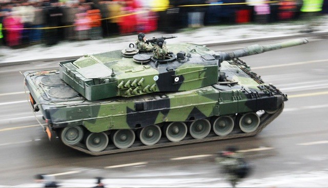

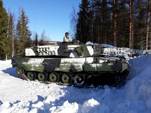

    A couple of Finish Leopard 2. Click image for larger version

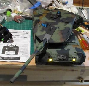

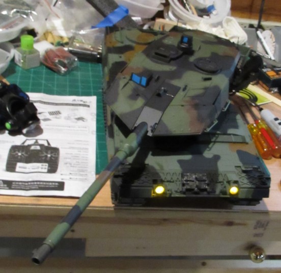

      I painted my Leopard 2A6 by copying the original Heng Long Leopard2A6. You are probably looking for something different.
      I have a working Frankenstein German Leopard 2A6 with Torro metal lower chassis, Torro plastic upper chassis and Heng Long turret with servo mechanism. I used a Valejo WWIII NATO Armour & Infantry color set, but concern that the 17ml bottles are too little for multiple coatings of a 1/16 scale tank. I decided to use 2 spray cans for supplement. I used Krylon Colormaxx Italian Olive which is a perfect match for the NATO green. I cannot see any difference in shade when I used the Valejo NATO green for patch up correction. The Krylon matte black is too black because NATO black is a black grey. I hand painted the NATO brown using Valejo because the area is small. Now I get a Frankenstein painting too. The HL NATO camouflage on the turret is not accurate. The same paint on the plastic upper chassis and metallic lower chassis have slightly different shade too. After 2 layers of dull coat, they look good enough and I call it done. ​
      I use the HL chassis as my painting guide. Instead of playdough, I used caulking cord for soft edge marking.
      Click image for larger version  Name:	IMG_5500.jpg Views:	0 Size:	153.0 KB ID:	424065 Click image for larger version  Name:	IMG_5501.jpg Views:	0 Size:	144.8 KB ID:	424064 Click image for larger version  Name:	IMG_5502.jpg Views:	0 Size:	150.2 KB ID:	424062 Click image for larger version  Name:	IMG_5503.jpg Views:	0 Size:	154.7 KB ID:	424063
      I did not get a soft edge in the new NATO camo. I believe mostly because the spray paint can comes out too hard. I will need to go back to airbrush to get the soft edge effect.​

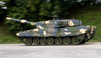

        Greek:
        Hungarian:

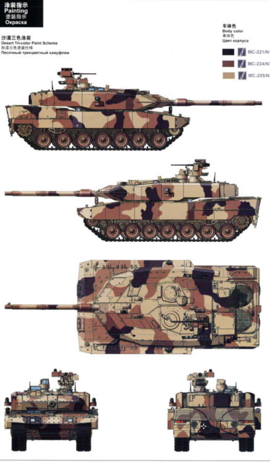

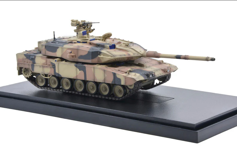

          From some suggestions, I like this one. Is it also the Greek's version?

            David. Have you looked on the Leopard Club Site.
            I think the scheme you posted might be Chilean. It is mainly aimed at 1/35 models, but some of the pictures in spotlight can be useful.

              The picture says "desert - tri-color paint scheme". I do not know Chile has so much desert. The paint scheme does look very good. A nice change from the NATO tri-color.
              However, the Chilean Army does not operate the Leopard 2A6. Chile operates the Leopard 2A4CHL, a specialized variant of the Leopard 2A4​. Not sure how much mod it takes to convert the 2A6 Tamiya to a 2A4CHL.

                    I only said it “might” be Chilean, looking at some of their camouflage schemes. It has been reported that Germany was to have sold some surplus 2A6 to Chile.
                    The scheme sown is possibly a “what if” scheme in development, as it is very ambiguous.

                      A bit more delving. This looks to be a factory paint job, offered by Krauss-Maffei, as an off the shelf camouflage scheme for prospective desert users. A bit like the 3 tone camouflage. Computer sprayed, so all would look the same. I will try to confirm this.
                      If you like this camouflage pattern, just do it. You now have a back story.
