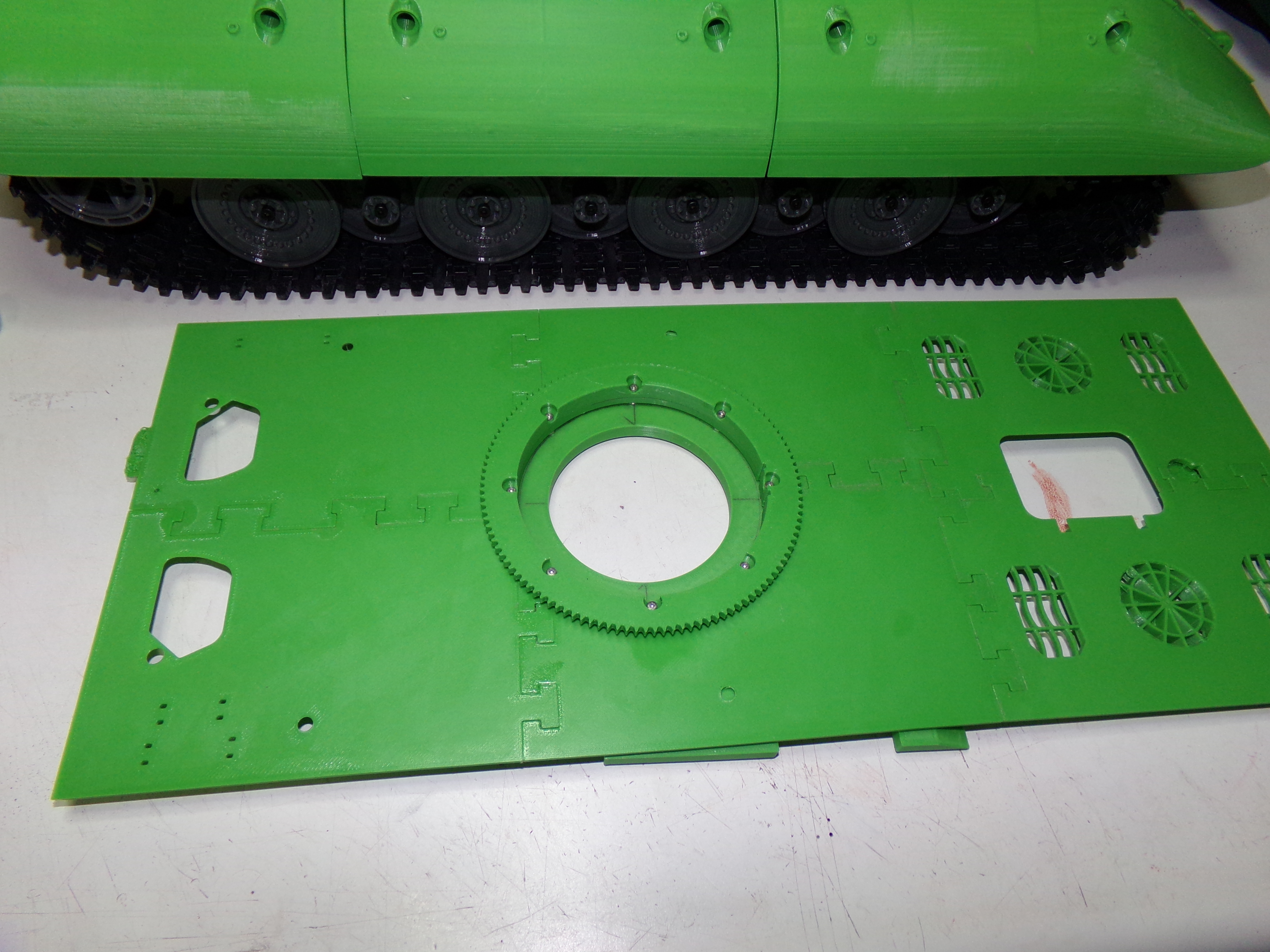

Since the turret ring was different between the two models, I then had to modify the files from both designers. I virtually cut the turret ring off of the Austirian Art E100, filled the hole in the turret base, added a resized hole, and cut the turret ring interface from the Inkor Maus turret. The E100 turret is large and I didn't want it balanced on that center hole so I printed a "bullet catch ring" for the turret to sit on (very right hand build plate). I also had to separate the gun mantlet and pivot point while also cutting holes in the parts to make them functional.

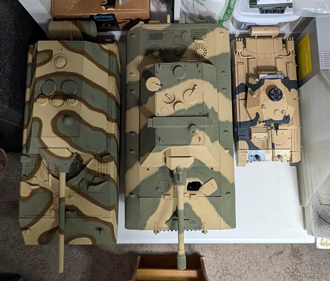

You can see just how massive the E100 is when you compare the turret to an M60 turret:

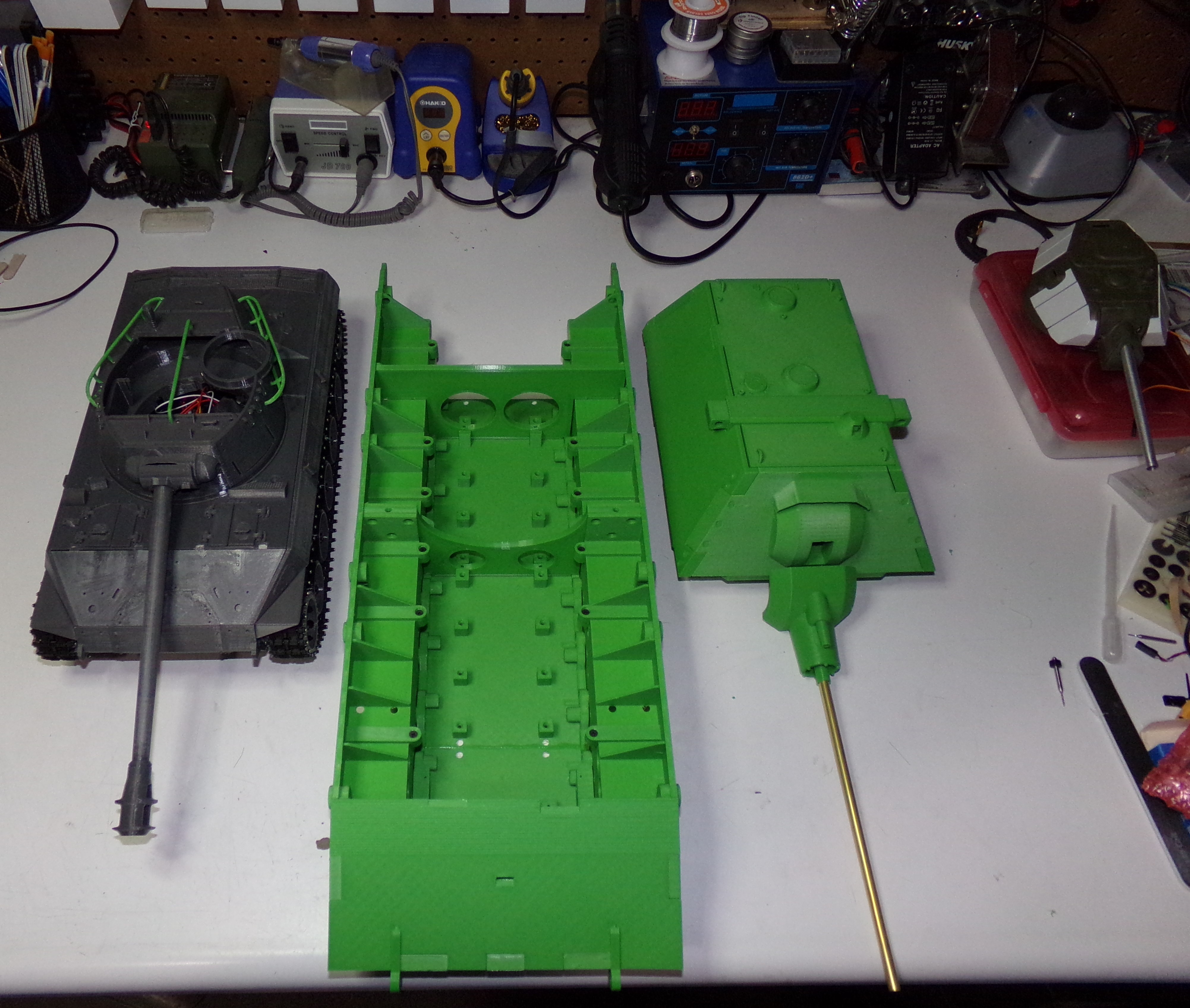

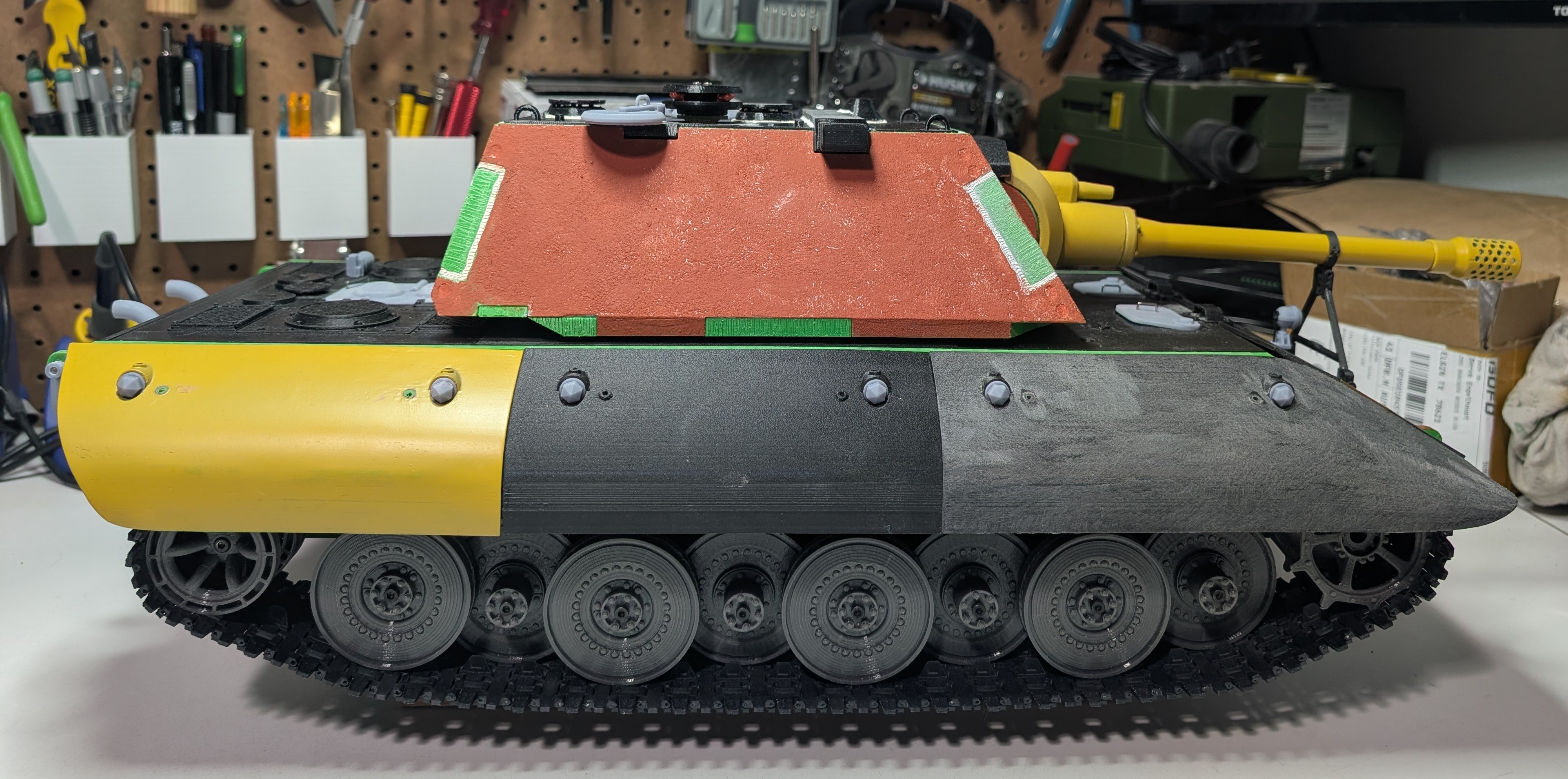

I pulled the Hellcat out and measured it against the size of the E100. My ADHD kicked in during the initial build of the E100 which resulted in the Hellcat getting far more finished than the E100 even though I started the E100 first.

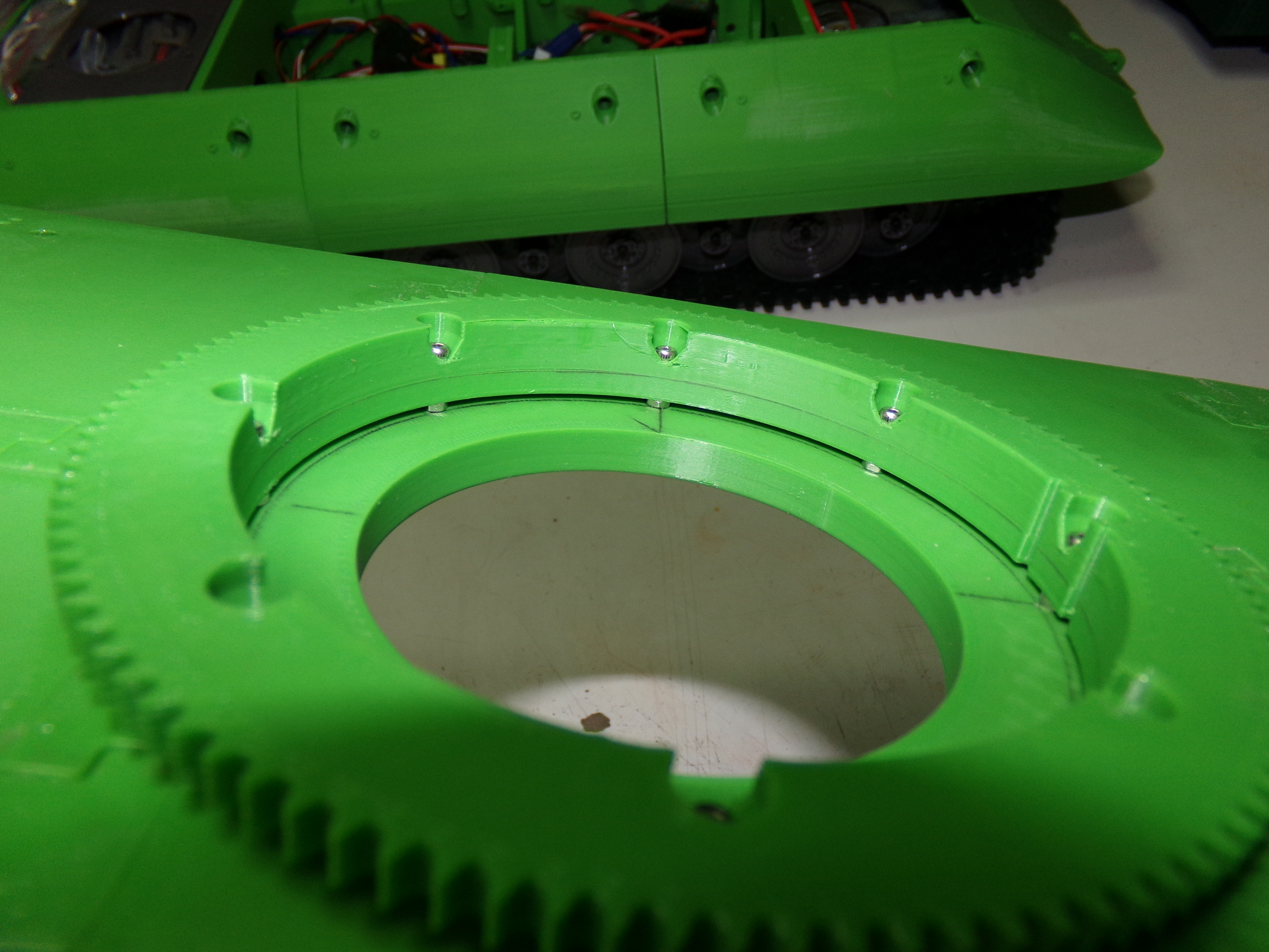

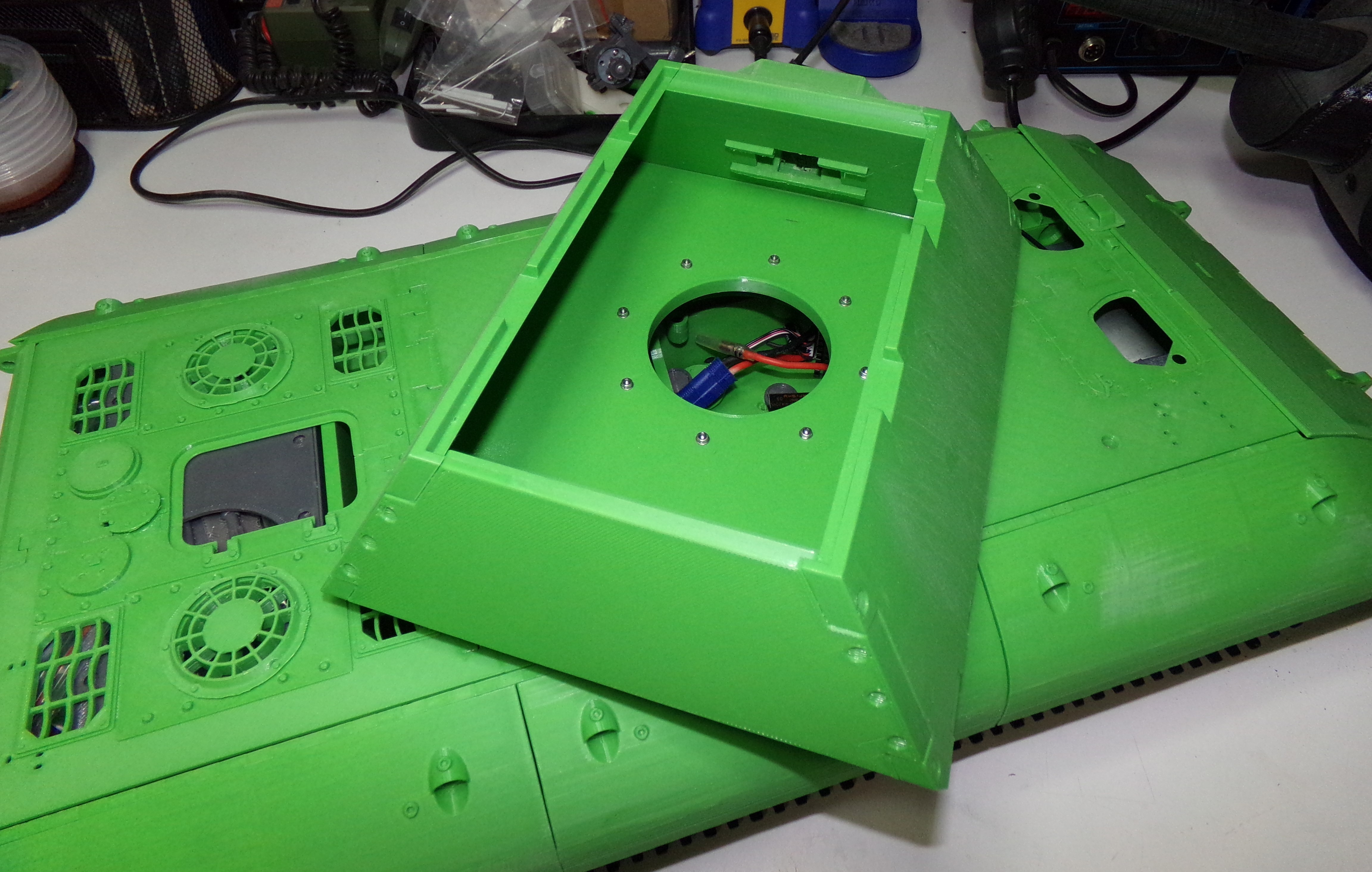

I was able to fit the Krupp turret base to Inkor's E100 successfully. I needed to use some M2 screws for attachment and some M2 nuts between the ring and base of the turret to get the correct height of the turret.

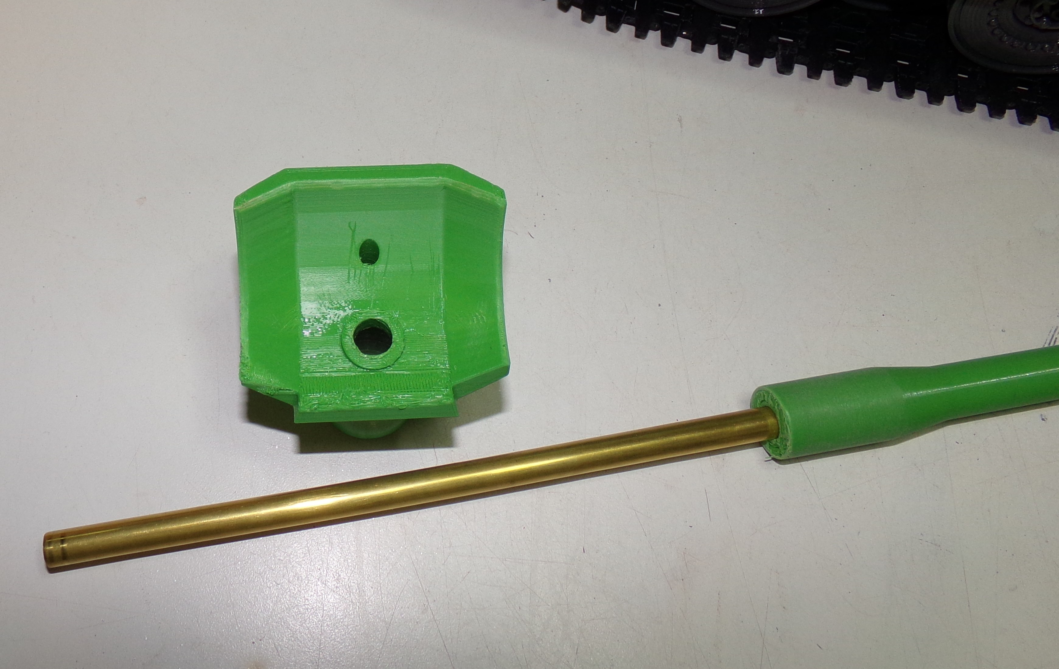

The barrel was printed and it so happened that a 9mm brass rod fit perfectly as an extension into the turret for the recoil servo connecton. You can also see the modified mantlet now ready for recoil.
