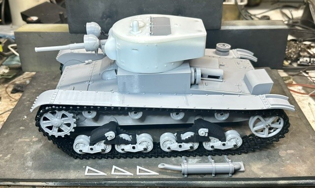

    This is a first look only of a T-26 Soviet Light Tank I ordered from a seller in China. It's a 3D print, one of a collection on eBay and elsewhere. At $285 including shipping, it was a gamble. One sends the money and waits two months for it to be built. This gamble seems to have paid off, but it remains to be seen. Some small parts had broken off in transit, and the barrel had to be glued back together, But overall it was very securely padded and packed.
    I haven't started it up yet, just looked it over. It comes completely assembled. A HL 7.1 MFU is installed inside, and a HL 7.1 controller is included, the one with the adjustable right hand trim tab. Batteries are already in the controller and the tank.

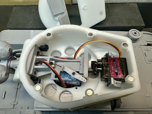

    The two headlights in front are wired with LED's. Elevation is servo operated, the gun has servo actuated recoil, and a muzzle flash LED is in the barrel. Click image for larger version

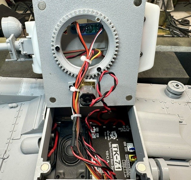

    The turret traverse is operated by a small (N10?) motor and gear train running a ring gear. The turret top is magnetically attached, and the top deck with the turret is magnetically connected to the hull. The tracks appear to be HL Panzer 3 or 4 plastic type.

    The wiring appears to be cleanly done. A speaker is inside. I'm told there is a smoke system too, but I haven't gotten in that far.

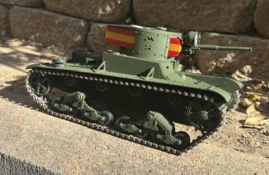

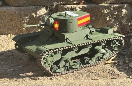

          Progress: painted, waiting on weathering, detailing. Spanish Civil War Nationalist markings.
