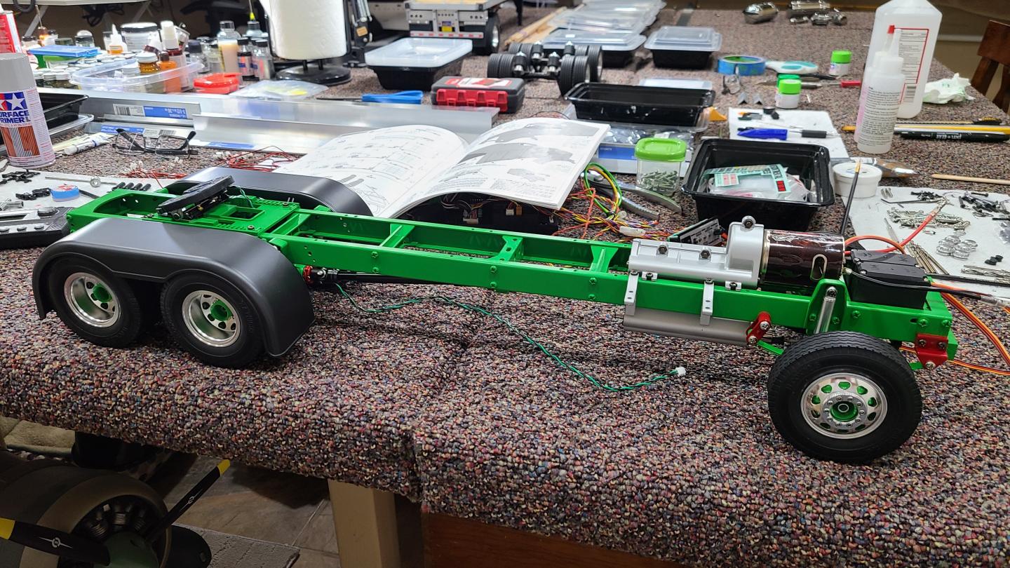

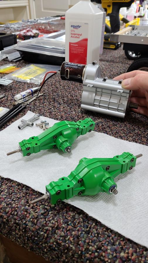

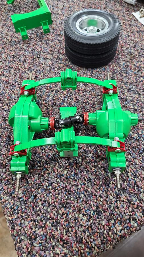

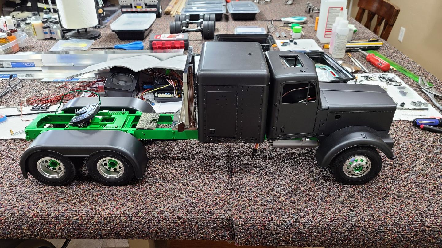

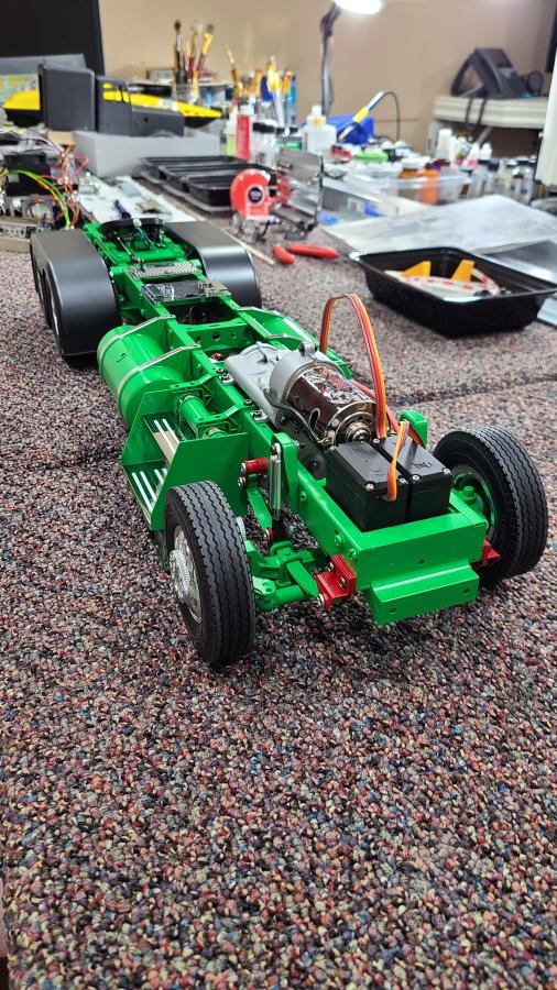

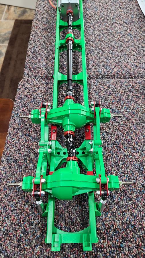

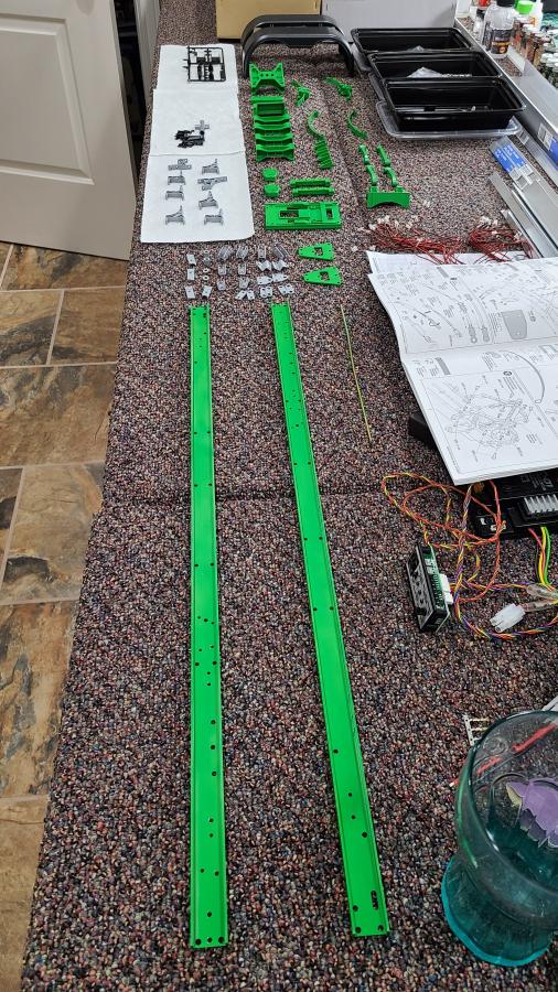

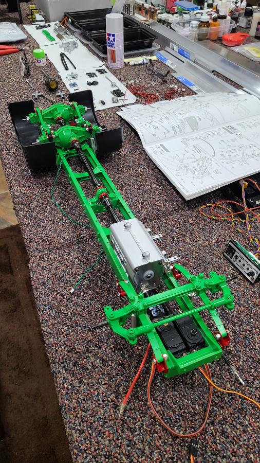

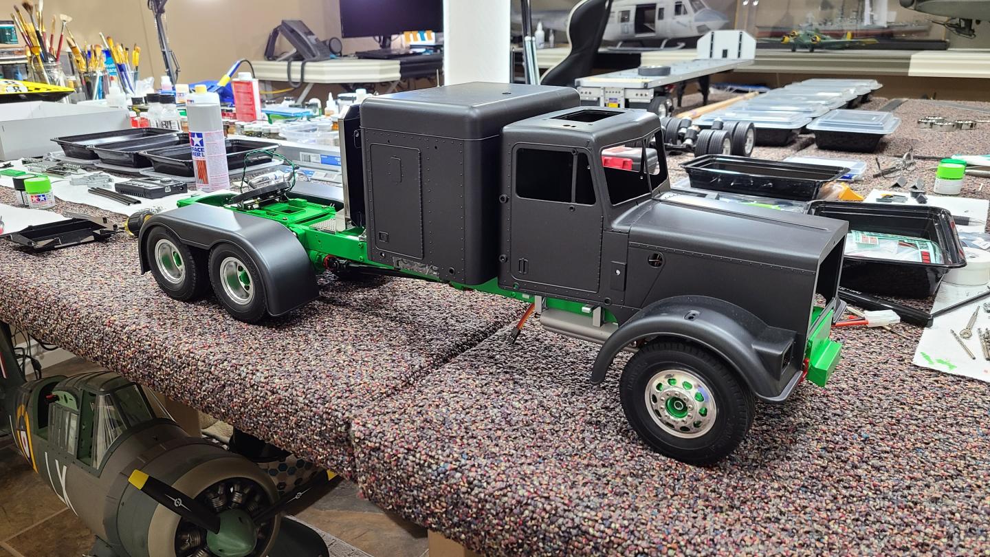

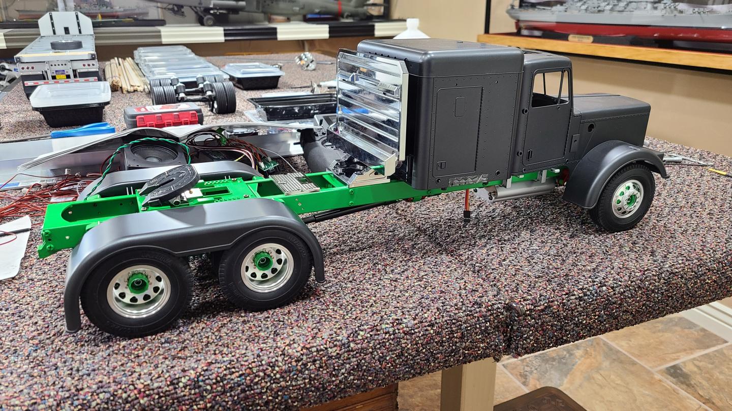

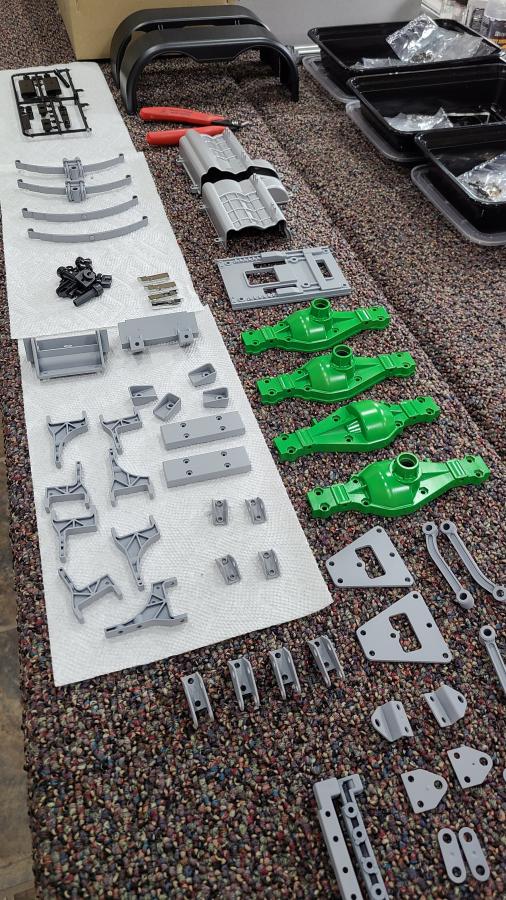

    Well, I have wanted to build one of these bad boys for at least the past 10 years so here we go!

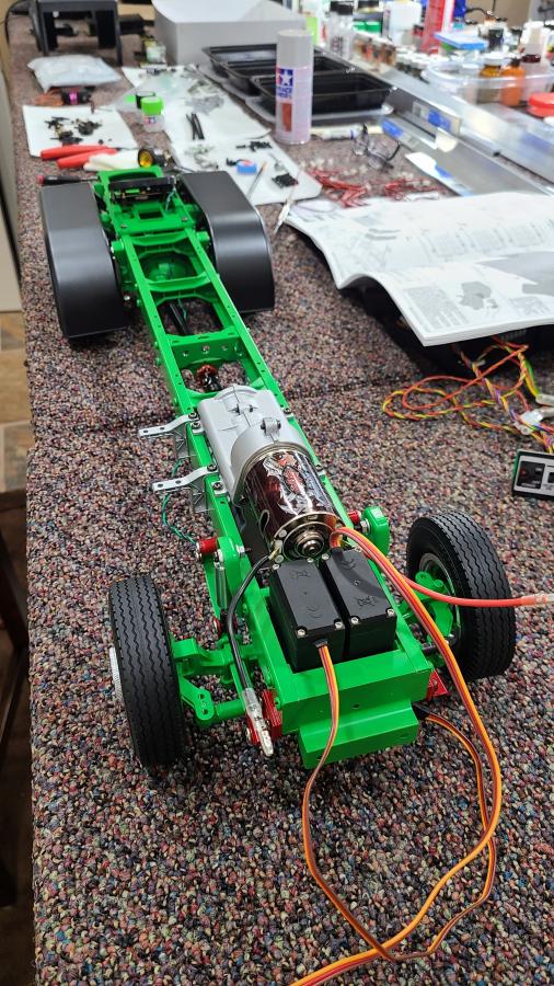

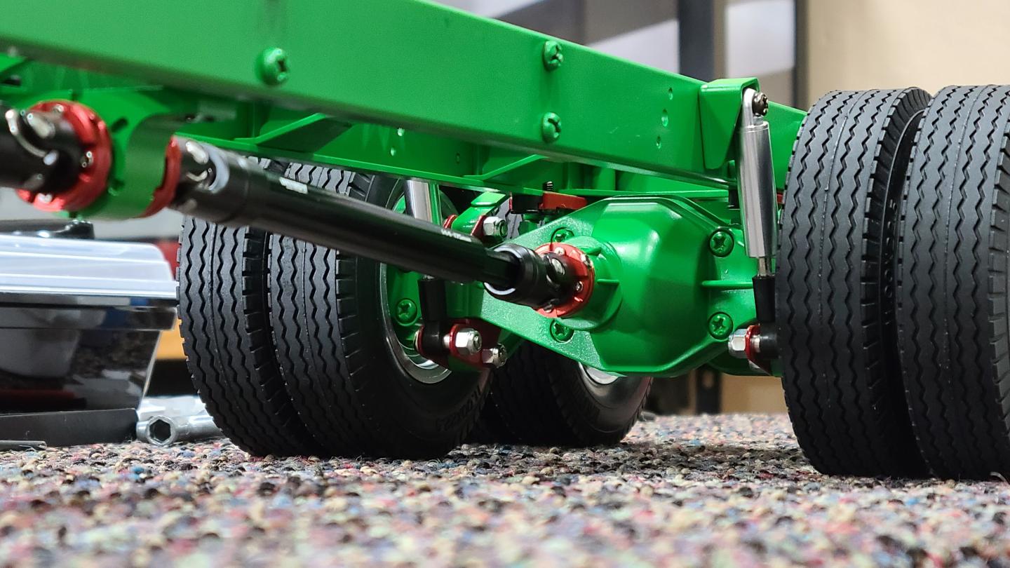

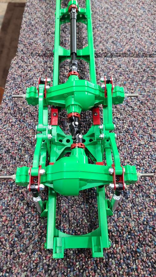

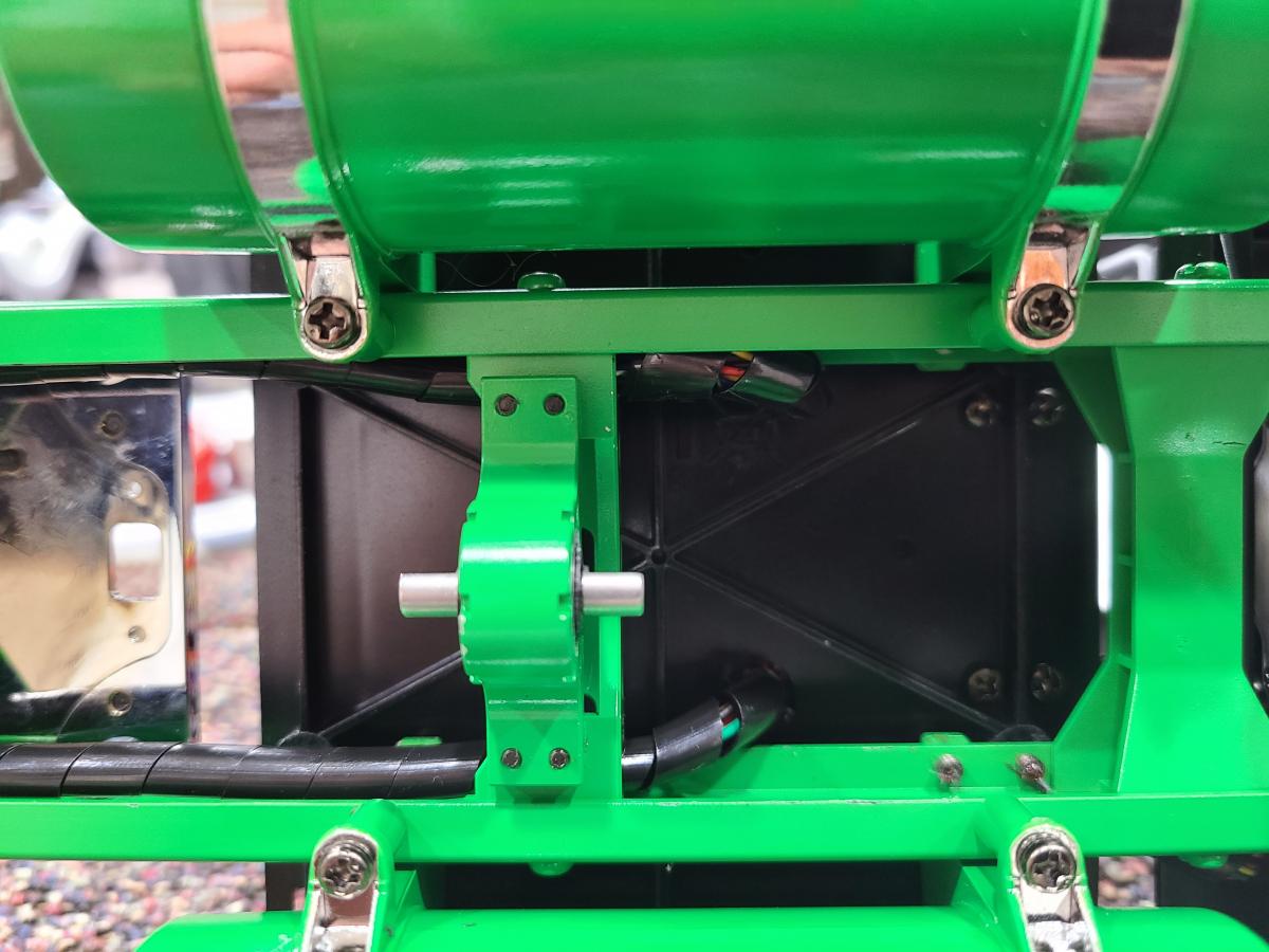

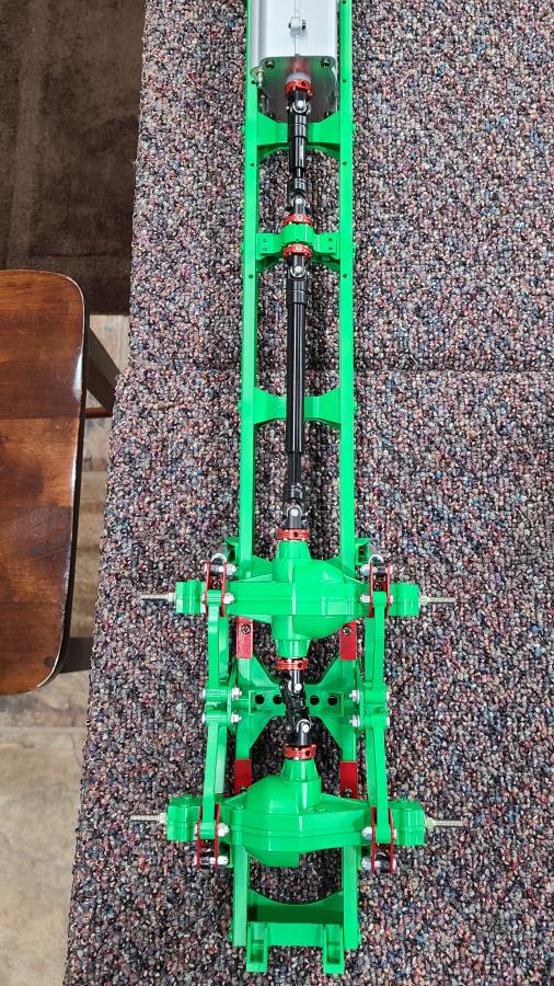

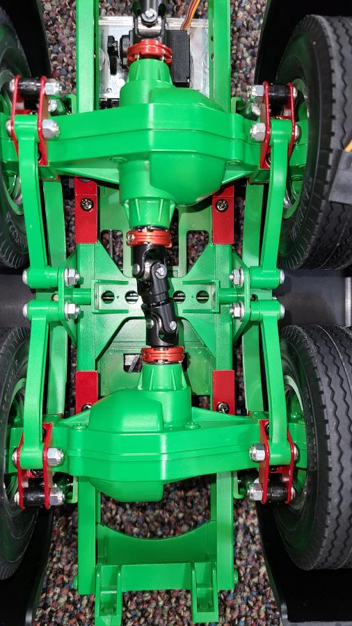

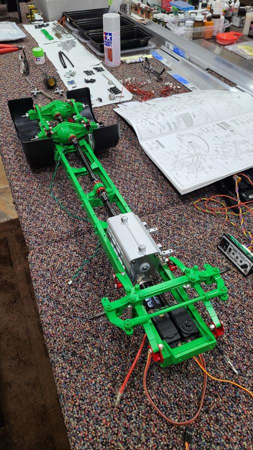

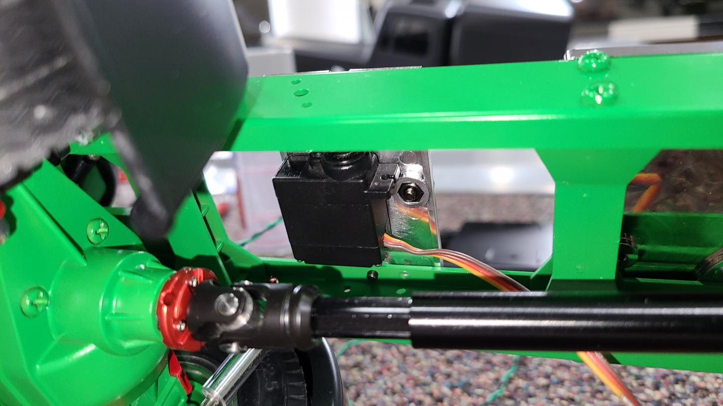

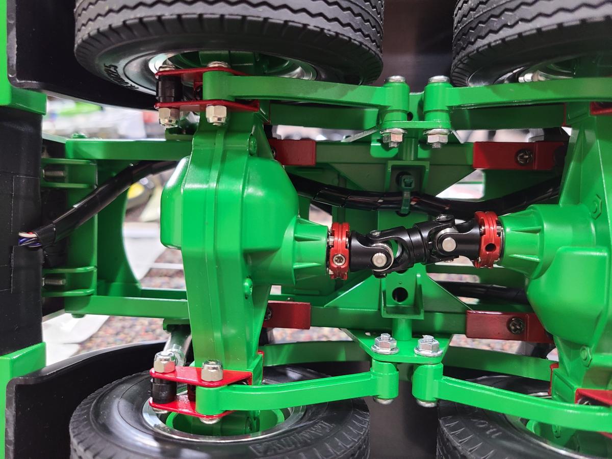

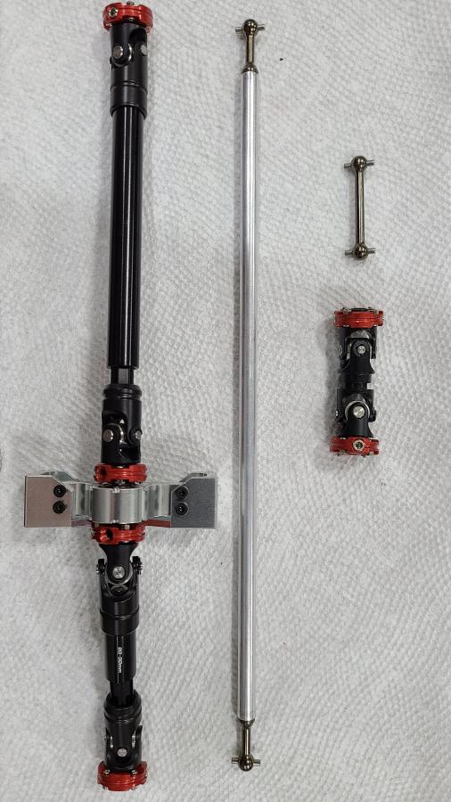

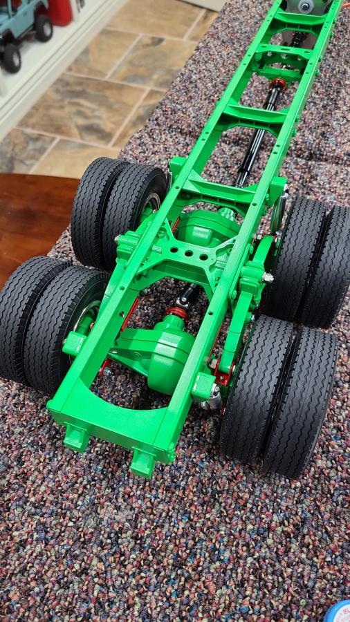

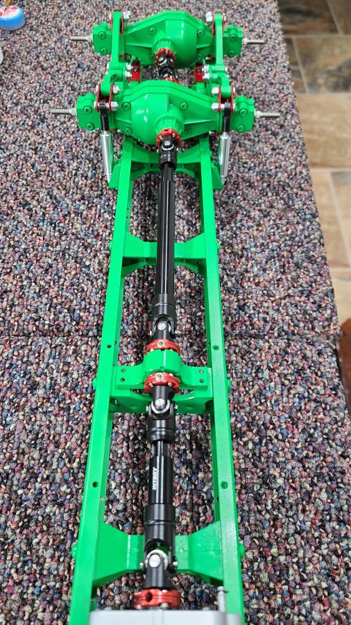

    Drive shaft upgrade.
    • #3
      Feel free to ask questions. This is my my build so learning myself about these amazing trucks.

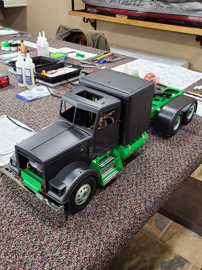

      • #4
        More pics as I move slowly along.

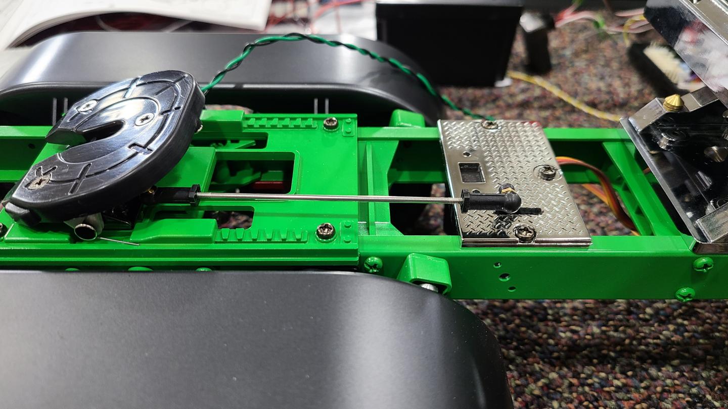

        • #5

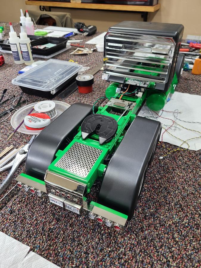

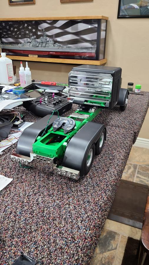

          More pics. Made my own custom release for the hitch.

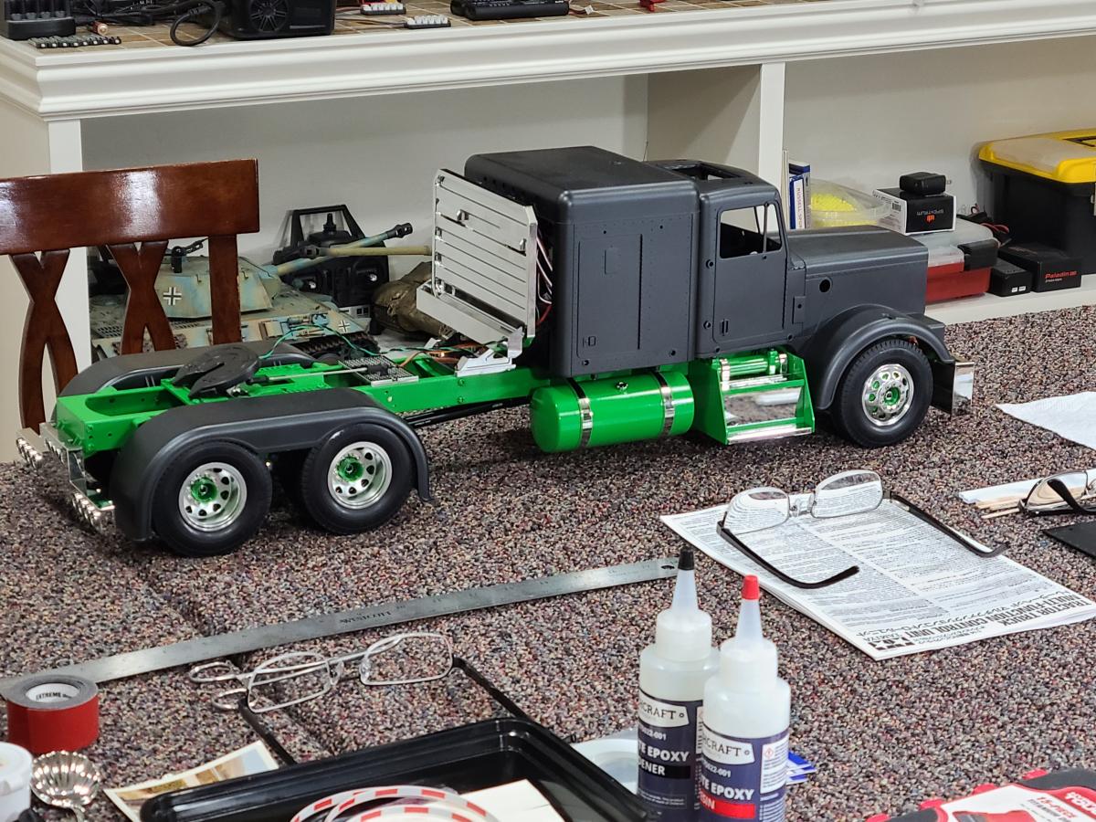

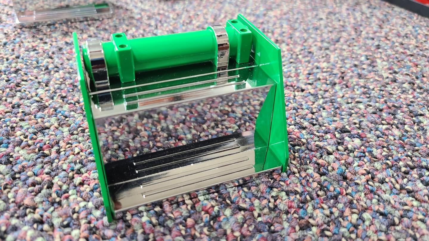

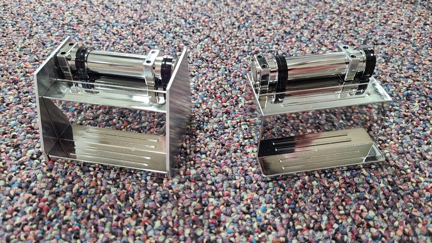

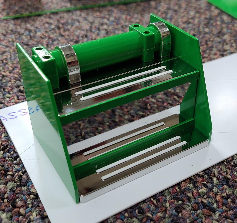

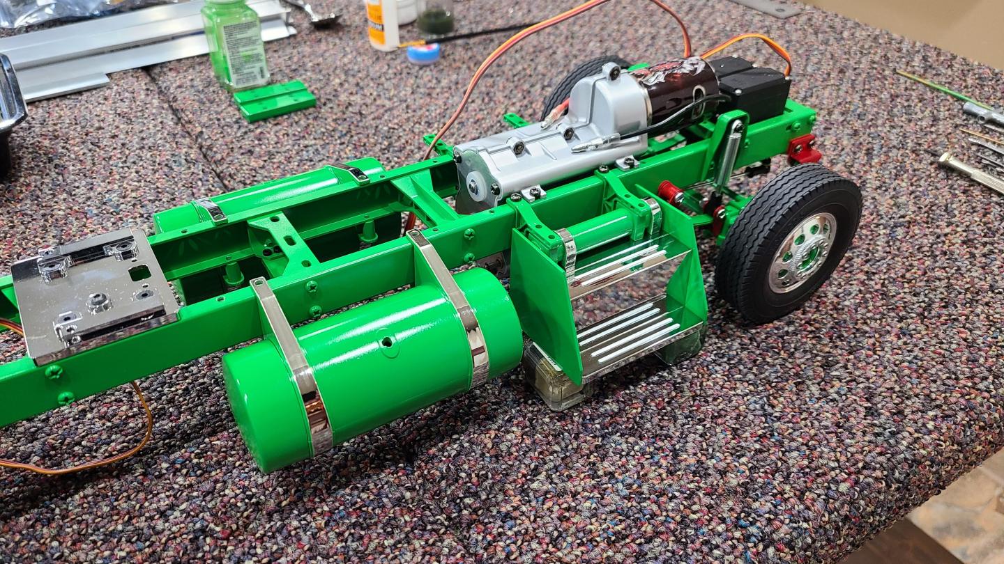

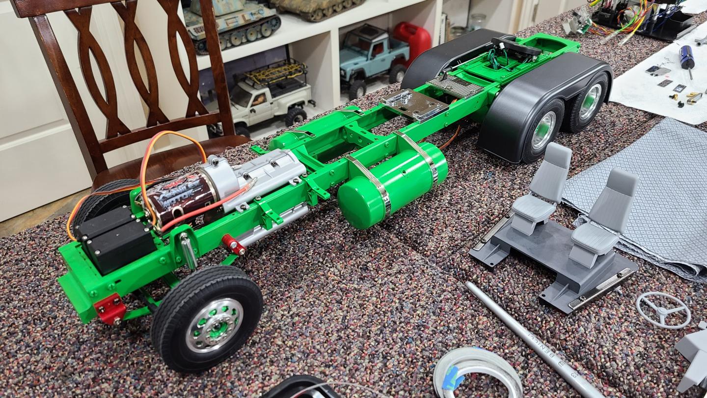

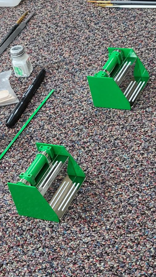

            Battery boxes slash steps.
            • #7

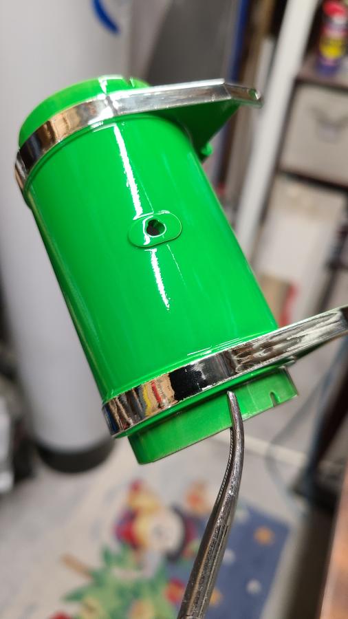

              Fuel tanks.
              • #8

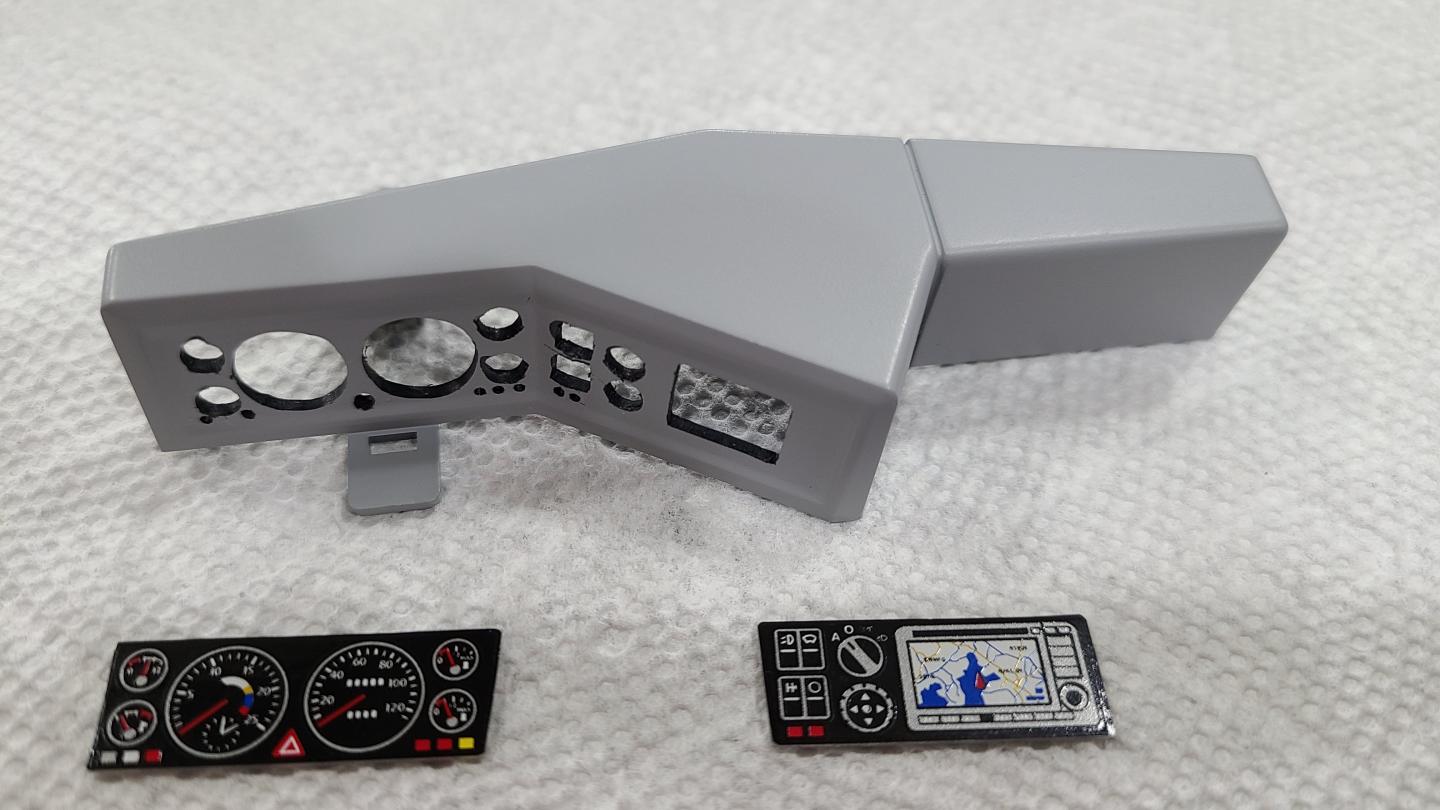

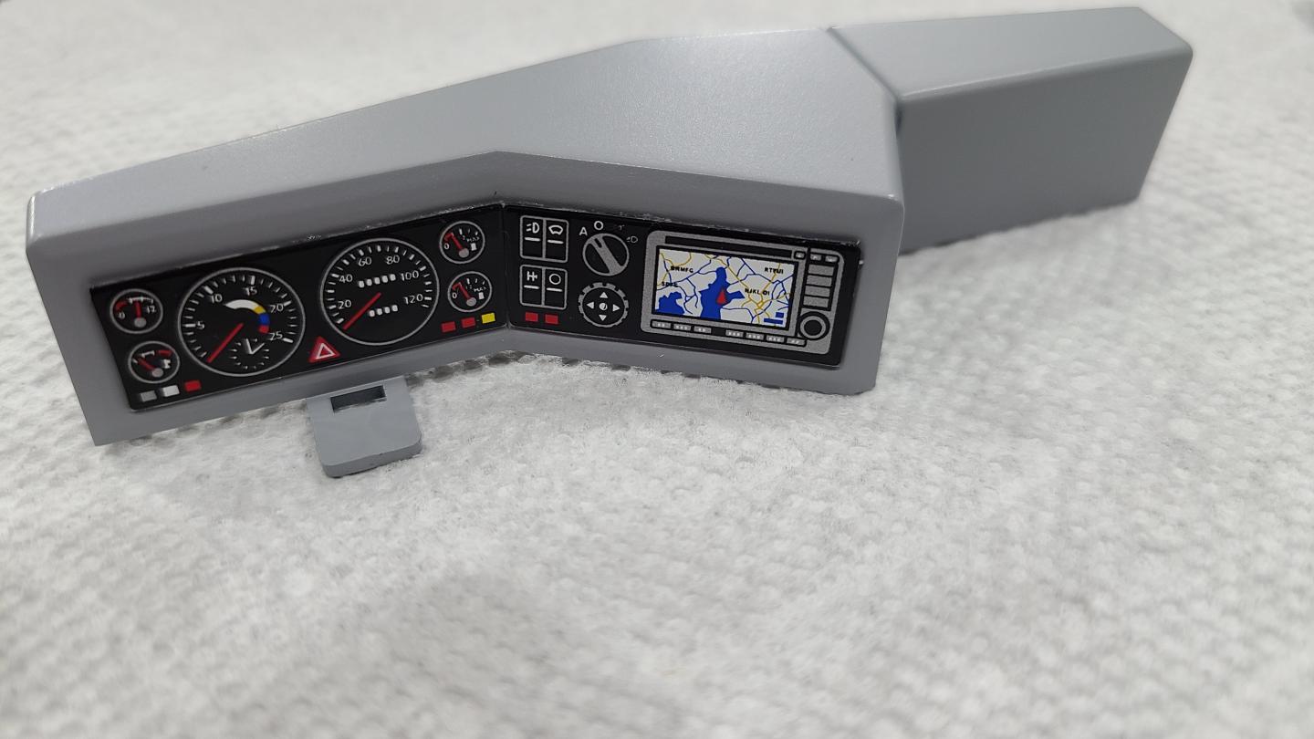

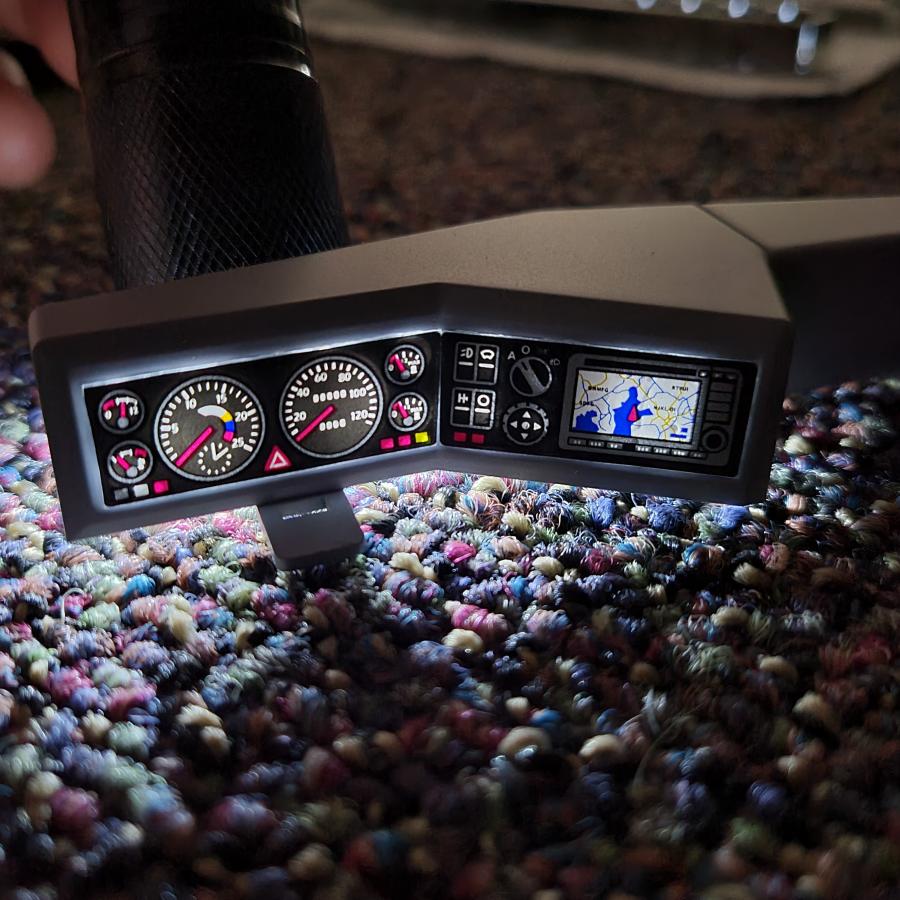

                Working on lighting the dash.
                • #9

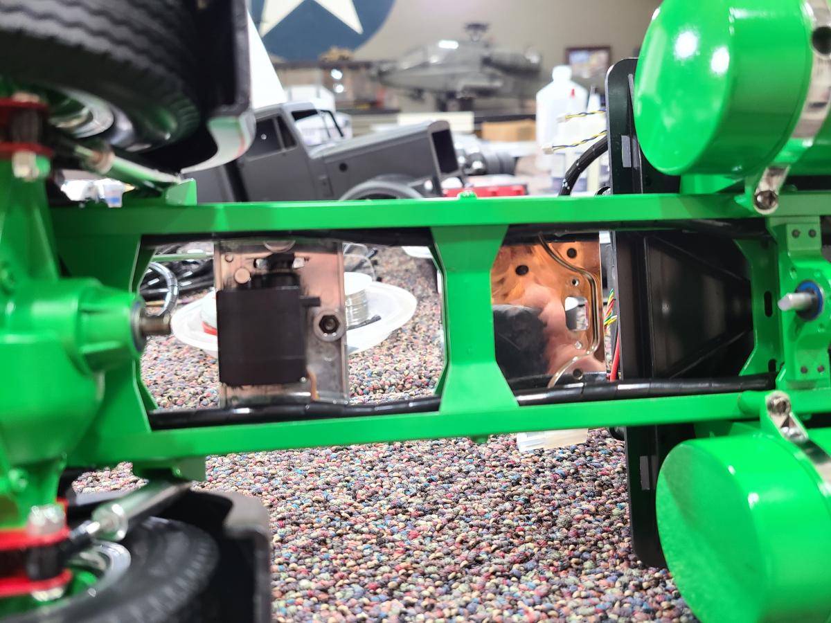

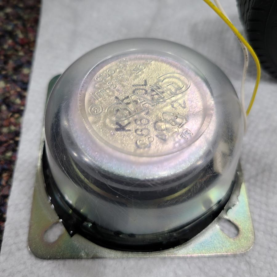

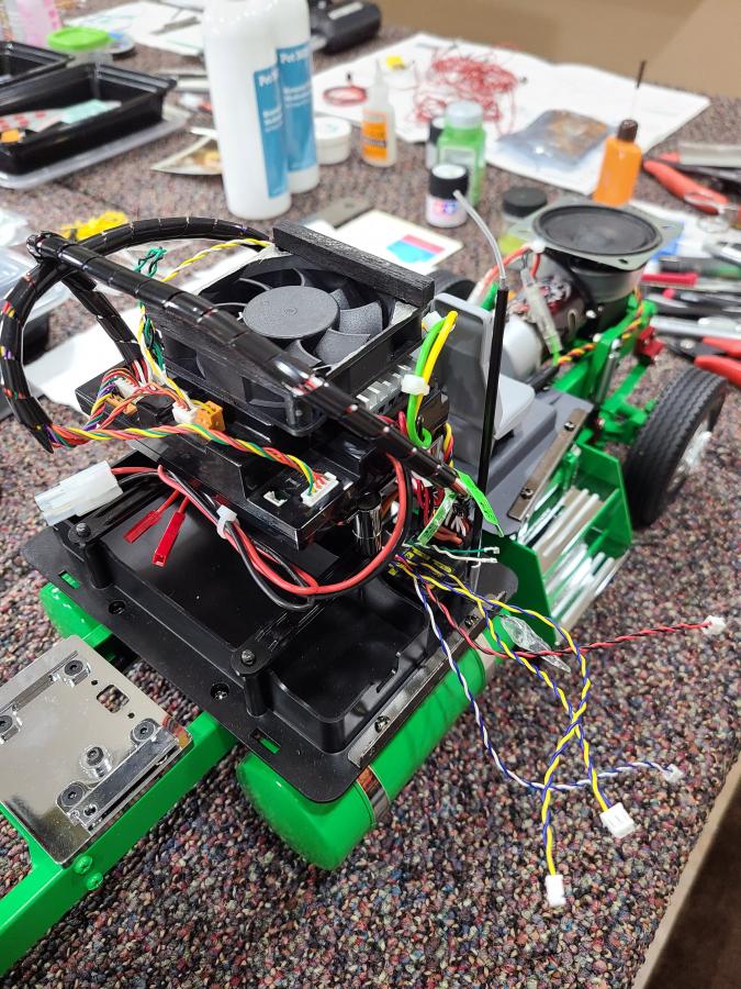

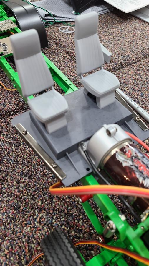

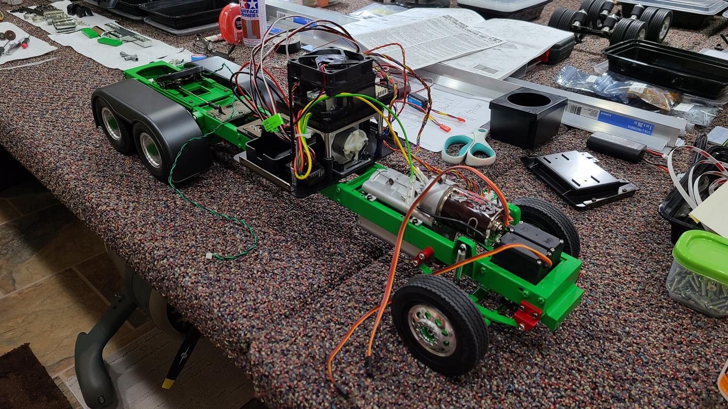

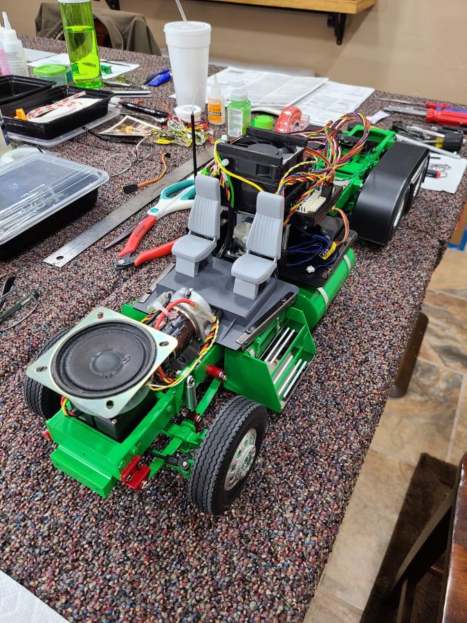

                  Moved the speaker to the front of the truck so I can do the interior. Used a small Glad container cut down to fit over the speaker. Held by some tape then glued on with foamtac. Double faced taped it to the servos for mounting.

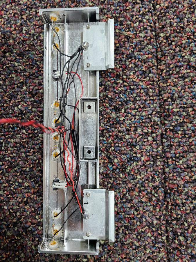

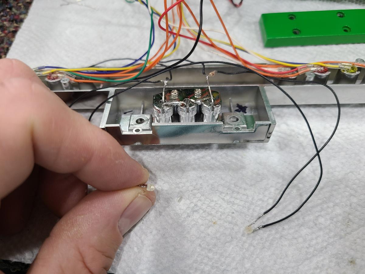

                    • #11

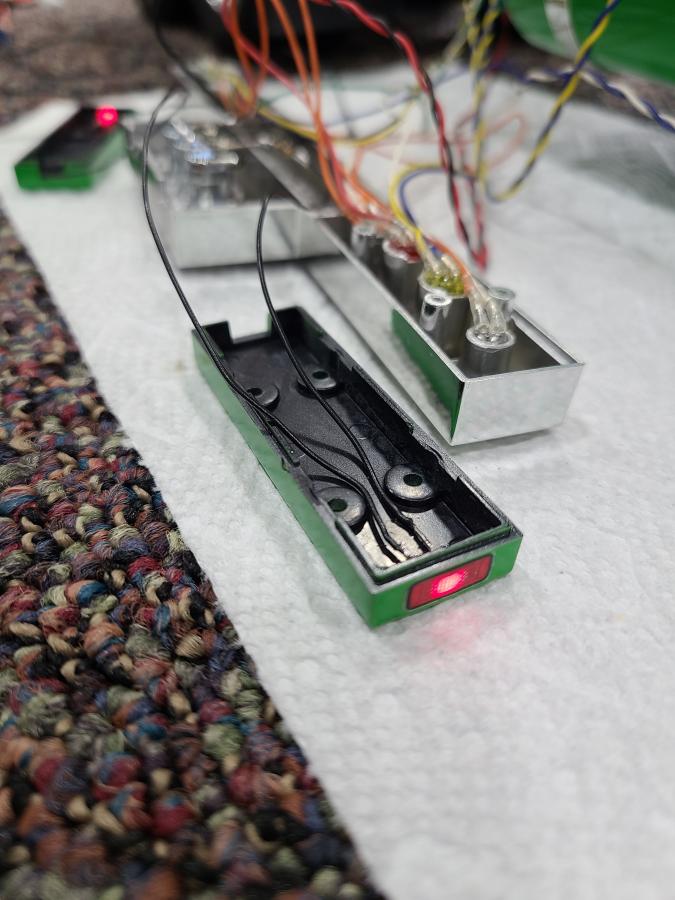

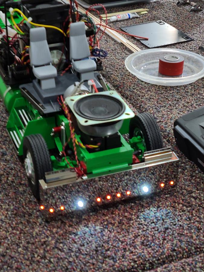

                      Rear bumper lighting. I added two extra small LED's for the side markers. These will work off a second switch. I also found their stock running lights to be too bright. I used a resistor to dim them down a bit.

                        • #13

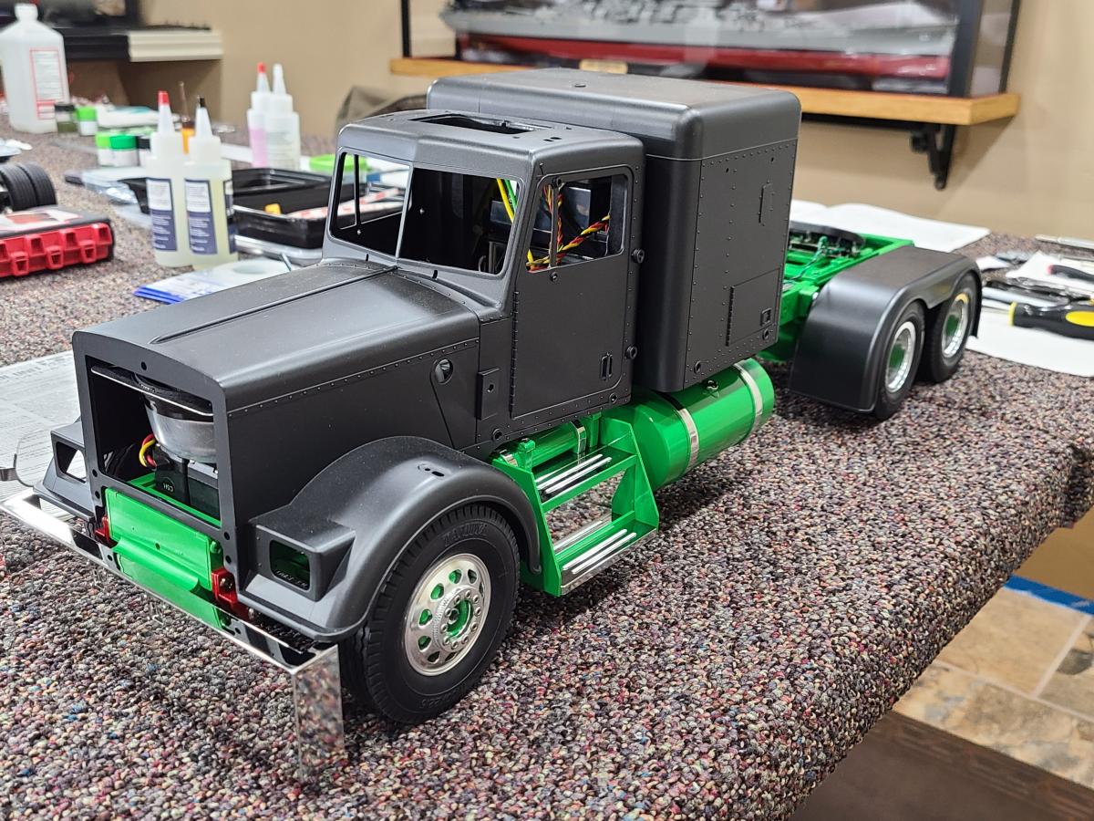

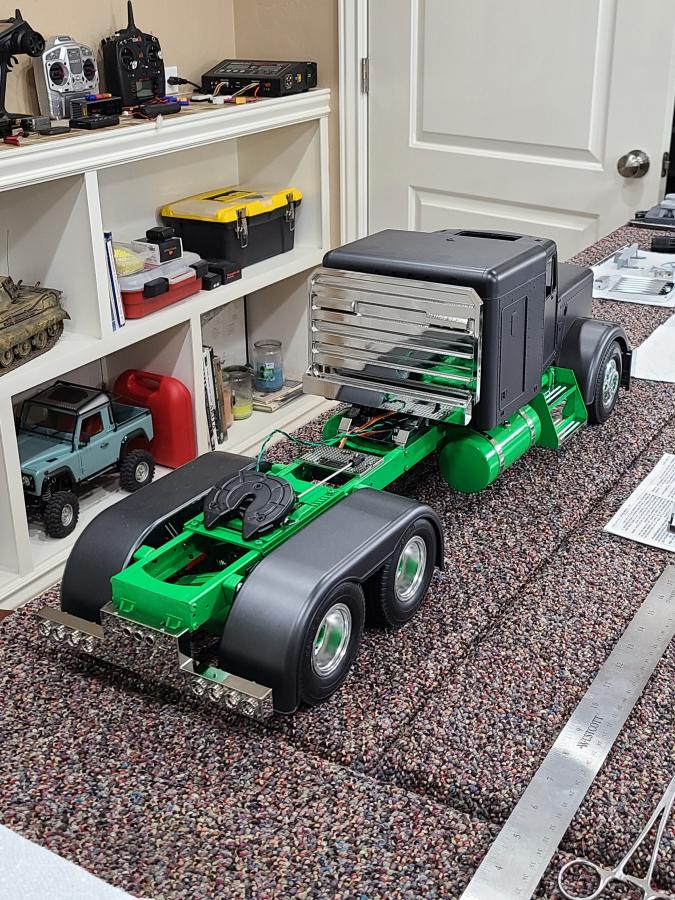

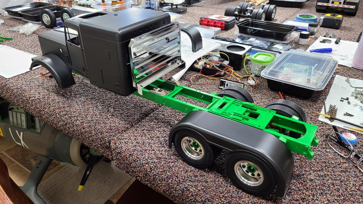

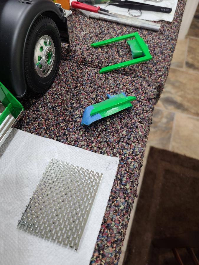

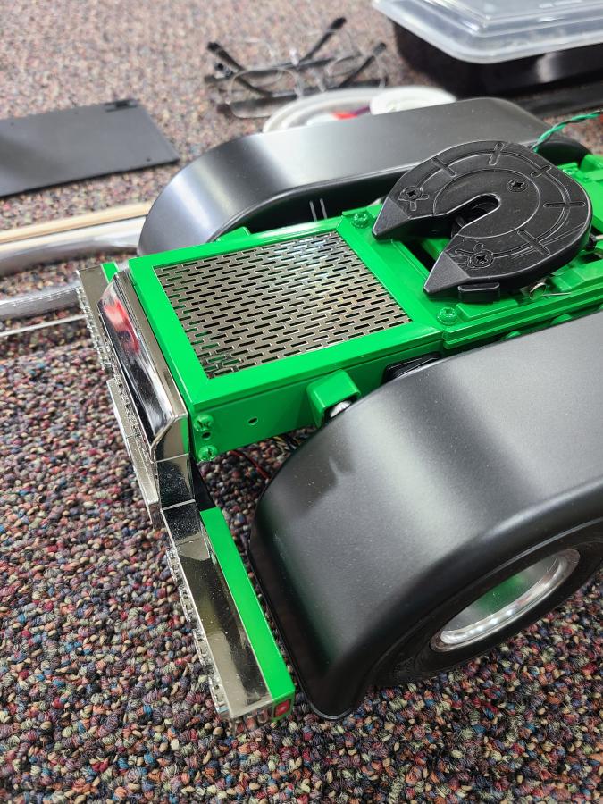

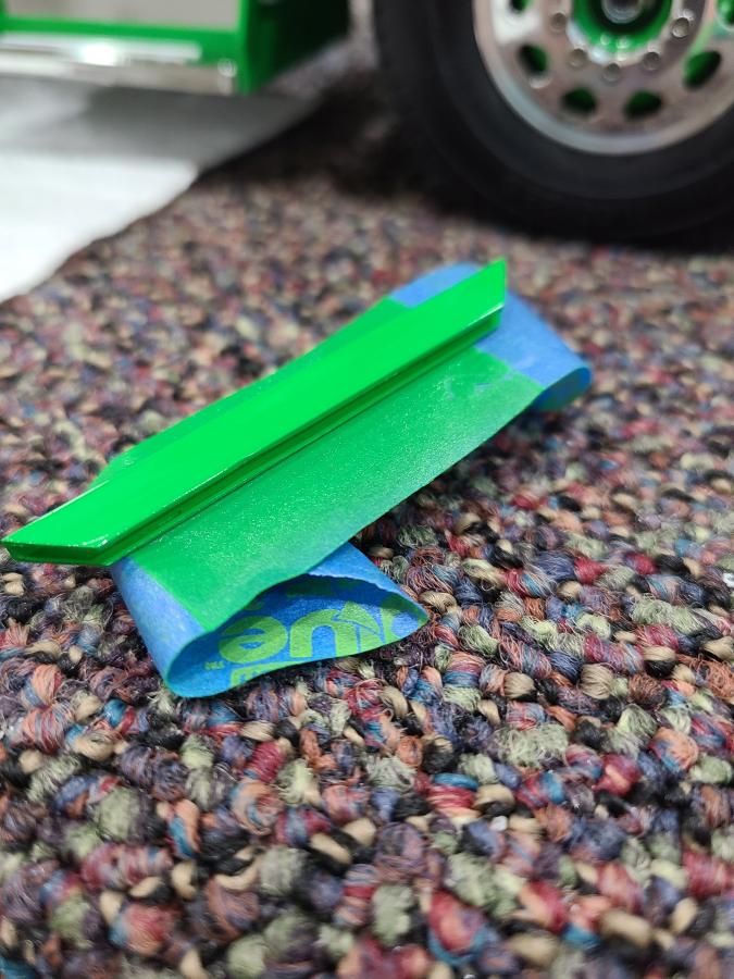

                          I had some plastic rectangular tubes sitting around. So cut one side open to make it a C channel, painted it green. Then made a box around what use to be the plastic chrome grill of the truck and made a cover for the rear over the frame rails.

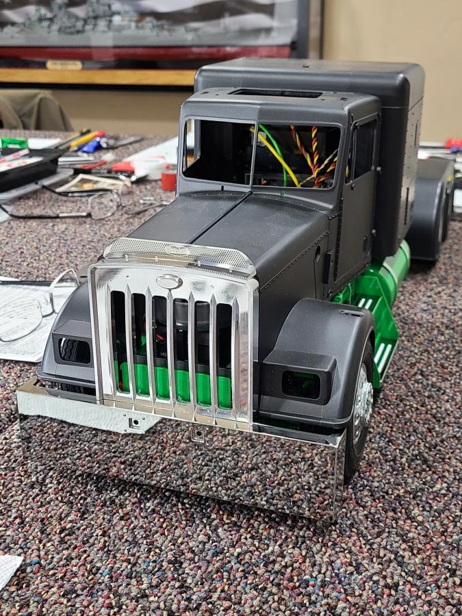

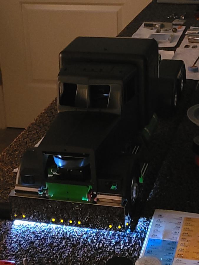

                            Going to add lighting to the stock front bumper.
                            • #15

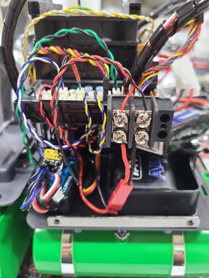

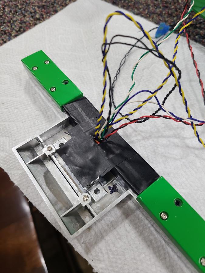

                              Here is the wires ran from the back bumper up to the cab in wire loom.
                              • #16
                                This is where I will attach any other lights I am using that is hooked up to my power switch. https://www.motionrc.com/products/gt...ch-gtpelswitch
                                • #17
                                  Here is the lighted front bumper with fog lights. https://www.youtube.com/watch?v=xjlLYUQw74g

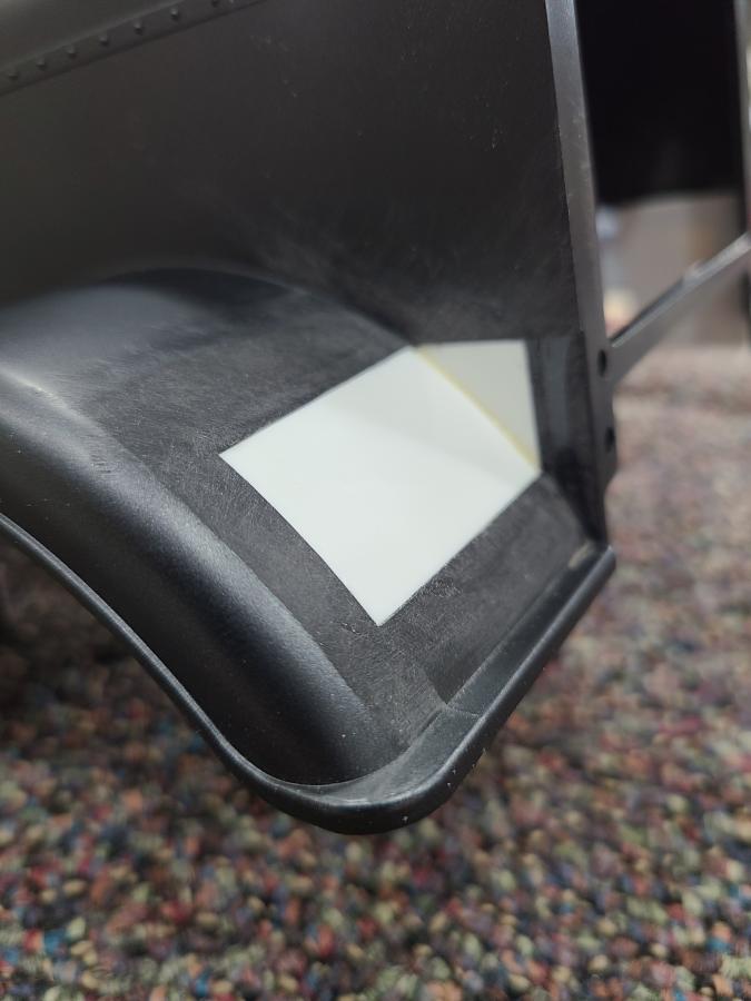

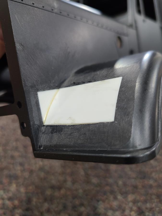

                                  • #18

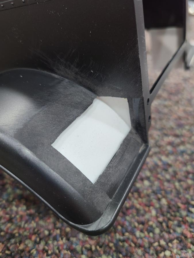

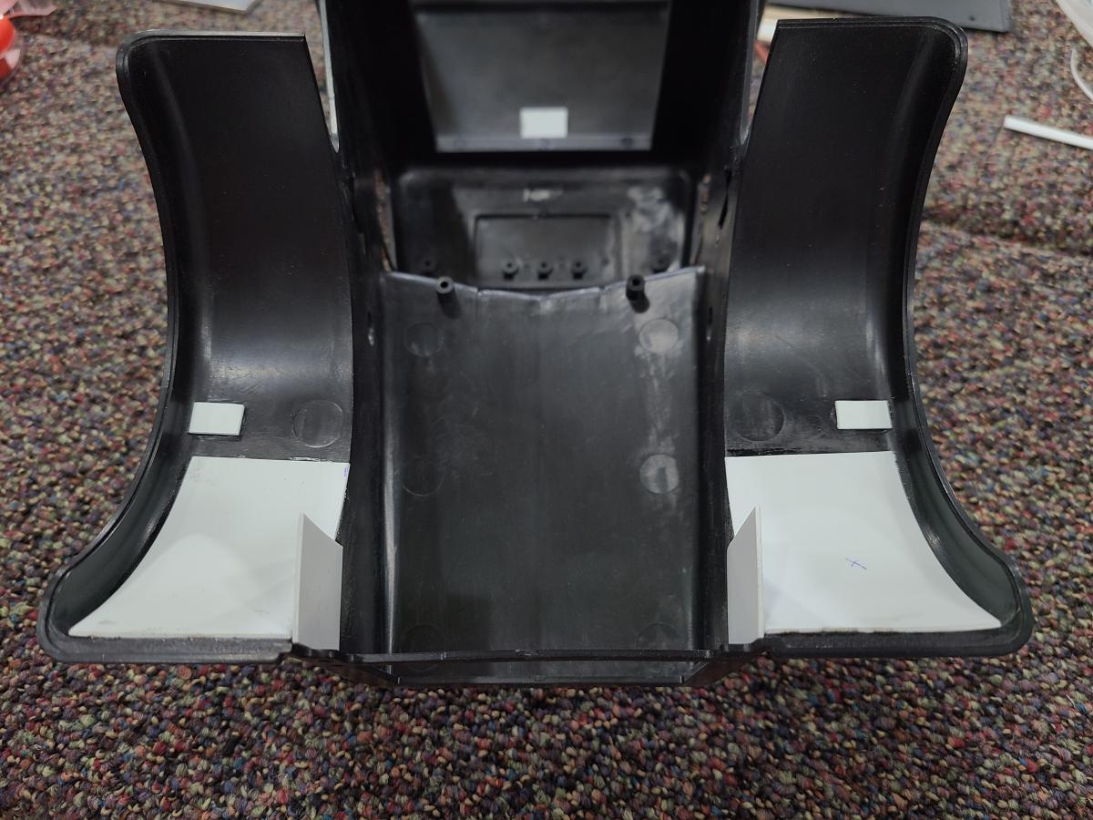

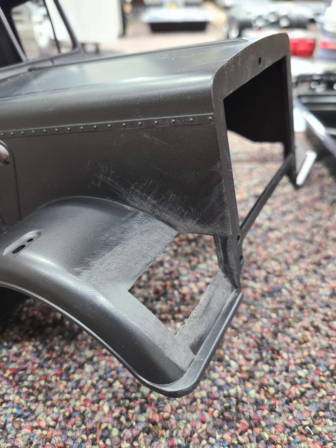

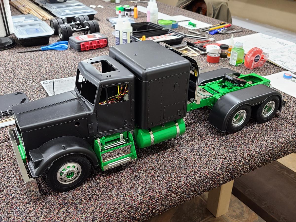

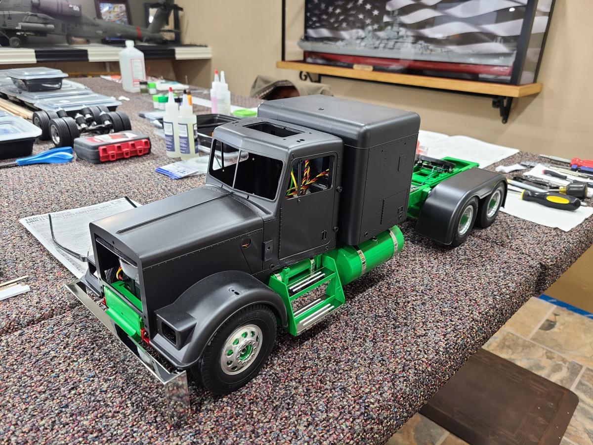

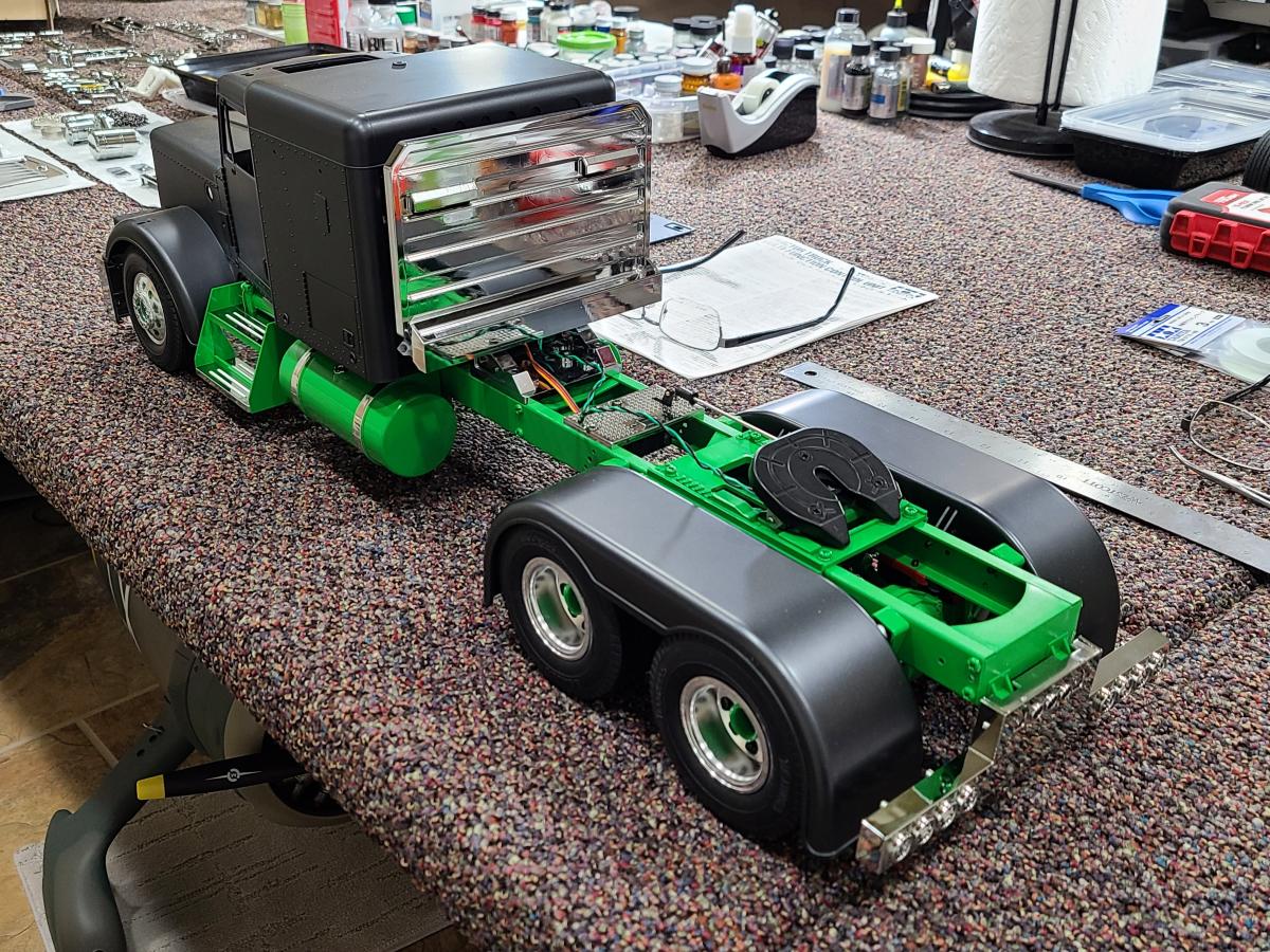

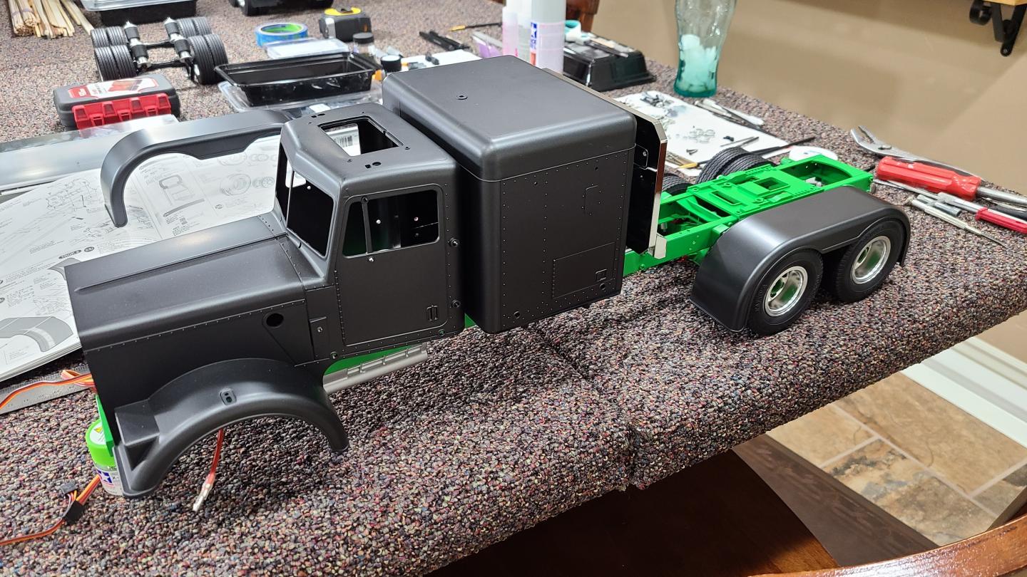

                                    Starting my body work to turn this into a Peterbilt. Ground out the old headlight buckets and filling in with plastic as best I can before using putty.

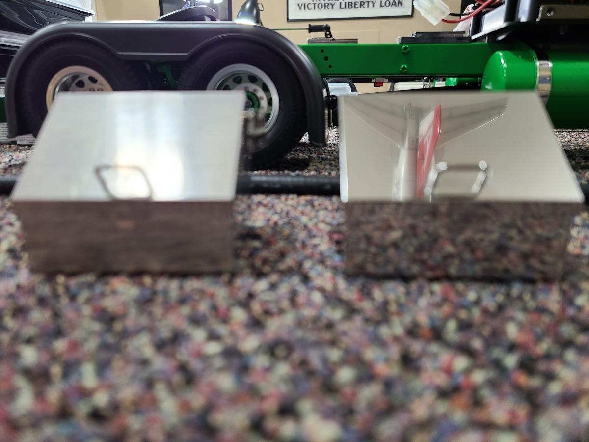

                                      • #20

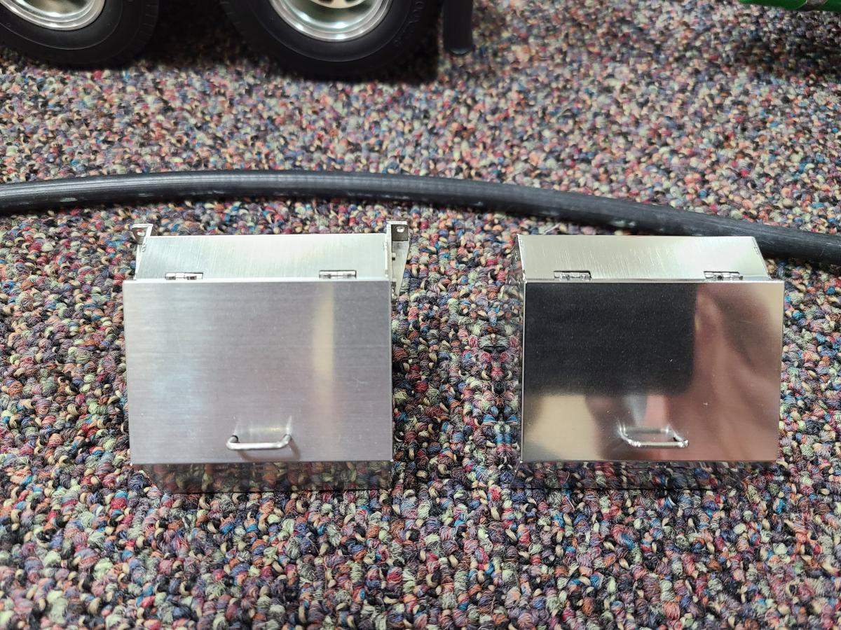

                                        Bought some tool boxes to mount behind my fuel tanks. Took some time to polish them up a bit.
