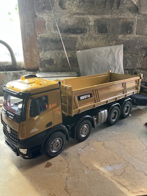

    I decided I needed a modern representation to transport tanks around. I started with a HuiNa 8x4 tipper lorry.

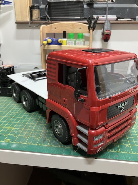

    Did a basic dry build, but using a cab from a MAN.

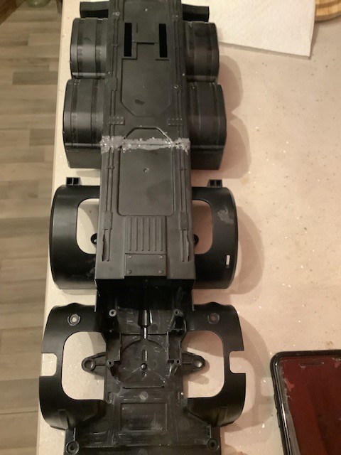

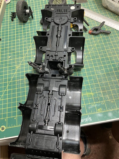

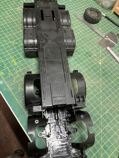

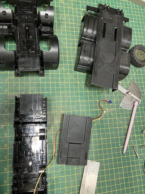

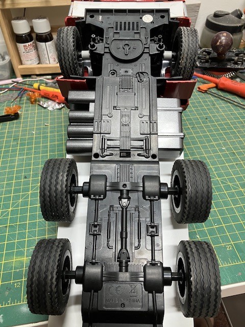

    First job is to shorten the chassis.
ID:	433605 Click image for larger version
ID:	433604 Click image for larger version
    The shorter chassis was glued back together and left overnight. Click image for larger version

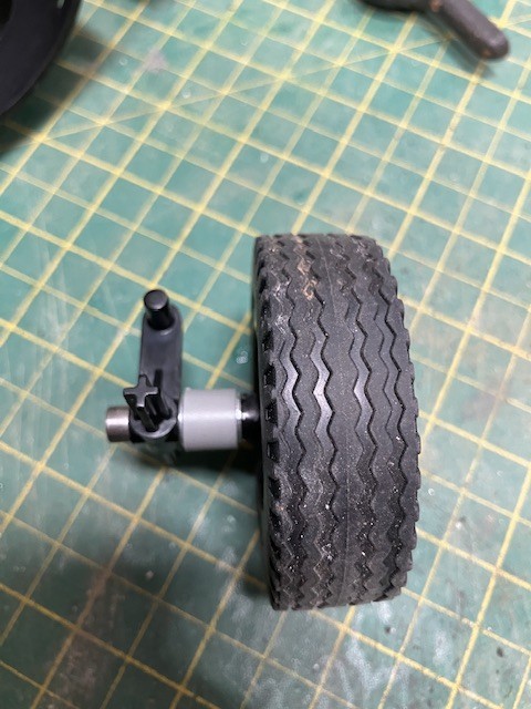

    Finally, the front track was also widened.

    When you shortened the chassis did you add any reinforcement or just glue it back together ?
    • Meter Rat
      • 504
      • Argyll and Bute, Scotland
      30mm was removed. As the cut was across the battery box, reinforcements were added inside. All I used was 1mm plastic card, glued with plastic weld, and reinforced with JB weld. This has stalled for the time being whilst I wait for the cab to arrive.

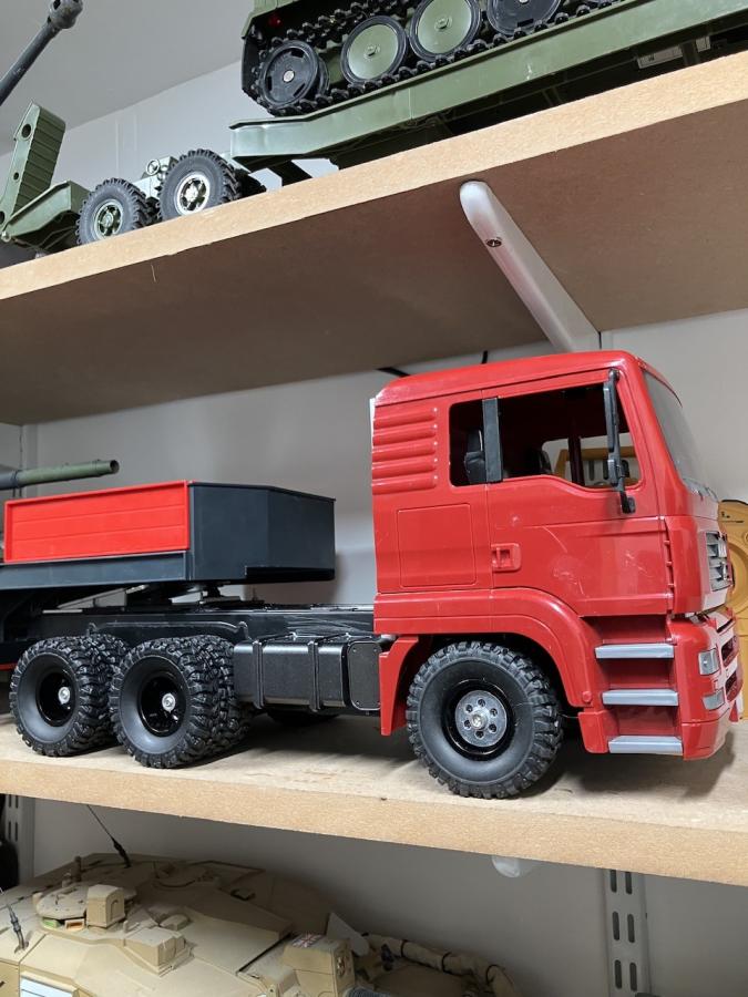

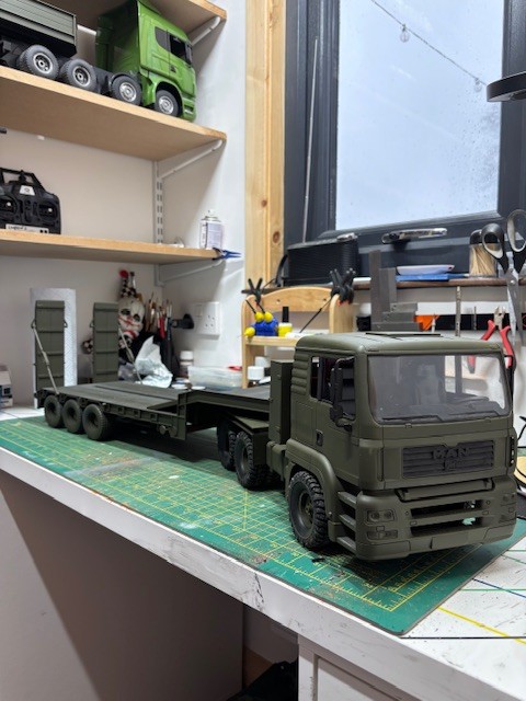

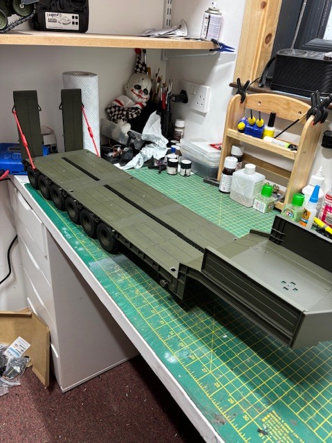

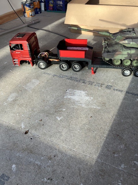

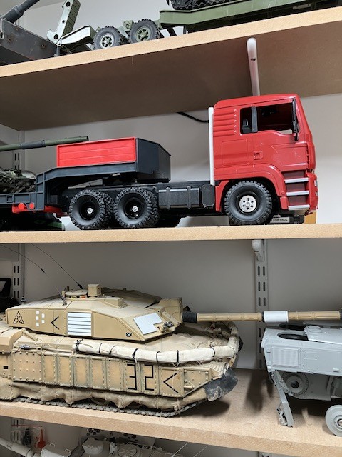

      Meanwhile the MAN cab has been installed on a 6x4 chassis, which was the intention. A smaller prime mover with a tri-axle trailer. All that was required for this was some widening of the axels, and removal of some surplus mounts for the tipper body. This one will have a WPL Res 3V control, which will give proportional control, sound and a spare channel for the ramps on the trailer.
      Click image for larger version  Name:	IMG_6397.jpg Views:	0 Size:	89.1 KB ID:	433956 Click image for larger version  Name:	IMG_6398.jpg Views:	0 Size:	104.0 KB ID:	433957 Click image for larger version  Name:	IMG_6399.jpg Views:	0 Size:	126.7 KB ID:	433958 Click image for larger version  Name:	IMG_0953.png Views:	0 Size:	316.2 KB ID:	433959
      Unfortunately I am not that impressed with HuiNa. For the cost, I expect at least, proportional control and suspension, tyres provide limited traction, and due to the drive being locked, and not open differentials it tends to push on in a straight line. They represent poor value for money, compared to WPL.

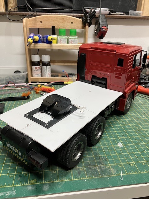

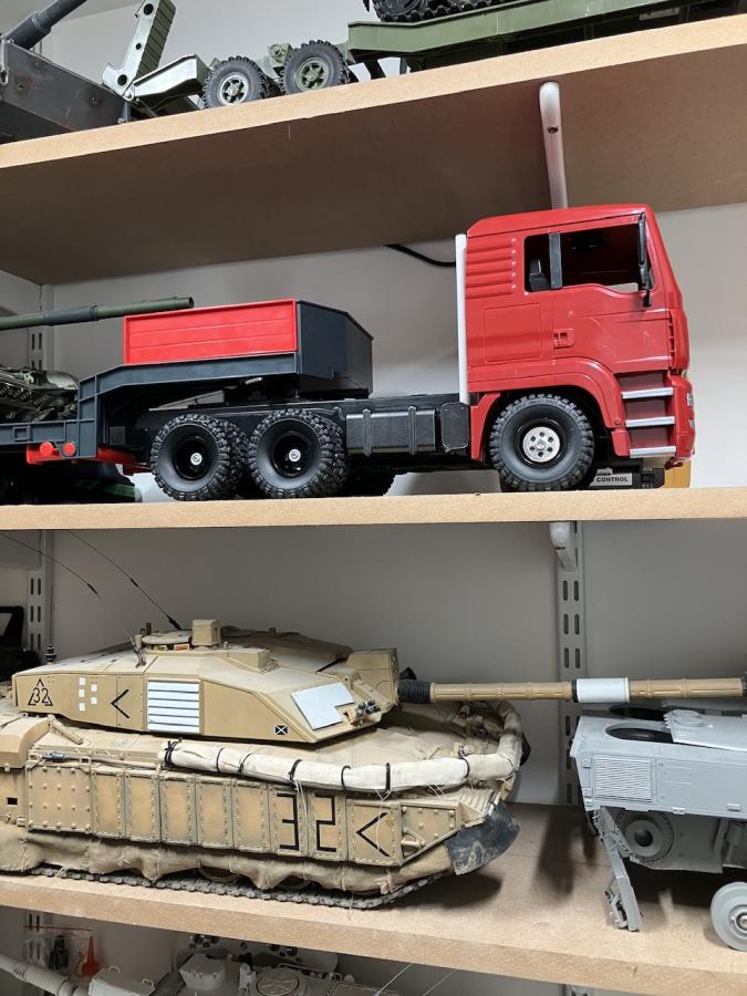

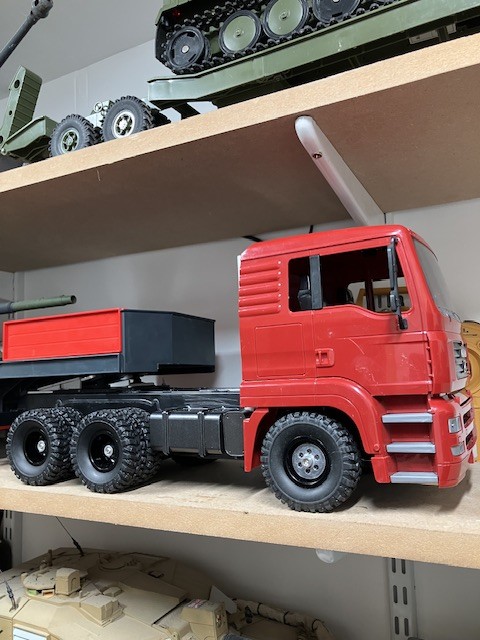

        Still not impressed with HuiNa. Huge lack of traction but plowing on any way. The MAN 6 x 4 has been altered, now I have better pictures, and a WPL RES 3 board installed. Click image for larger version
ID:	439727 Click image for larger version

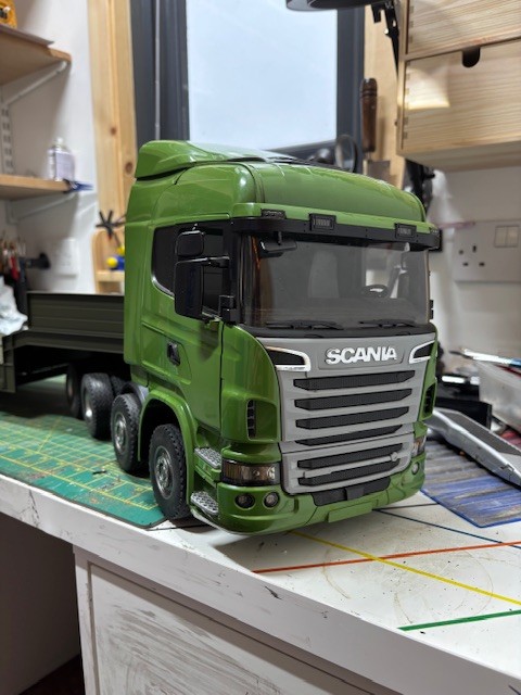

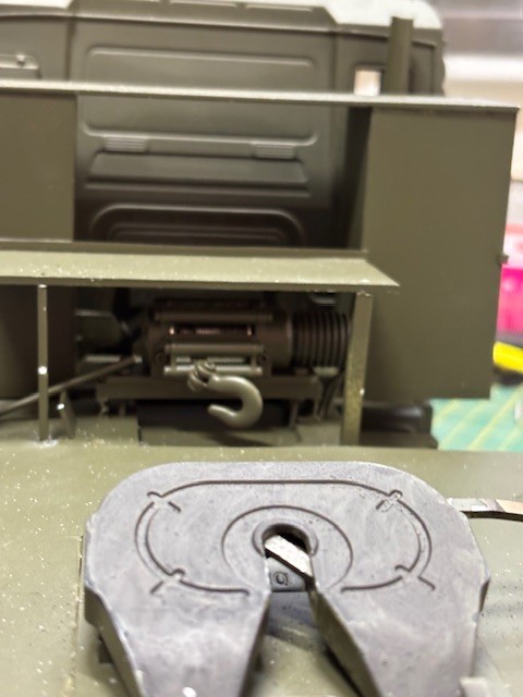

        This now needs the tool boxes, work platforms, and winches fitted behind the cab. New rear mudguards are also required. Then it is the small matter of working out how to get working ramps on the trailer.

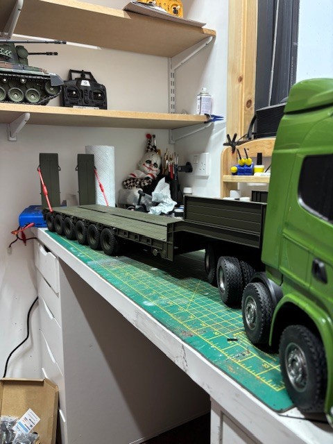

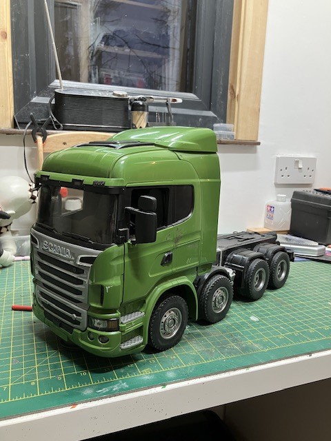

        A Scania Cab has been obtained and has been trial installed on the 8 x 4 chassis. This now needs the tool boxes, which will be the new battery box, and air tanks fitted behind the cab. I’m undecided about duelling the rear wheels on this one. Both need plenty of weight to give them traction.

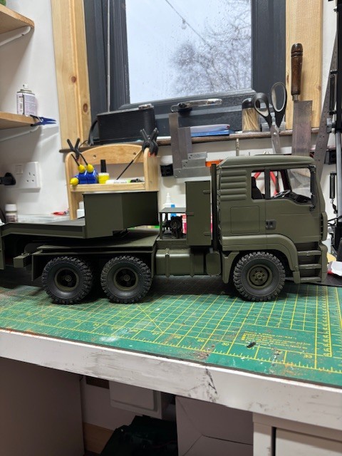

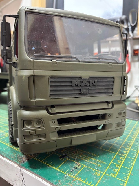

          Working away on these conversations. The MAN is 96% complete. Click image for larger version
ID:	442447 Click image for larger version
ID:	442448 Click image for larger version
ID:	442449 Click image for larger version

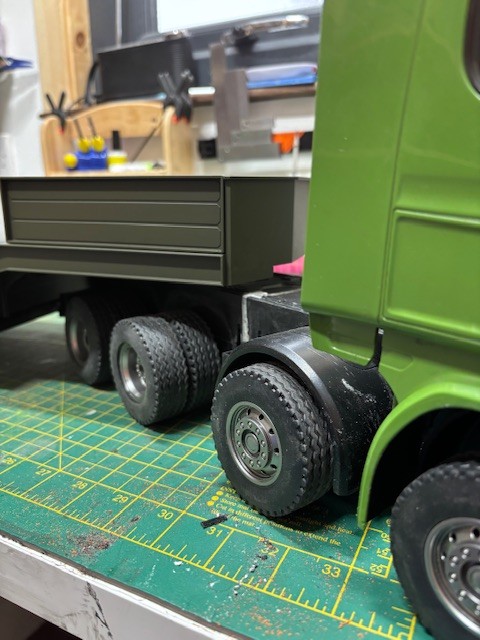

ID:	442450 While the Scania is about 70% complete. Click image for larger version
ID:	442451 Click image for larger version
ID:	442452 Click image for larger version
ID:	442453 Click image for larger version
