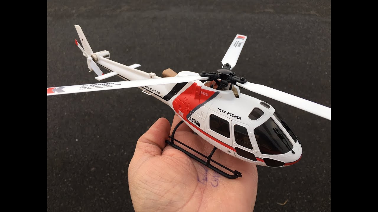

    I have recently had the opportunity to get this Heli and put it in the air. The packaging it comes in is absolutely stout and this should arrived unscathed despite any shippers attempt to destroy it on its way to you. Assembly is minor just attach the blades using the included Allen Wrench, I would recommend using it so you don't to strip the plastic! The Heli comes with a spare set of Blades, Main Gear, Tail Blade and a small Phillips Screwdriver.
    The biggest downgrade is the manual, Yikes. We are working to get a better version of it soon but for now the Throttle and Pitch Curves work and a general understanding of Heli programming may be helpful. The Flying part was the best. I have flown Helis for a few years so I was ready for anything. In 6G it will not allow you to roll or flip the Heli but you still have to fly this thing. Do not let the 6 Axis Gyro fool you into thinking it is an Auto Pilot cause it's not. Is it a stable Hover, Yes but you have to maintain it thru stick inputs otherwise it will stay level but drift off on you. Can a Beginner teach themselves with it, Yes but one needs to have patience and not get ahead of yourself. Stick to Tail In Hovering first then graduate to flying simple circle patterns working up to Nose In Hover.
    Flight times are in the 3-4 Minute Range and the RTF Radio is more than adequate to do the job and I recommend the RTF if you are new to Helis. As always feel free to call us to get more in depth information and we will gladly get you taken care of.

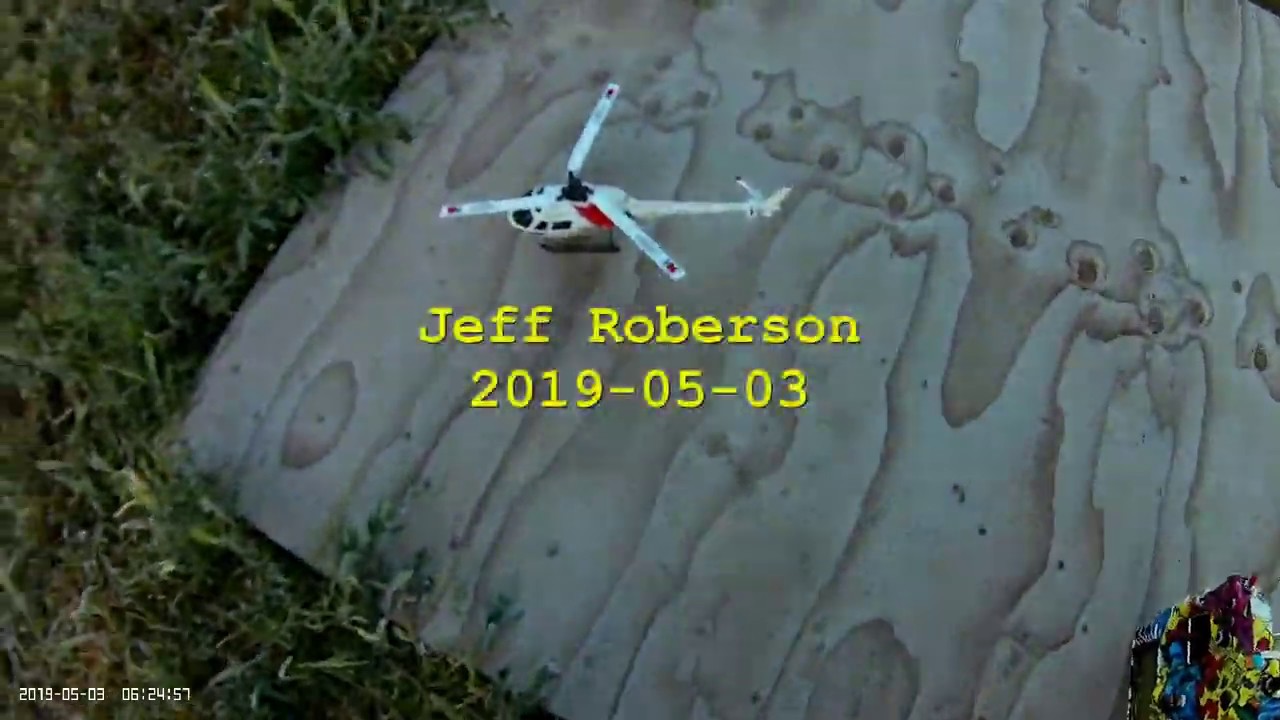

                      After six years hovering micros indoors, I recently started going outside and trying my hand at inverted flight. (I moved from the city to rural central Utah last summer so I now have a flying field in my back yard!) My current favorite micro is the XK K123.

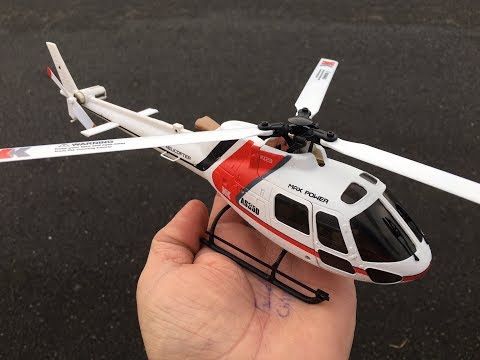

                        Fun with mine, and some tricks! Skip to 3min mark, buy it at MotionRC!
