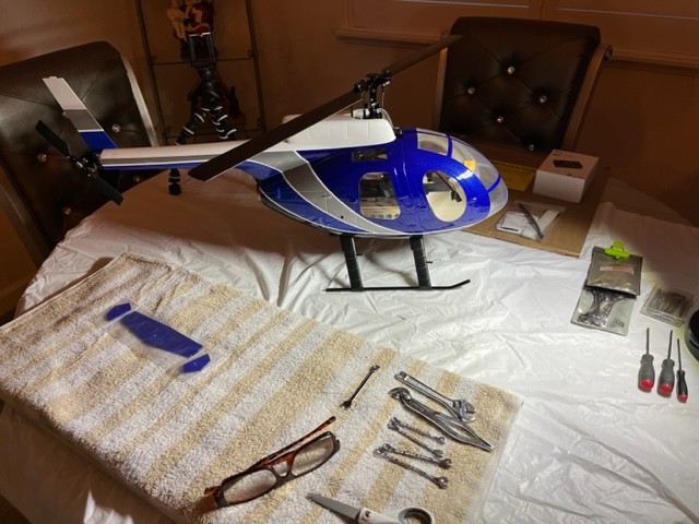

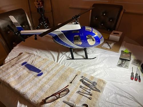

                      Moving up to Scale Helicopters from a 200 size. Thought the Rotorscale MD 500 would be a great place to start. I've been looking at it for the last 6 months Click image for larger version
ID:	363459 or so while I became proficient with the OMP 200. Thankfully I have a buddy to help guide me through all the steps. Mine arrived yesterday and what beautiful model! I will be updating my progress.
                      • DCORSAIR
                        • 1918
                        • Selma, Ca.
                        #51
                        Looks great, try a 800 size and you will be hooked......
