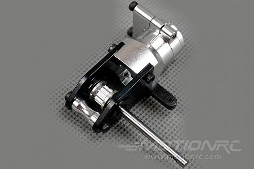

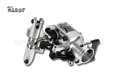

                    Looking good Gravy ! My AH-6 fuse is on the way, so I'm excited to get started after seeing yours. I found a tail rotor assembly on Tarot rc that looks identical to the one on MRC. Even the stab mount looks the same. It's 13.00 and change, and in stock. I guess I'm going to order The Tarot sport frame, and get a flybarless head for it. The 450 sport kit is 90.00 without any electronics or motor. Click image for larger version
                    • #11
ID:	212604 oops.... forgot the other picture. Click image for larger version
                      • #12
                        Thanks, got one ordered.
