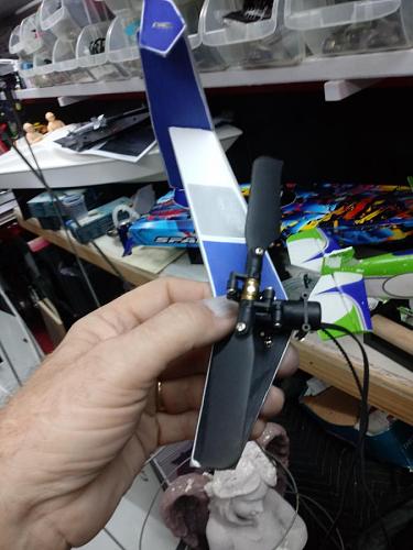

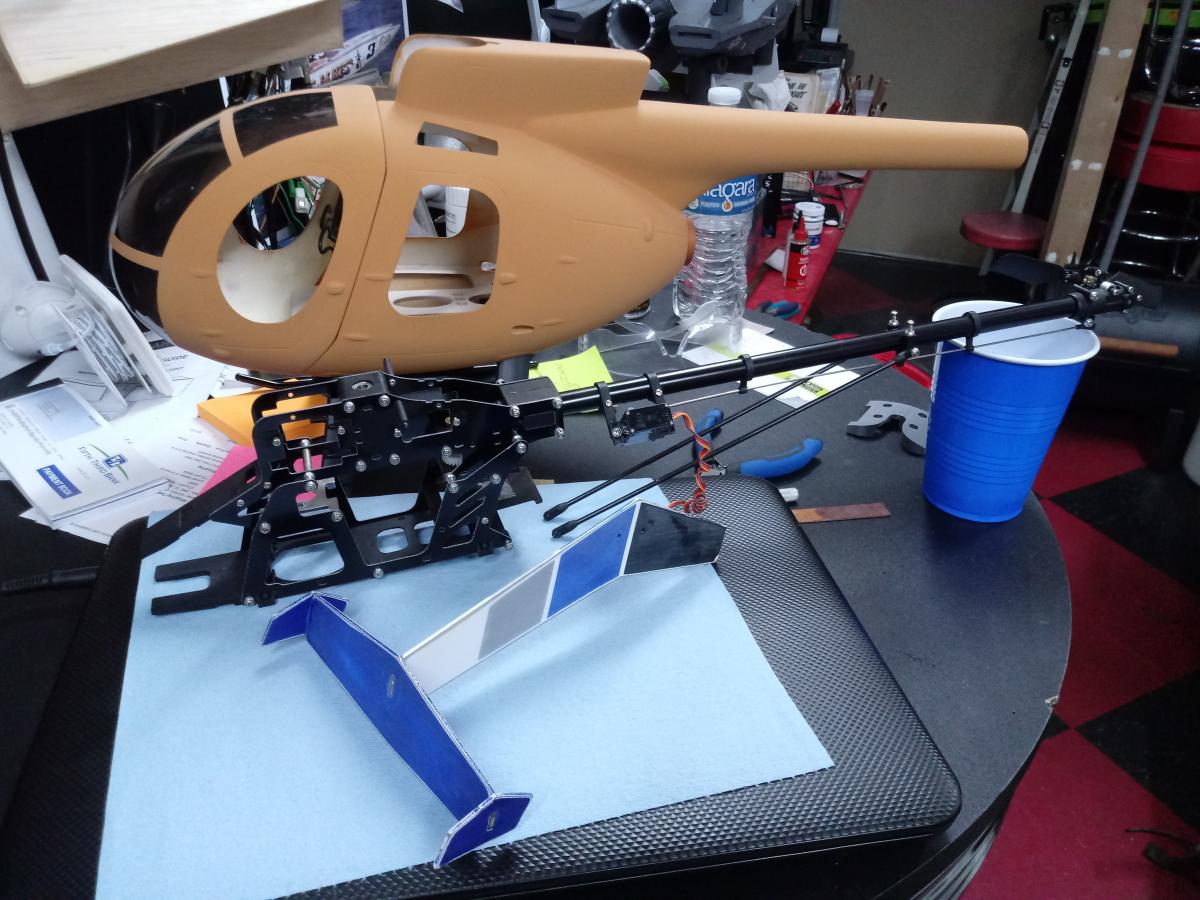

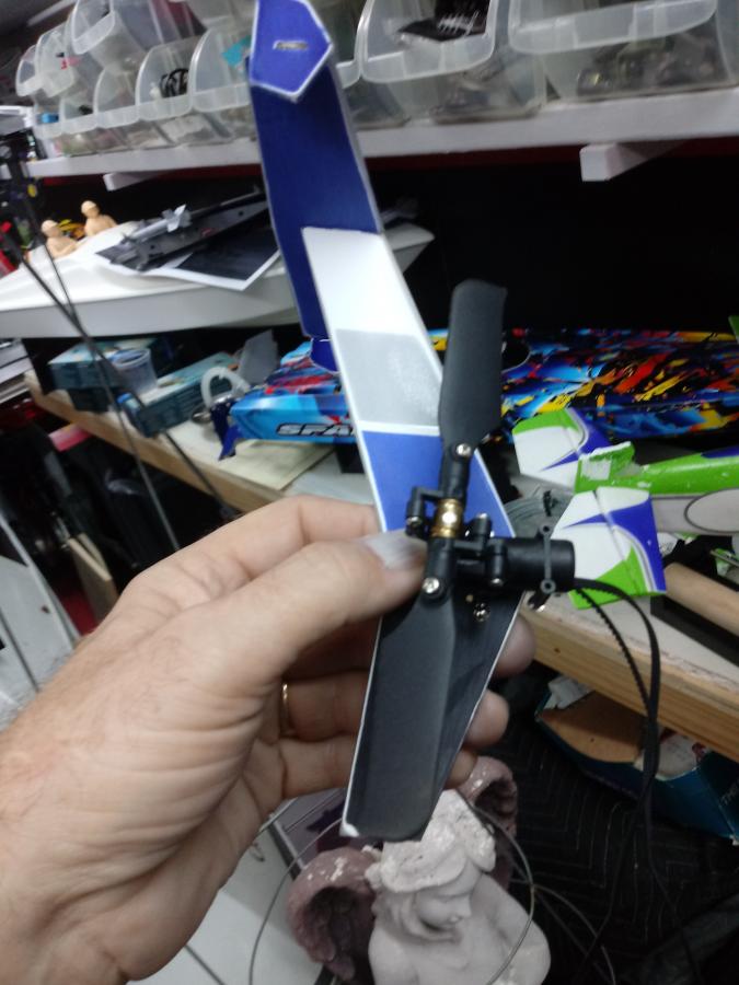

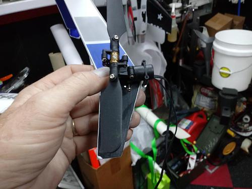

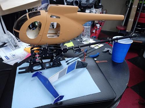

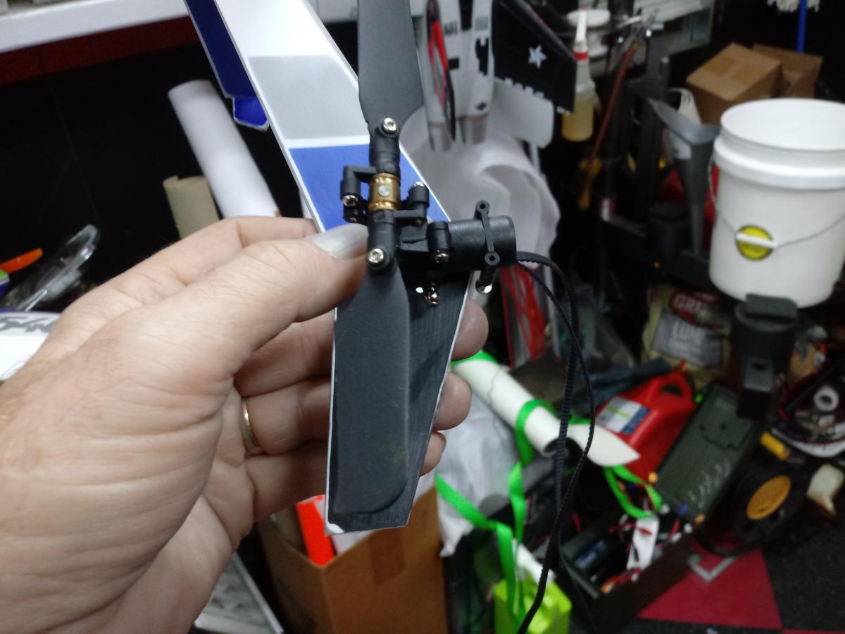

                              Almost done.... again.
                              I have now flown the new mechanics only with the newly installed 5 blade setup. Man I learned a lot doing that, and I don’t meN just need ways to pull my hair out either.
                              Rebuilt whole tail stabilizer out of hobby birch and painted to match original. Added 72mm tail rotor blades. Added 315mm carbon fiber main rotor blades and added microbeast FBL controller.
                              I also took some liberties with some LEDs and a FW nav light controller.
                              mom nkw running through stock motor and gears 150t and 13t on 4S which gives me lower head speed at higher throttle. My throttle curve is 80% throw mid stick the 80-90% from mid to full stick.
                              whats left before first flight in fuse.
