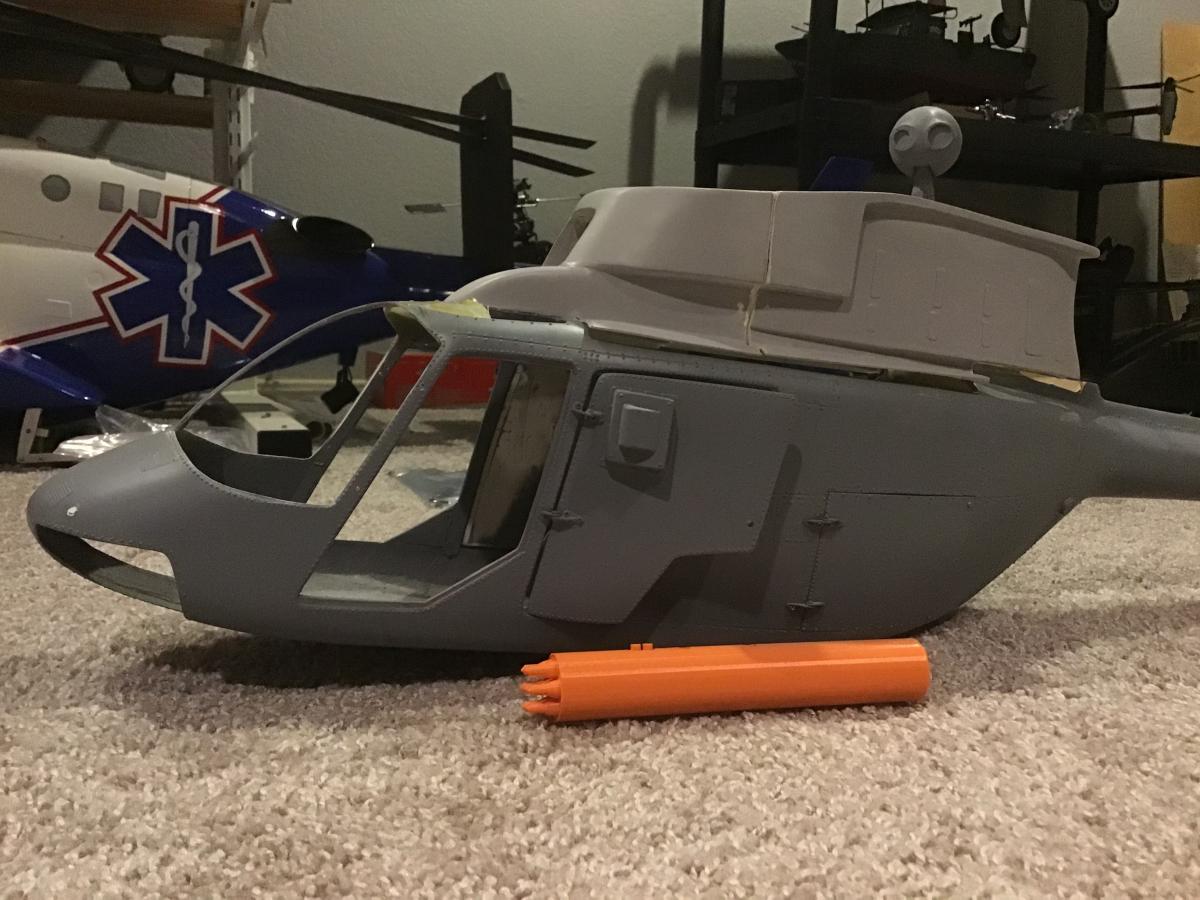

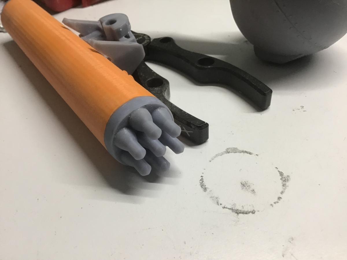

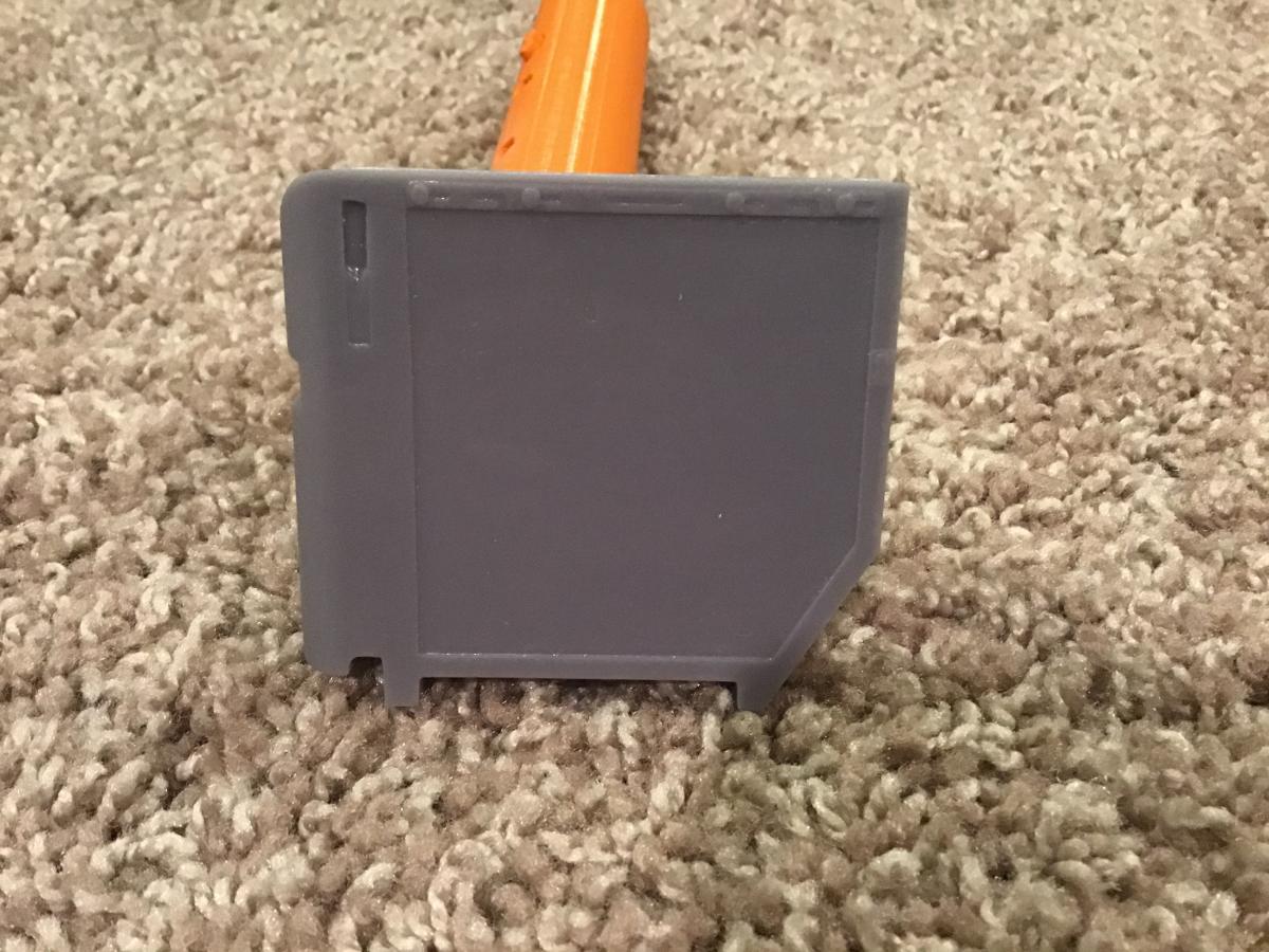

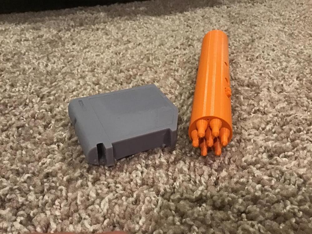

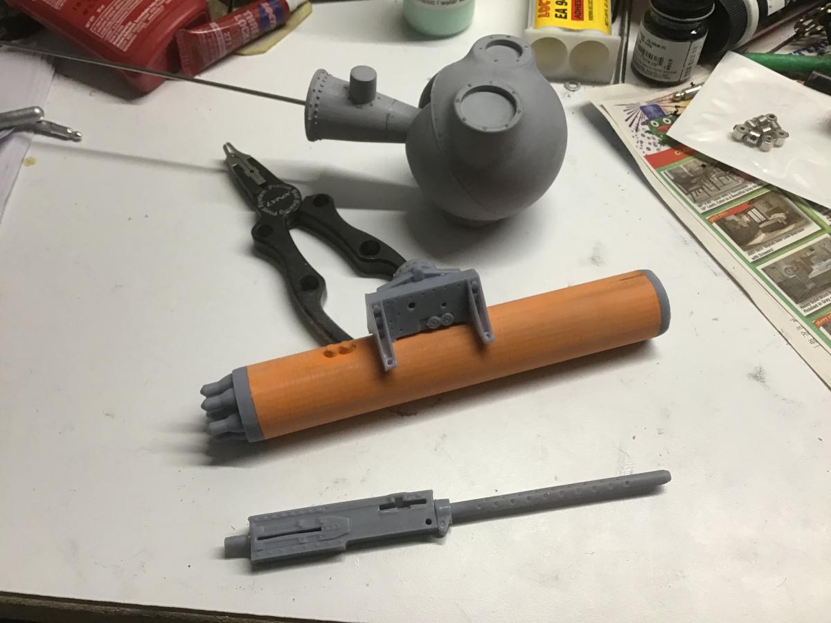

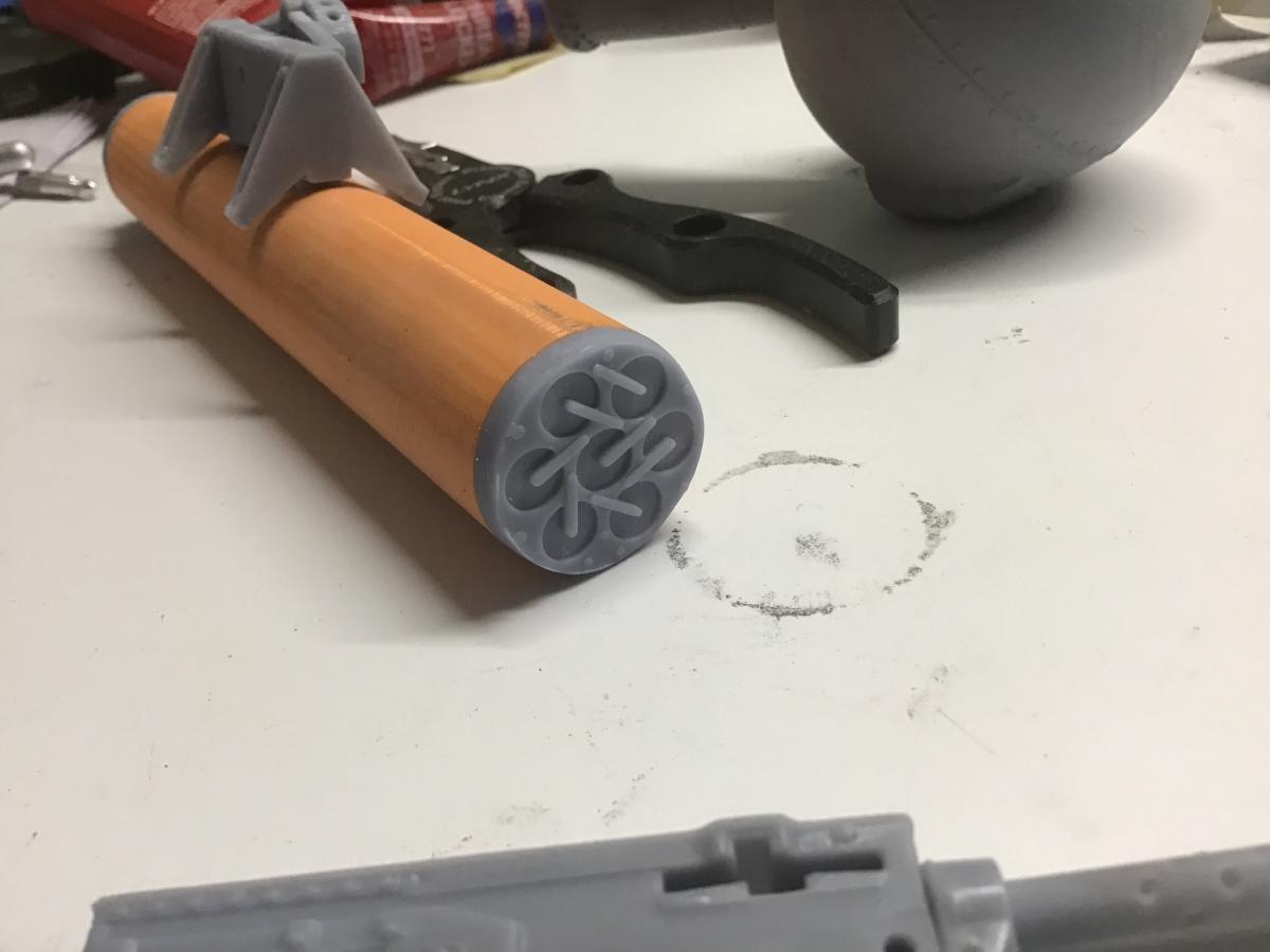

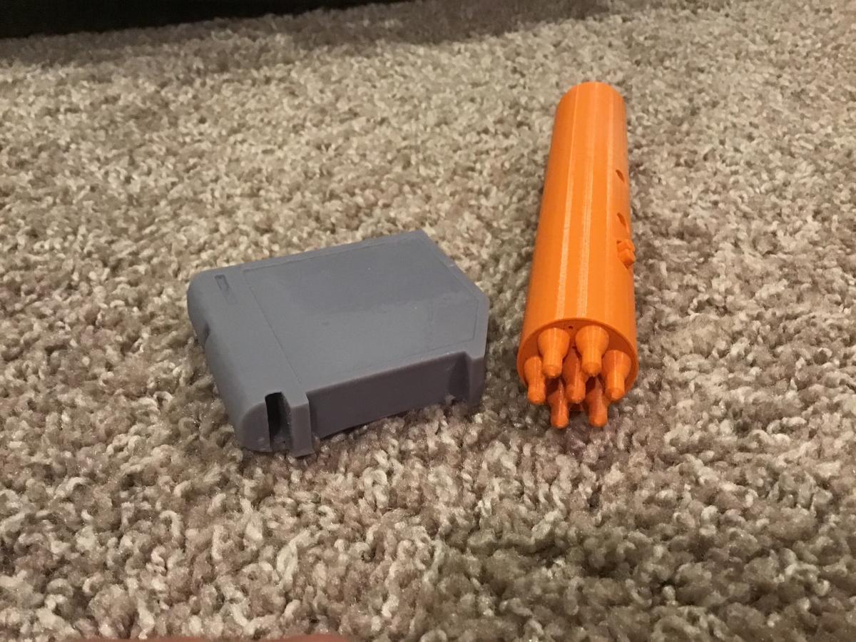

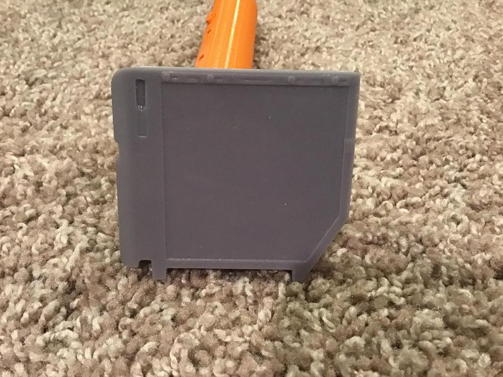

    Making some progress on a few of the weapons systems. Modeled the rocket pod and the ammo can for the gun in Solidworks. Printed out the rocket pod on my Ender 3 and the ammo can as my first resin print. With how well the ammo can turned out, I’m not sure I’ll be doing much in PLA anymore. Working on 3D modeling the weapons pylon mount next, then moving to the gun. I also split open the engine cowling for easier installation on the mechanics.

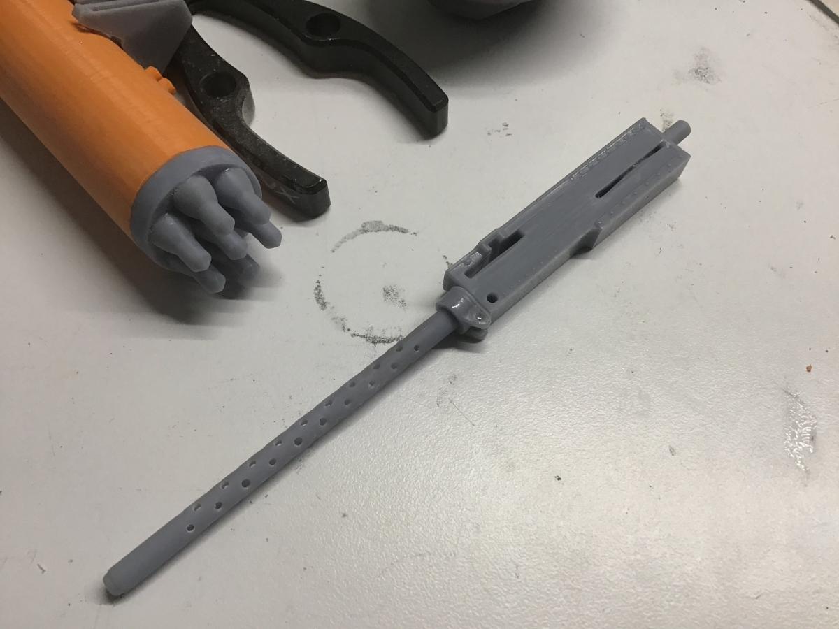

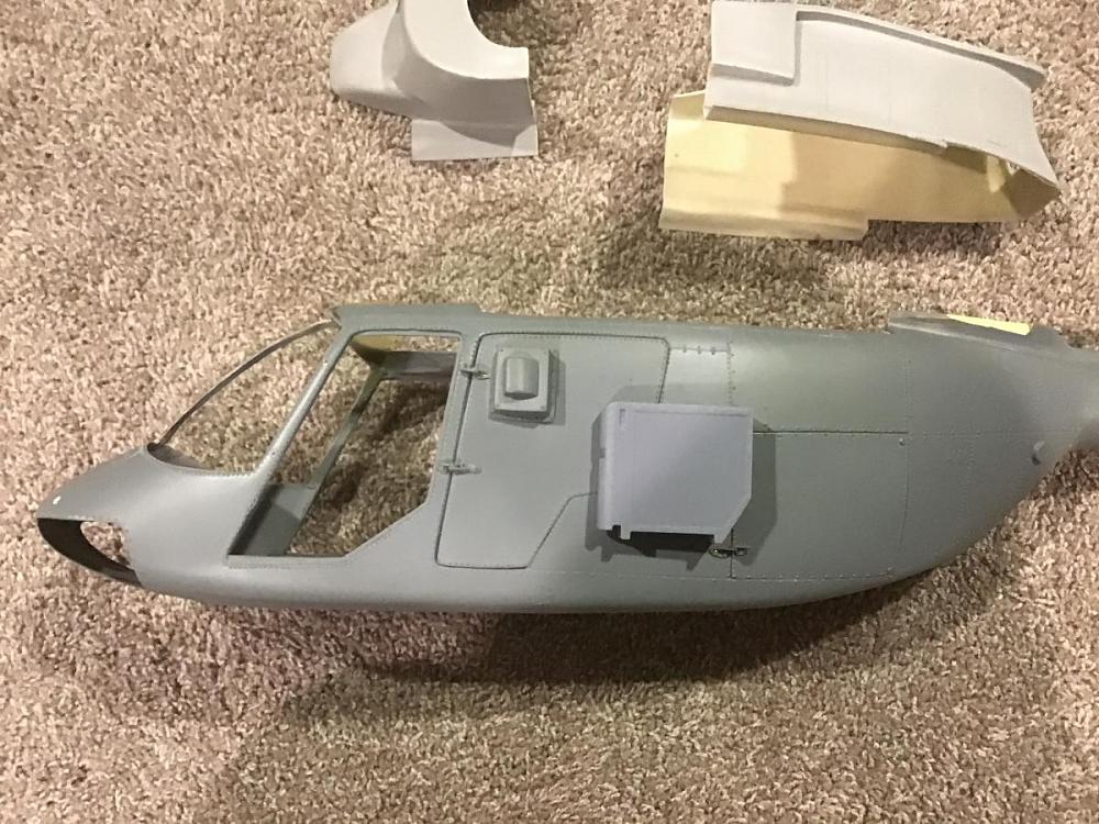

ID:	309172 More parts printed for the Kiowa on the new resin printer. Also decided to re print the front and back side of the rocket pod. Mechs are getting close to flight as well.

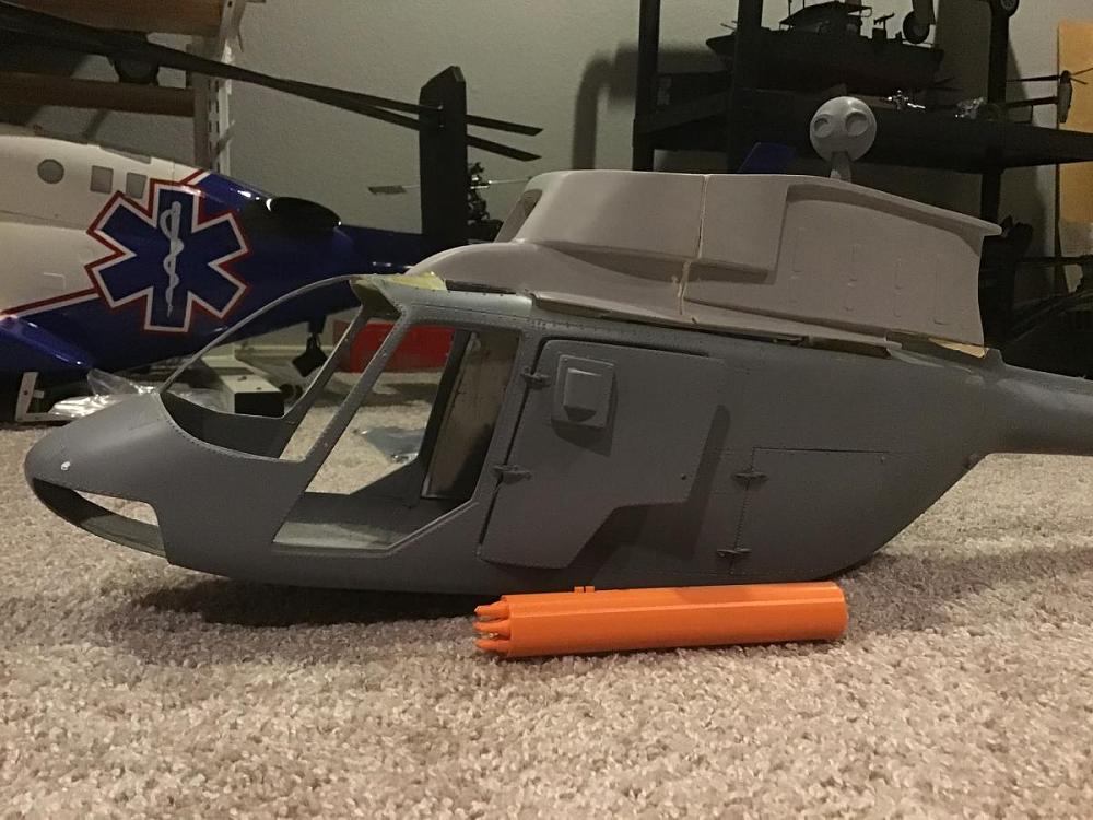

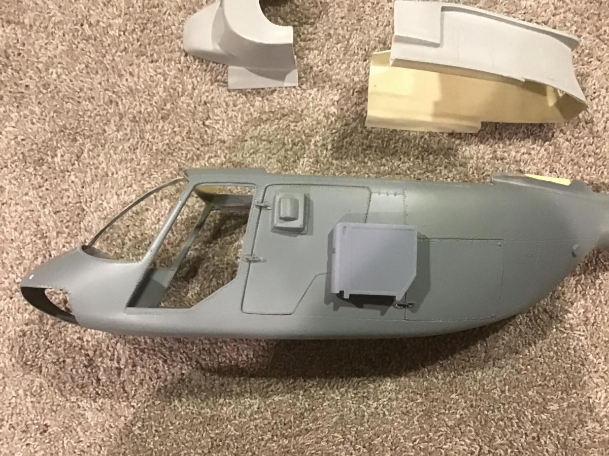

          Well, its been 2 years of this project sitting on the shelf and I'm finally starting to get back to it. For a while, I had shelved it simply because it didn't look right. Last week, I was able to print off some drawings and do a comparison. The major issues were that the boom was several inches too short, the boom was at the wrong angle, and the stock vertical fin was entirely the wrong shape. The horizontal stabs also needed to be re-sized.
          First order of business was fixing the boom angle. The full scale OH-58 and 206 have the boom angled up a few degrees. I cut the boom off with a dremel cutoff wheel, sanded it, and re-attached it at the proper angle, fiberglass and filler were used the reinforce and blend the attach point.
          Next, I designed a 3d printed boom extension plug in CAD. This added about 3.5" to the boom forward of the tail rotor gearbox. I still need to figure out a section for the aft "point" of the tailcone. This was glued into the boom and filled/blended.
          New H-stabs were designed in CAD and 3D printed.
          For the vertical stab, I decided to go the old school method. I cut the outline out of 3/16 balsa and sanded it to shape. After priming and sanded, I laminated the sides in thin sheet styrene. Photos to follow soon.

            Here’s a few shots of the rework so far. The first picture is the baseline that PKM sent me as it was built, so all the changes are visible. Corrected the upper canopy shape, new engine cowling (PKM did this one), re-angled boom, lengthened boom by 3.5” and stretched the torque tube, new H stabs, and a new V-fin.
