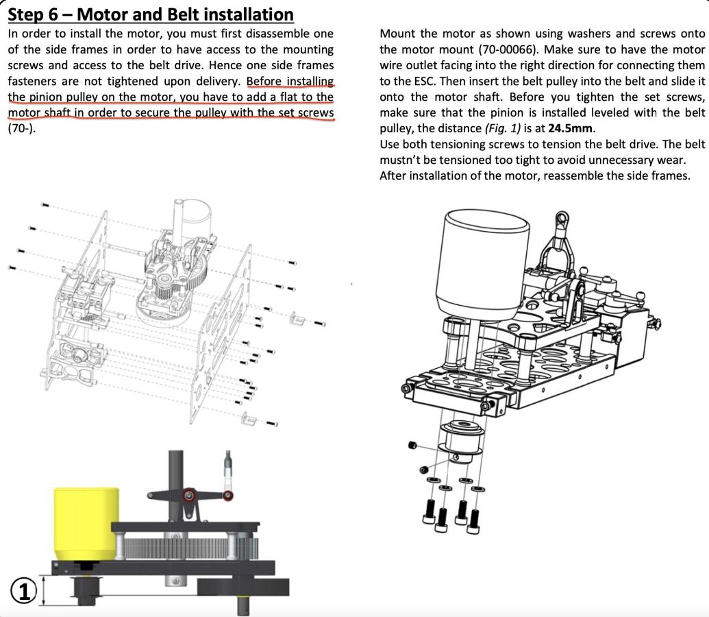

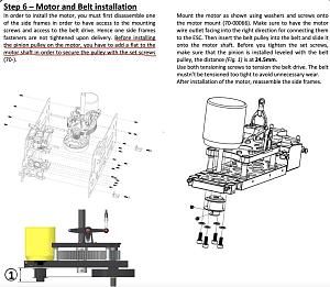

                Hey George, Thanks for sharing your B429 with us. I'm starting my build with a lack understanding about (washer) mentioned in Step 6; not seeing the purpose.
                Could you shed some light PLEASE!!!
                THANKS IN ADVANCE

                  I'm not quite sure if I'm answering your question correctly, but if it's related to what is underlined in the picture, it's saying to make sure you there's a flat area on the motor shaft to tighten the set screws down... some motors don't have a flat section all the way down the entire shaft, just on the end closest to the base.
                  • #29
                    Thanks George, that one went over my head; I assumed documentation was referring to a flat "washer" Oops!!!
