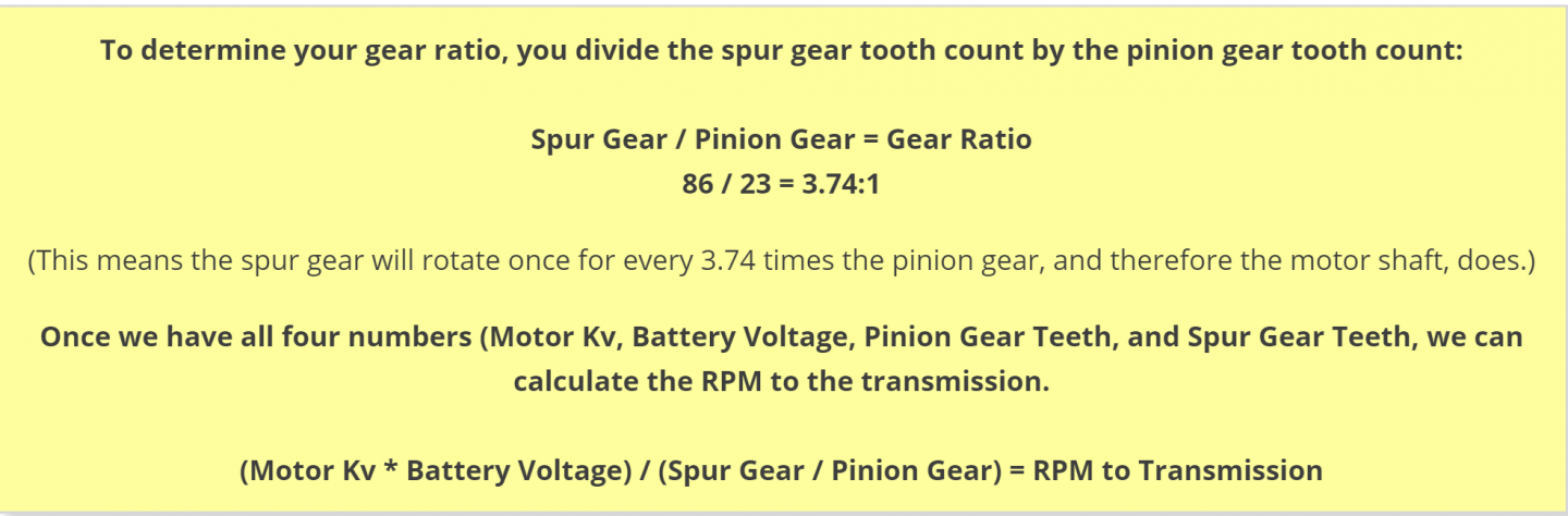

                    I'm setting up my esc .. it's a hobbywing platinum 200 .. I did my rpm calibration and data shows 135 x1000 .. at 50% throttle .I m trying to figure out what the gear ratio is of the mechanics, main gear was 78t another gear was 36t and a pulley gear was 22t .. so I can figure out headspeed calculations. I have a 455kv motor at 10 poles.. thanks
                    I think all of the Roban 700/800 mechanics use the same ratio= 1:13.8. I know when I setup my Castle 120HV, I put 13.8 in the ratio box (I didn't use the gear/pinion count at all) and it's been working perfectly.

                        On my 700 I originally did the math and got 13.8:1
                        pulley to pulley gears are 22 and 78 which has a ratio of 3.54:1
                        then piñon gear to piñon is 20 to 78 which is 3.9:1
                        times the two together and you get 13.8:1
                        to double check I also did old fashion way. Counted how many rotations the motor made for one rotation of the head. I got 13:1. If it wasn’t exactly 13:1 it was 12:.9 or 13.1 to 1, definitely not 13.8.

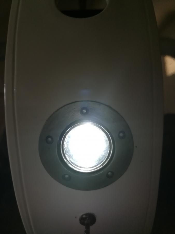

                                Update on the Magnum PI, it's been flying great, I actually stopped flying it for a bit when I got the OH-6 kit and built it, now I got everything working, like the lights, front landing light is now installed, my buddy Gravy, 3D printed me the front light cover, he did one for my OH-6 as well, it was bothering me that Roban has the hole for the light in the wrong location, so I dremeled a new hole lower down with the pitot tube in the right spot below the light, it looks great. Here is an updated video of it flying as of today 1/2/21.

                                    • #38
                                      No you guys can't have the file, it was made top secret just for me, just kidding of course, but I have to say, he did an awesome job on it, they are supposed to be painted the same as the fuselage as most of the real ones are but I wanted mine to stand out so I just used a silver sharpie on the ring then hit the holes with a black sharpie, I'm really happy with the way they look, I'm sure when he reads this he will share the file or whatever he did to get it right, I like the idea that when he gave them to me they were still flexible and molded right to the fuselage when I glued them on.

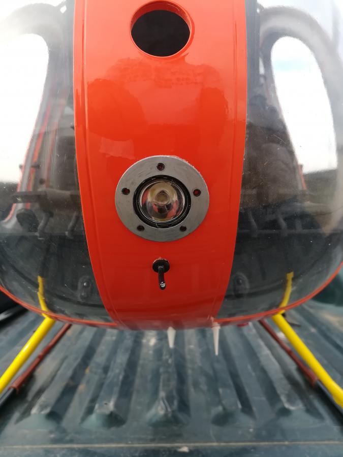

                                        • #40
                                          Here is the one he did for my OH-6, same as the Magnum PI.
