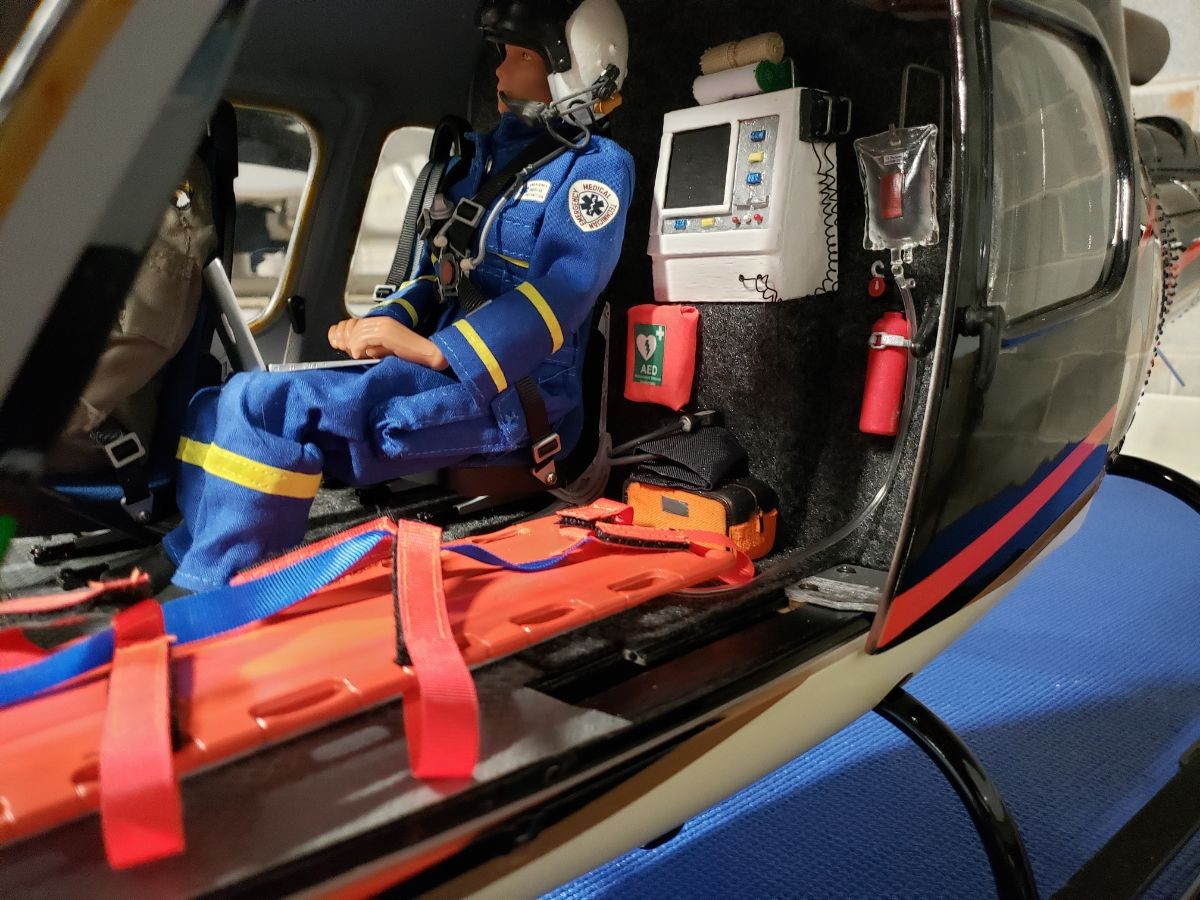

          Still a ways to go, but here’s the idea:

            That's looking really good! Reminds me of the medical interior I built for my Roban AS350. Click image for larger version

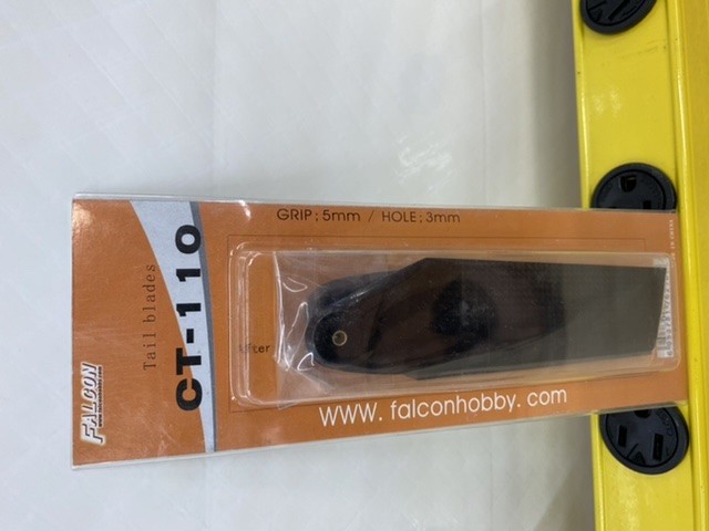

              As far as the tail blades, my kit is over 2 years old and the tail blades it came with were too short and I almost lost the heli due to lack of tail authority. I put some longer tail blades on which I believe are either 110mm or 105mm and it flies perfectly now. I can verify the tail blade length when I get off from work tonight. I also may have a spare set of the same tail blades I'm using if you don't want to wait on MRC.

                Wow, lt1pwr...that’s awesome! I emailed Tyler about 3Ding a LifePak 15 cardiac monitor for me & still waiting on my EMS bag & O2 cylinders from Scale Modela to arrive. Lots of work to do.

                  Sorry for the late response. I was wrong, my tail blades are 120mm length and they fly great. I’m gonna find those extra tail blades this weekend, I have them in a box somewhere in my basement. I just need to double check they’re 120mm since I tried many sizes until I found these. I’ll get back to you on that.

                      I found my box of tail blades and unfortunately the extra set I have are 110mm versus 120mm. Sorry about that.
