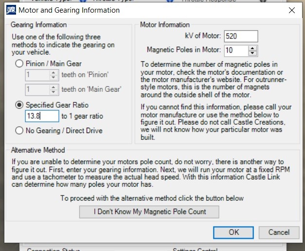

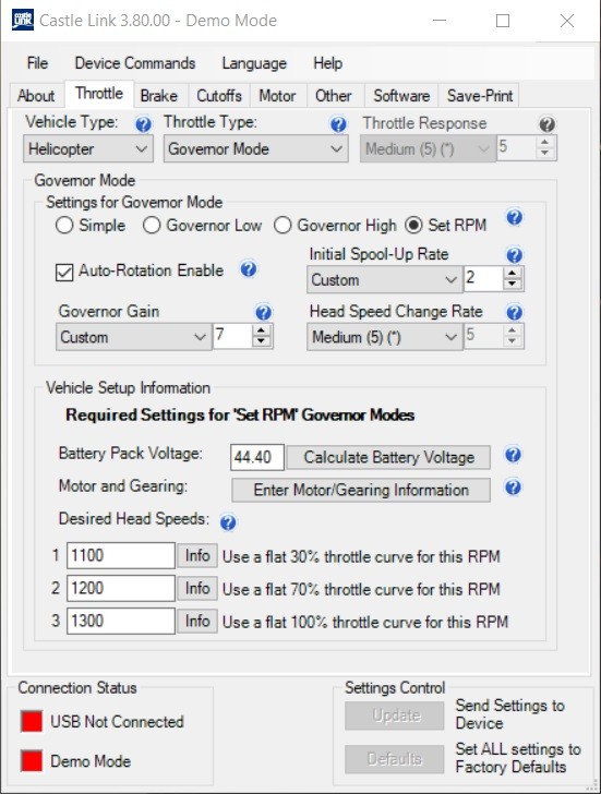

          I have an align 800 motor 520kv. I’m using the BD Axon. I went ahead and tried programming the “set rpm” in the esc and so I plugged in all the numbers but the headspeeds it said I needed to not be “too fast to govern” or “to slow to govern” was 600,700 and 750. That’s way low. I must have something wrong. Pole count is 10 for my Moter. Kv is 520. I’m using two 6s batteries so the voltage is 22.2 I think. Gear ratio is 13 to 1. Not sure if I’m missing something.

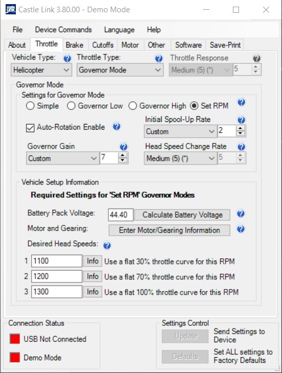

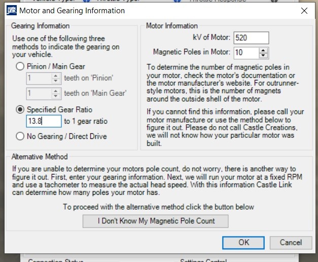

            Aces, you should be running your batteries in series... and that would equal 44.4 volts. Here's a couple pics of the setup using castlelink if you want to do set rpm.
            In that configuration 1100rpm puts you at 73.1%, 1200 79.7%, and 1300 86.3%. The castle creations ESC's like to be within 70-95% when using governor mode...
            Of course you will be running a 4 blade setup so you wouldn't go over 1200 I would think, staying somewhere between 1000 to 1150ish I think... Of course there's several apache guys on here who could tell you better than me lol... But this should at least help you get setup going if you choose to use the CC in set rpm mode.
