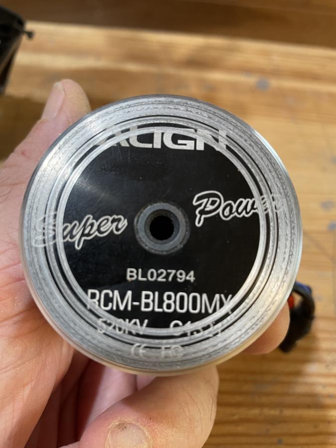

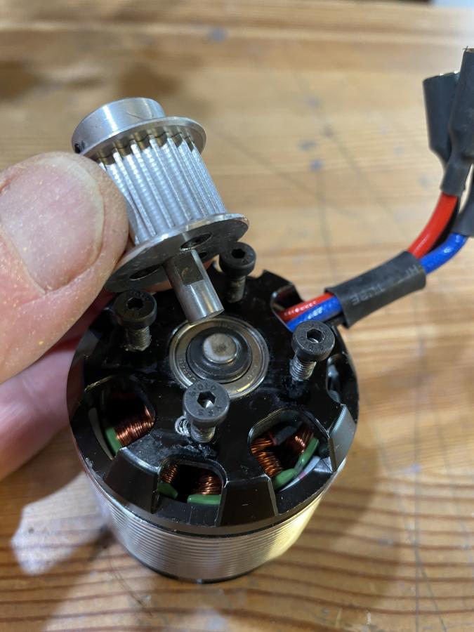

ID:	315390 Hello. I know this topic is about my motor but it is from my Roban 700 Apache build. So I’m hoping to get a little help. I installed several upgrade parts in my mechanics including a new main belt. I put it all back together and test ran it on the bench. After about 30 to 45 seconds the shaft on the motor broke. I’m going to assume that I tightened the belt too tight. I have the aligne 800 MX 520 KV motor. So I have a couple of questions.
    1. Does anyone know if the shaft can be replaced on this motor? If so is there an instructional video somewhere that someone can link to? I’ve searched on YouTube and can’t find one specific to this motor.
    2. Secondly, in general, is this motor OK for this build? If I have to purchase another motor what would be the suggestions?
    thanks.

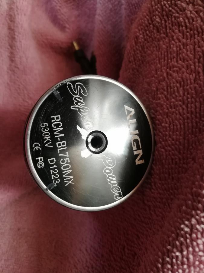

    Aces....how did the top of that motor can get scored like that?
    • #3
      Hi PawPaw. Honestly I’m not sure. I picked up this motor used from a friend. But I don’t recall if it had those on there at the time. I do know that the motor was rubbing against the air inlets that I custom built in the canopy of this Apache. But those are made out of paper so I don’t think that caused the scarring. It must’ve come like that. But it’s been several years so I don’t remember. It’s been performing fine up to this point.

        Wow, never seen one do that before, that shaft had to have some type of damage or something before you put it in I would think, I don't think having the belt to tight would have done that but I could be wrong, I have two Align 700KV motors, one in my Roban Apache and one in my Roban OH-6, I would like to know what caused that for sure, seeing that is making me nervous, I run my belts a little loose now after watching the guy from Scaleflying.de adjust his, how tight would you say yours was Ace??
        Also, those shafts are hard to find right now, to take it apart, you need to loosen the set screws hidden in the cooling fan vent holes, then once they are out you can punch out the shaft, I just set the motor upright and use a punch and hammer and tap it out, or use a press of some sort, if you take the two set screws out, make sure you catch them some how or they will jump over to the motor magnets and cause problems, I stuff a small part of a paper towel in the hole to let the set screw fall on it or magnetize an allen wrench.

                          Too tight of a belt shouldn't break a motor shaft, those are hardened steel, you're going to damage your bearings before a shaft breaks.
                          • #14
                            Yeah, I said the same thing, if you look at his picture it looks like the shaft was cracked already to me anyway.
