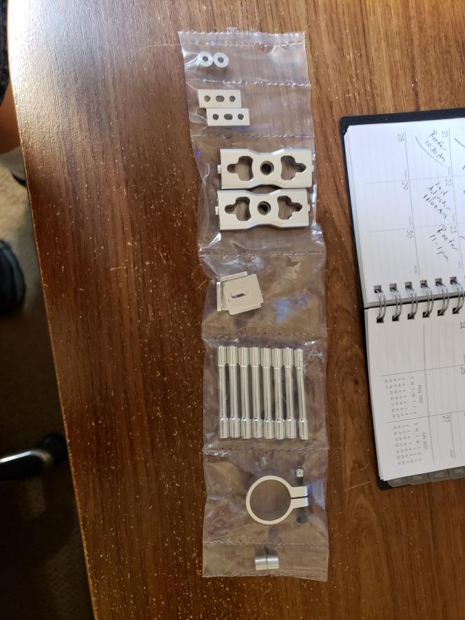

                  I just got a new Roban Kit and mine didn't come with the bearing block spacers or the frame spacers for the shorter frame spacers. Using the phoenixtech 600 and without those spacers its utterly useless. Does anyone know where to source them? Roban UH-60 v3
                  • #29
                    Get a hold of Ed at MRC and see what he says about that problem, I thought they had fixed that issue by now, it is so stupid that they sell these kits and know that there is an issue when you try and put one of these together, we have all been there and done that already, they sure don't mind taking our thousands of dollars that's for sure.
