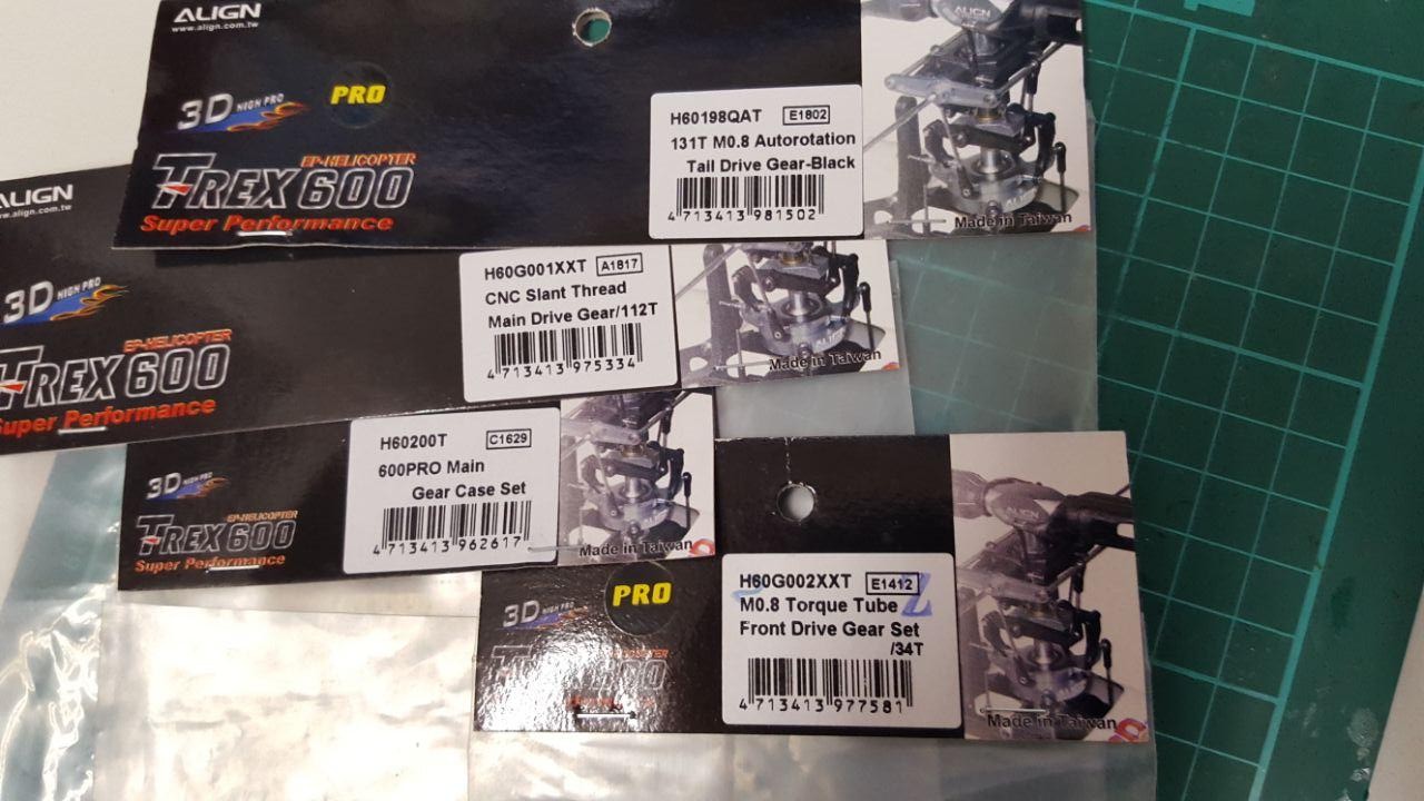

                I replaced the gear with the new slant gears from Align on the Flasher 600 , less sound from gear and straight
                see picture for part numbers Click image for larger version
