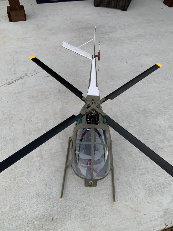

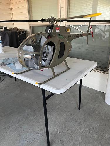

    Something I have been working on... still got some things to finish (mainly the cockpit:tired_face:) but got her up in the air today for a test flight...
    The build:
    Fuselage/Body Kit: Roban MD-500D Police Blue 600 Size Helicopter Scale Conversion Kit
    Mechanics: Phoenixtech 600 ESP
    ESC: Scorpion Tribunus II 06-120A ESC SBEC
    MOTOR: Tengu Egodrift 4025HS / 750KV (6-8S)
    GYRO/RECEIVER: AR7210 BX FBL
    SERVO: Torq BLS2208x3 (Swash)
    SERVO: Torq BLS0704T (Tail)
    Light Controller/Lights: uniLIGHT BLACK.4
    Sound System: Model Sounds Inc Shockwave 2 w/ two 2" exciters
    Align Trex 600 CNC Slant Thread Main Drive Gear/118T H60G005XX
    Align Autorotation Tail Drive Gear Set (Black) (180T) AGNH60020AA
    Align M0.6 Torque Tube Front Drive Gear Set (40T) AGNH6NG001AX
    Align Motor Slant Thread Pinion Gear 13T (L27) AGNH70G011XX
    Roban 4 Blade PNP Metal Rotorhead 10mm
    Vario 600mm 1L symmetric Main Blades
    KBDD 95mm Tail Blades

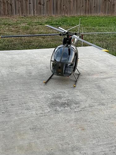

    Got a flight in to check the lights and sound card:

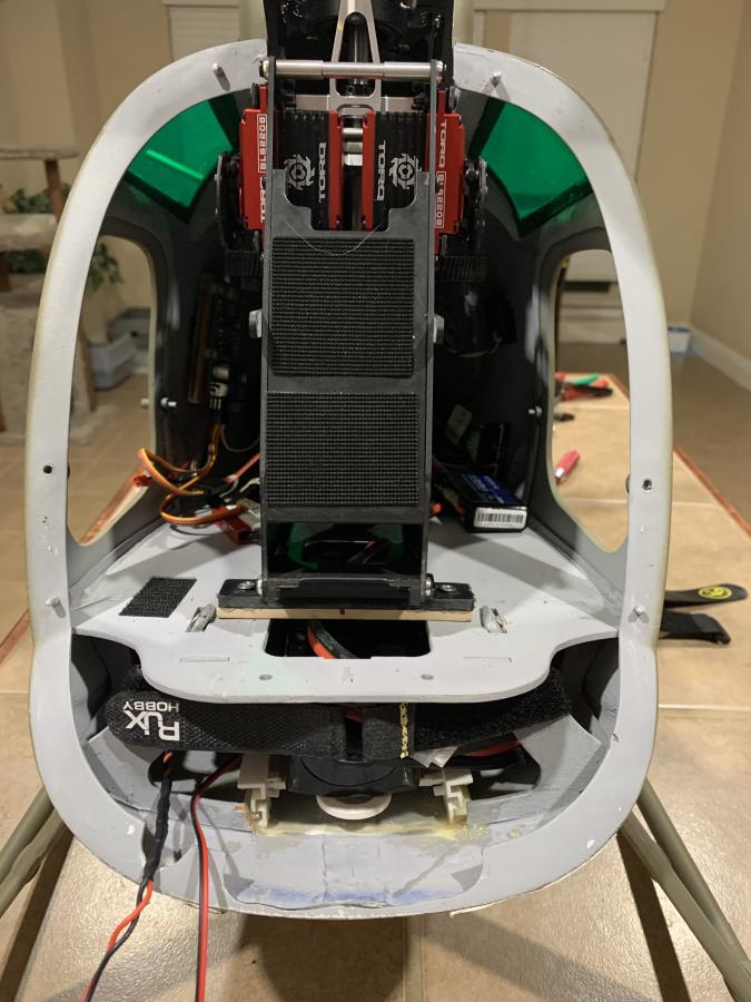

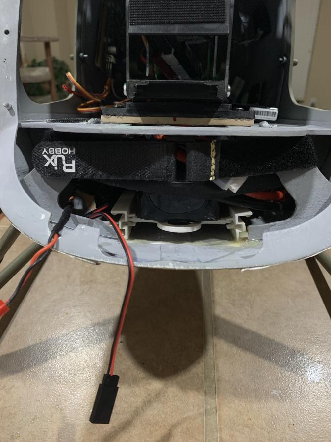

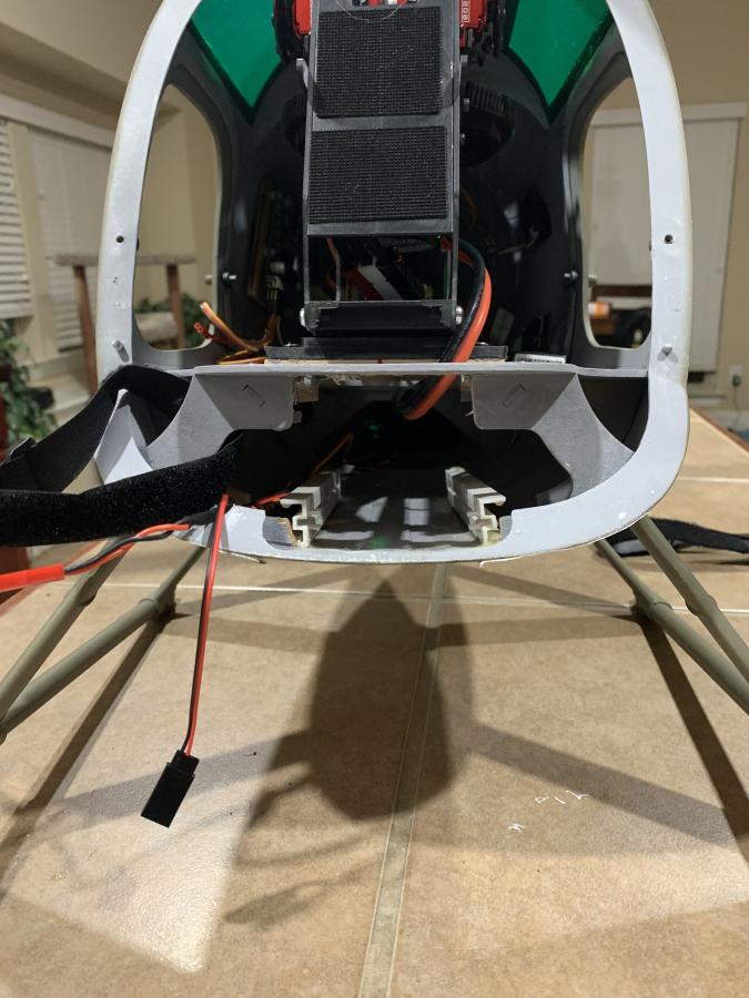

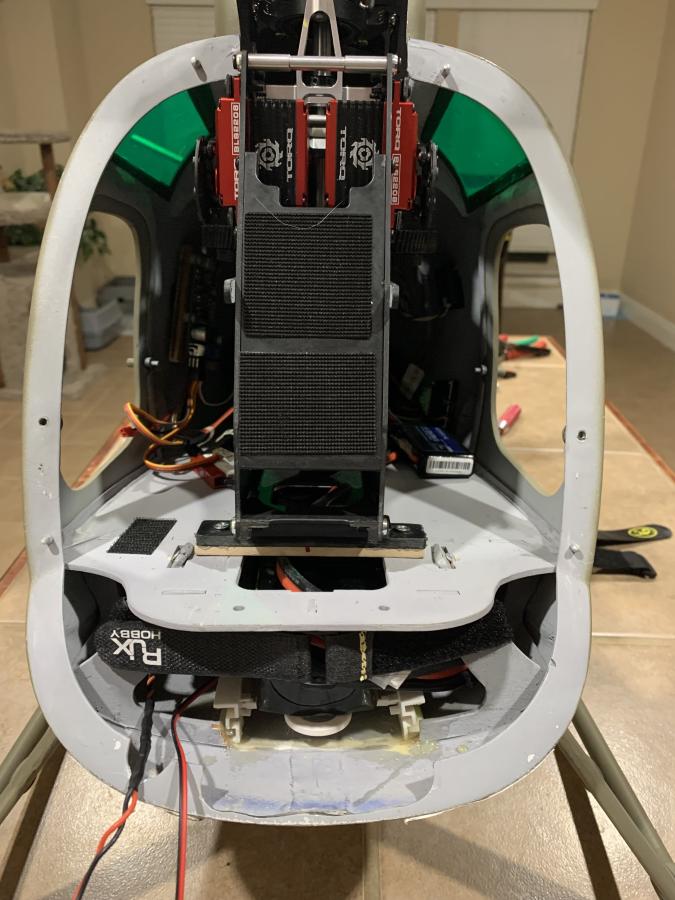

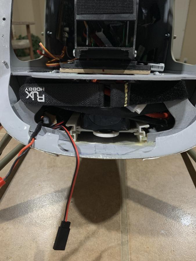

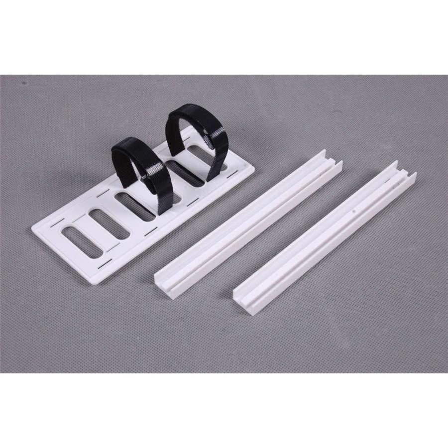

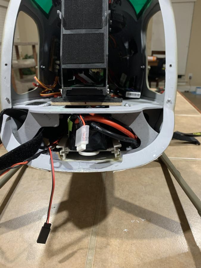

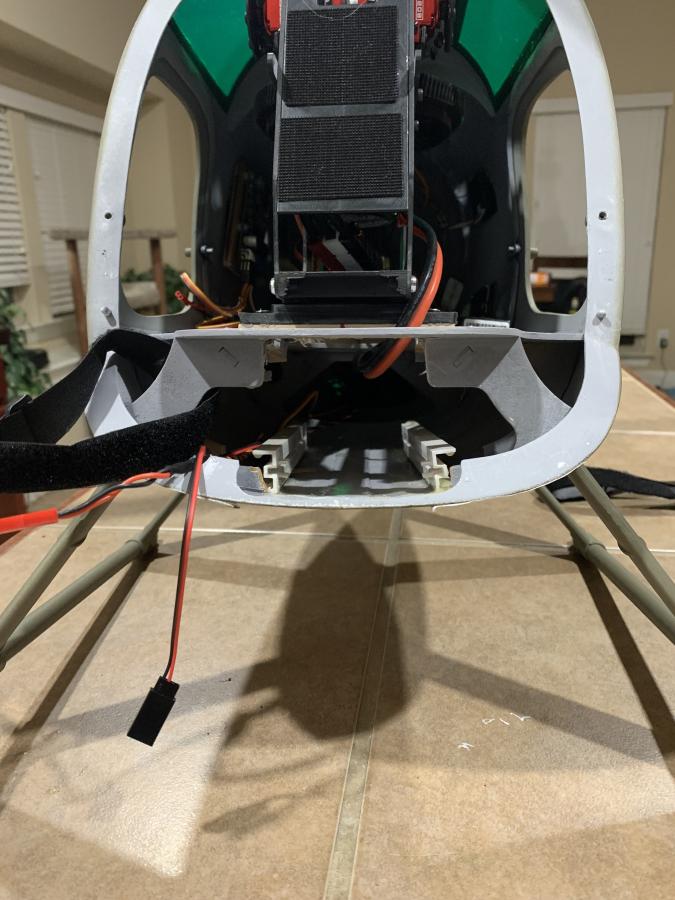

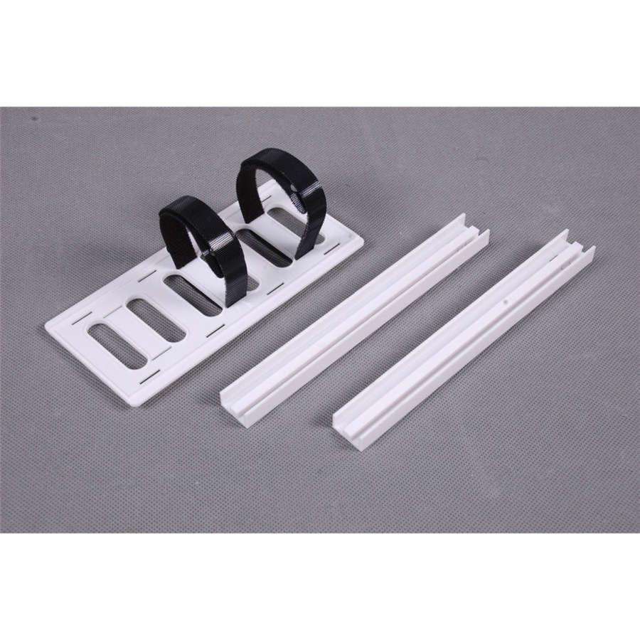

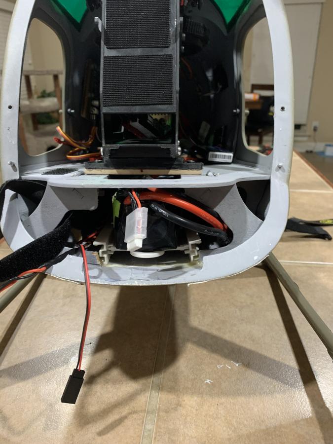

                This was my solution for the battery. I used the FMS 6S battery tray, and put it underneath the mechanics. I added a velcro strap to the front to ensure that it can't slide any where!
ID:	331790Click image for larger version
ID:	331791Click image for larger version
ID:	331792Click image for larger version
ID:	331793Click image for larger version

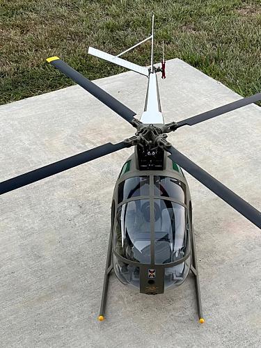

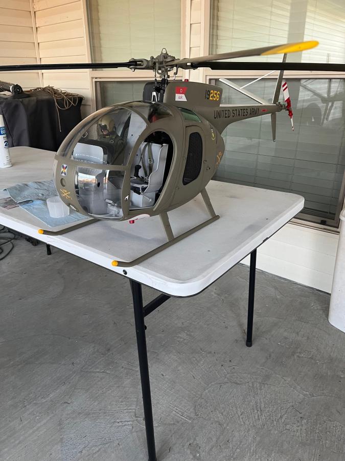

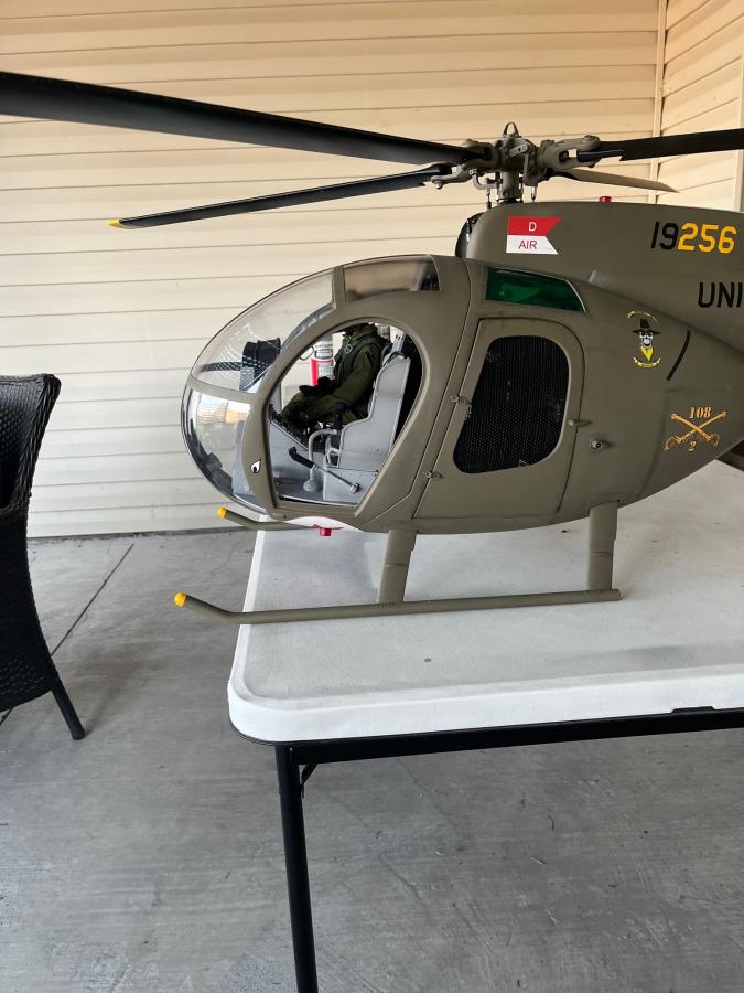

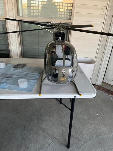

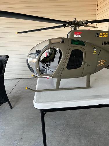

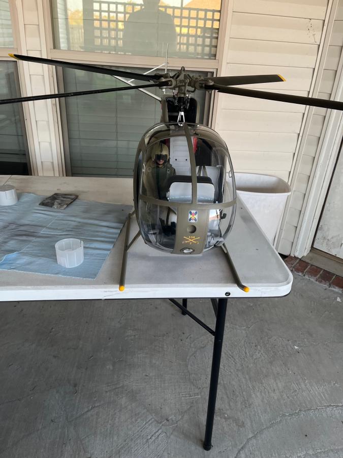

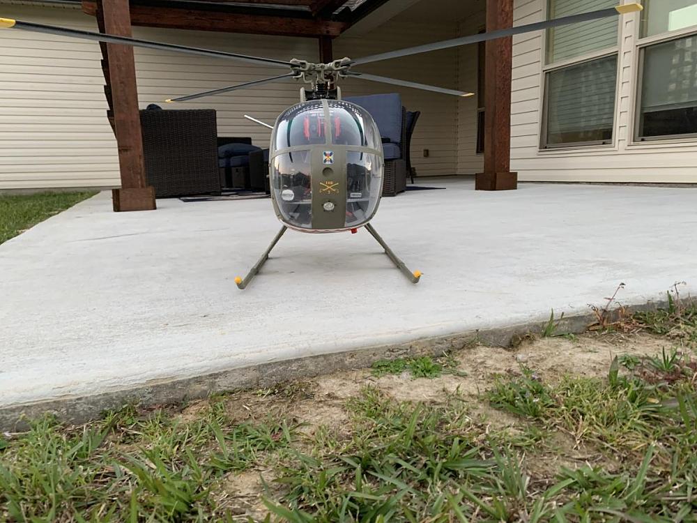

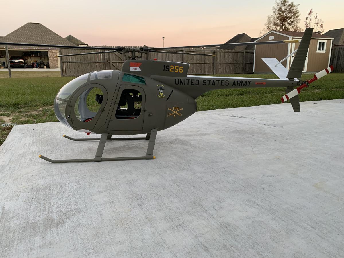

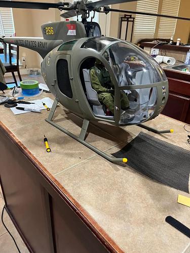

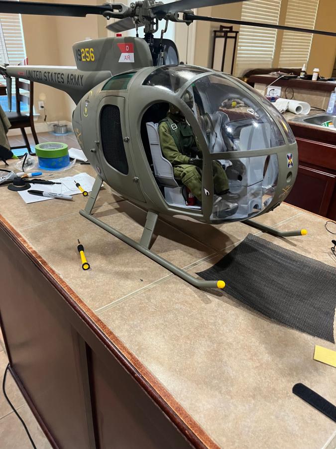

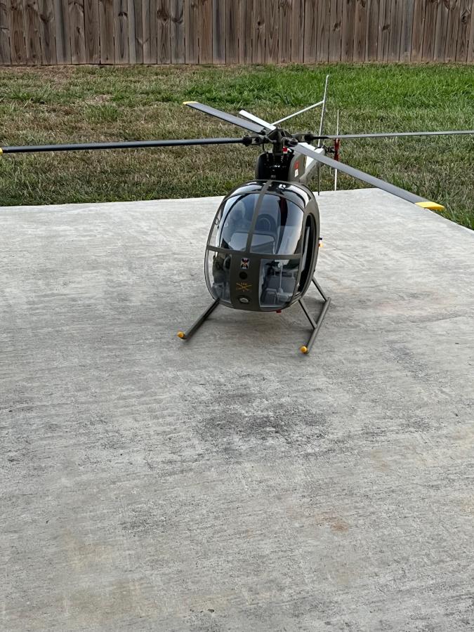

                      Here is some pictures with the cockpit added. Also worked on the skids/leg- got a lil closer to the scale height.
ID:	394090 Click image for larger version
ID:	394091 Click image for larger version
ID:	394088 Click image for larger version

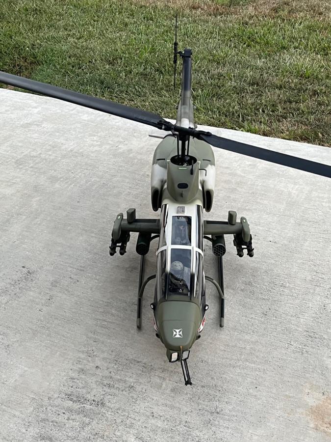

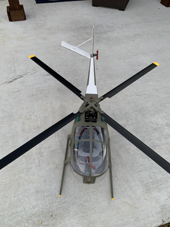

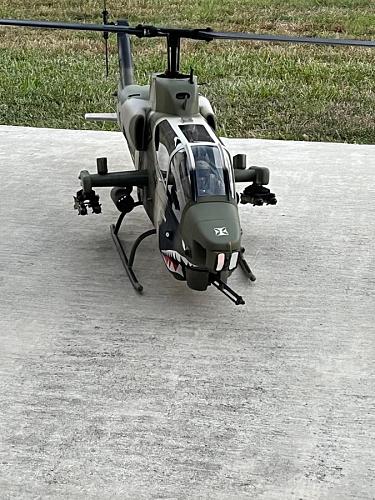

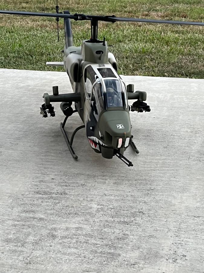

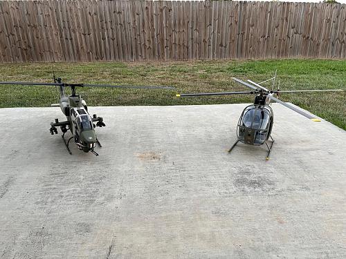

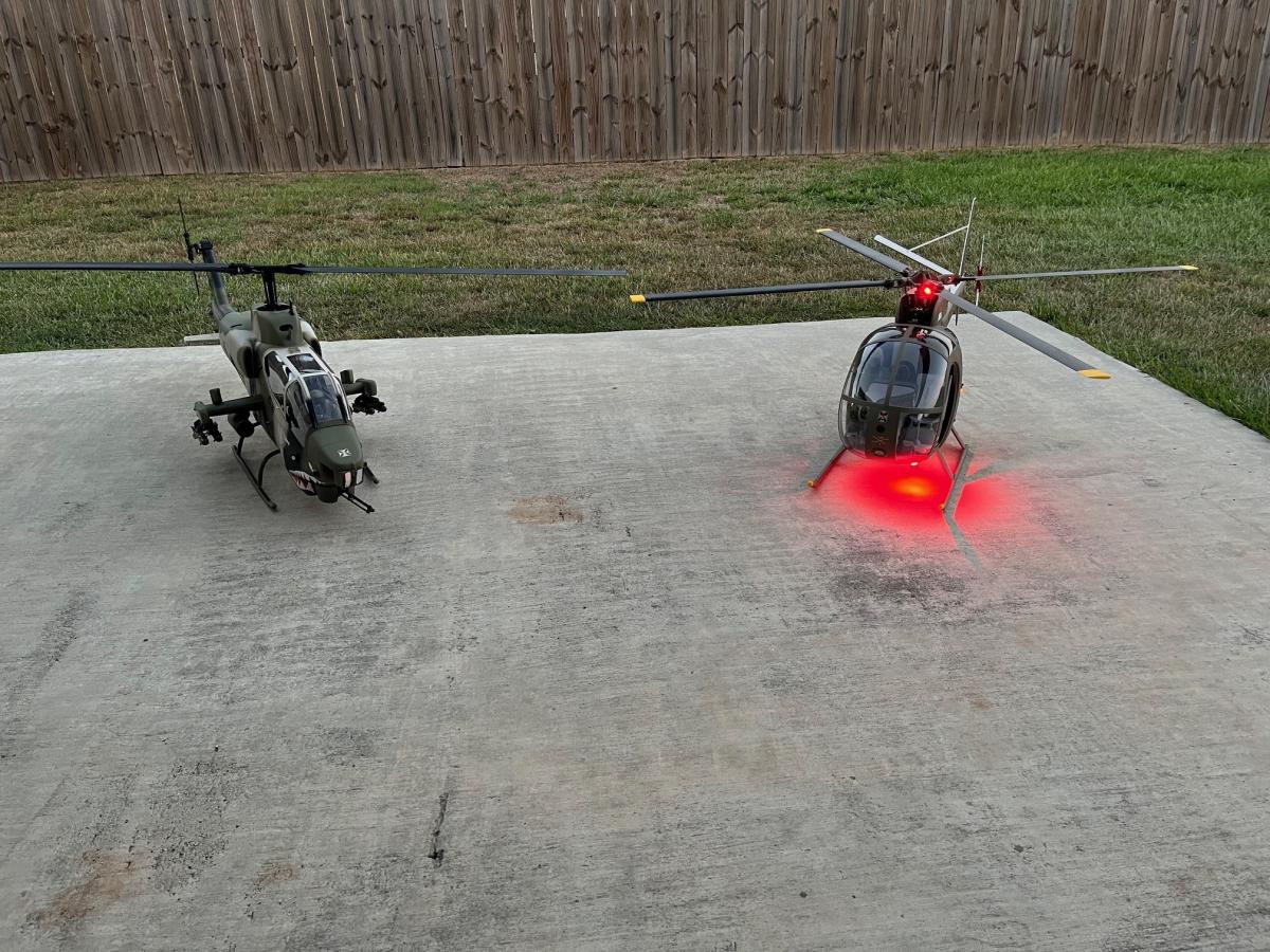

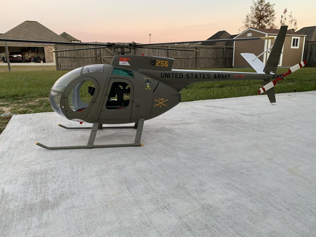

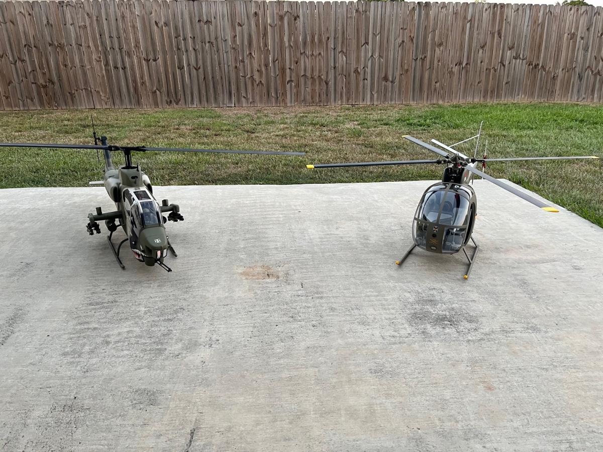

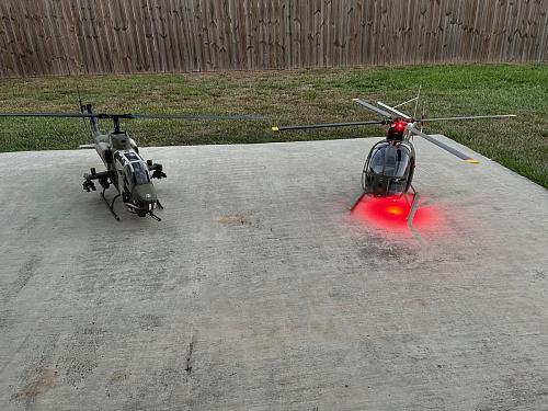

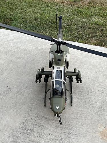

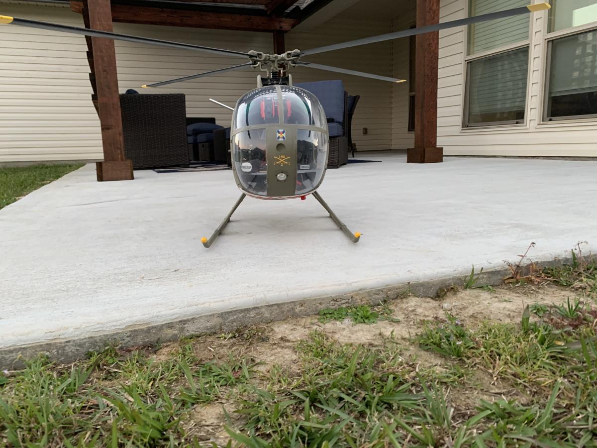

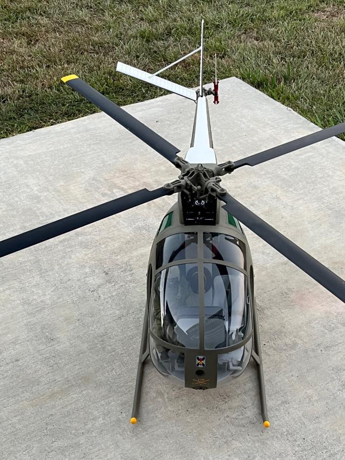

                        Here's my pink team ready to sortie!!
ID:	394093 Click image for larger version
ID:	394094 Click image for larger version
ID:	394095 Click image for larger version
ID:	394096 Click image for larger version
ID:	394097 Click image for larger version

                          Great looking helicopters and reminds me when I was in the US Army during those years flying both the OH-58C and the AH1-G, Q and S model Cobras. Had 2 tours with Cavalry units, 1 tour with a General Support unit and one tour with a Combat Aviation AH-64 Brigade. Hooah!
                          • sfcfury
                            • Mar 2019
                            • 490
                            • Baton Rouge, La
                            Thanks! Yea I got two different era's going on there... Whiskey Cobra and OH6A... Should be a G model Cobra with the loach!! But I'm soooo not a scratch builder lol... I'm barely a slightly modify it builder lol
                            Cobra is by far my most favorite helo overall... and I have an unhealthy love/hate obsession with the MI-24 Hind D. My bucket list/dream rc helo is a heliclassics MI-24... I hope to make it a reality one day lol...

                              The upper OH-6 greenhouse window is tinted. How was that accomplished? Is greenhouse canopy removable to service the aircraft?
                              • sfcfury
                                • Mar 2019
                                • 490
                                • Baton Rouge, La

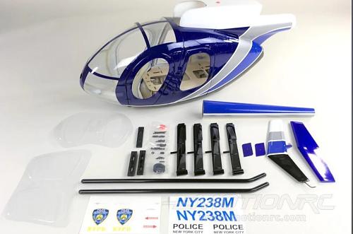

                                So that kit is started it's life a blue and white police version with no skylights. (the pic shows the E model b/c the MRC pics for the D model falsely show skylights-mine didn't come with skylights!)
                                So I cut the skylights in and used green polystyrene sheets from everygreen scale models for the windows. The good thing about the Roban kits is that the doors open- so you can get to what you need to just by opening the doors and/or taking the nose cap off.
