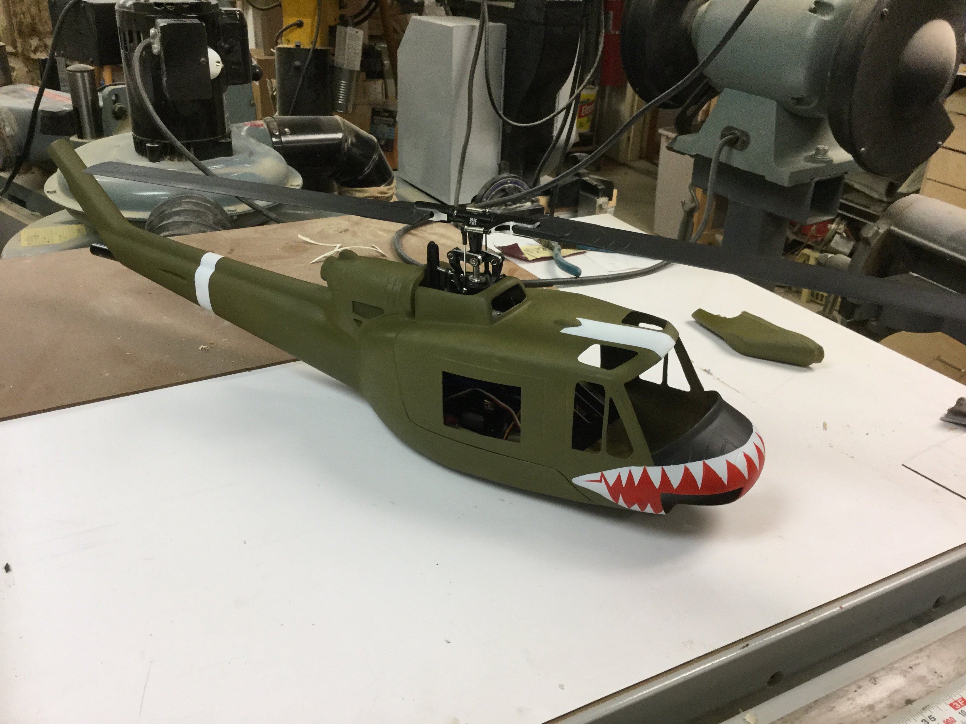

      The first thing which I did was to modify the fuselage. Initially, the windows and canopy were both undersized. Using the Dremel cutoff wheel, I cut them to the correct shape. I lightly sanded over the existing paint and applied 2 coats of tamiya primer. Then, Model Master Olive Drab was airbrushed over the fuselage.

              Thanks Tony and Alpha! Alpha, your wish is granted, I am on Spring break so this will hopefully be finished by Sunday before I have to resume classes. Painted the frame today and finished the biggest painting headache, the shark mouth. Also did a test fit of the mechanics and it is starting to look like a Huey. Hoping to get the skids and raised tail adapter finished tonight, so I can start getting the mechanics ready for test flights.

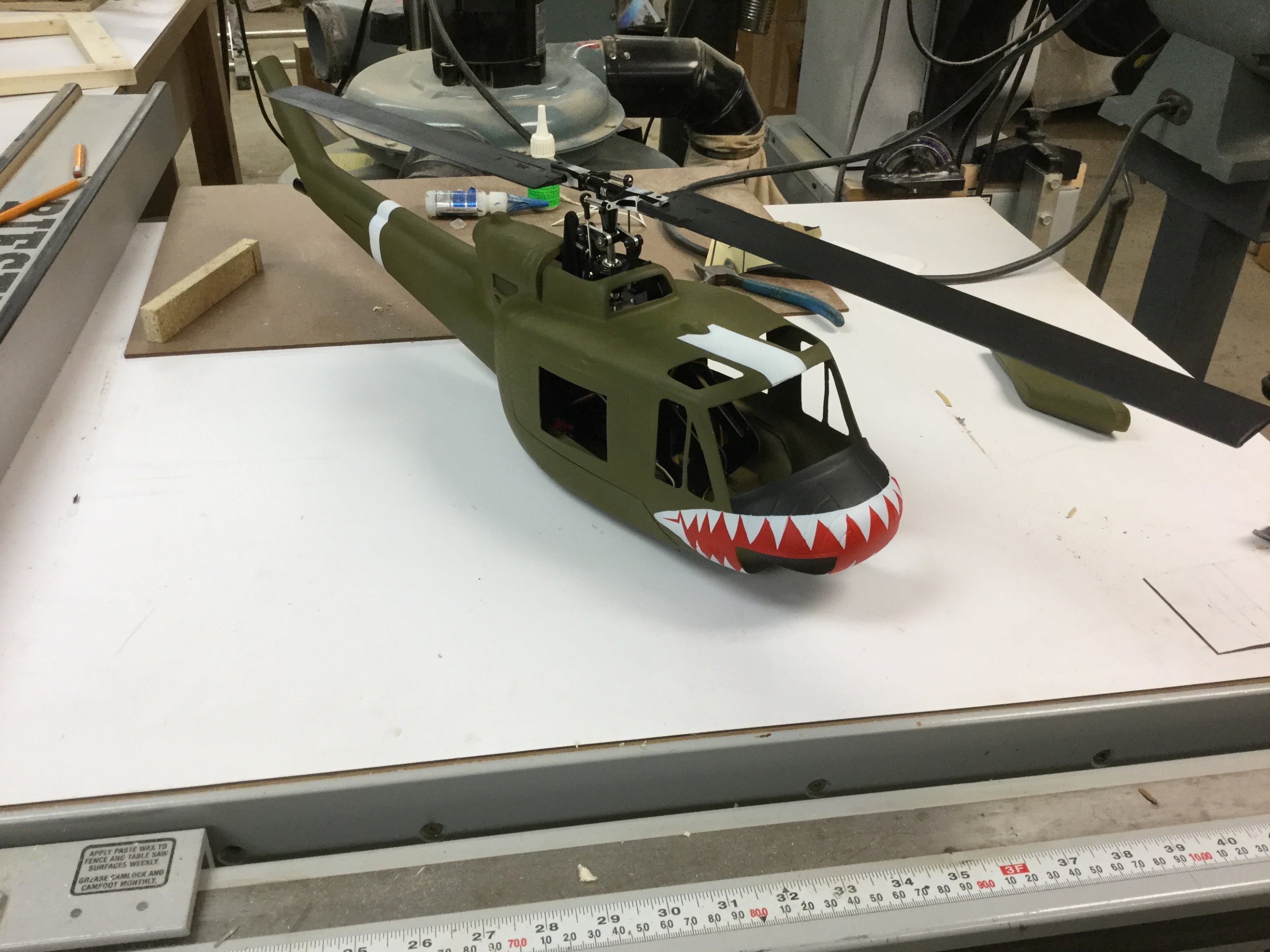

                      Thanks guys! Unfortunately, I did not get much done today as I had to finish up some work. Did manage to get the skids done though. They are brass tubing soldered together. The stock skids looked completely wrong, and were about 4x too tall. Tomorrow I will probably make the windows while I wait for my tail servo to arrive.

                            Added the windshield, chin bubble and greenhouse windows today.Due to the cure time of the epoxy I didn't get to do much else. For the upper greenhouse windows, I wanted to replicate the green tint of the full scale. So, I ran to the store and picked up a green-dyed plastic bottle of ginger ale. After straightening out the plastic, it worked great! Tomorrow I will be adding antennas, wire cutters, and other details, as well as the pilots and copilots windows.

                                    Well, that was pretty much all I could get done over spring break. I did cut the drive shafts to size and installed the tail servo, but have not had time to set up the heli yet. The build will resume mid May after I graduate. Thanks for all the interest and feedback!
