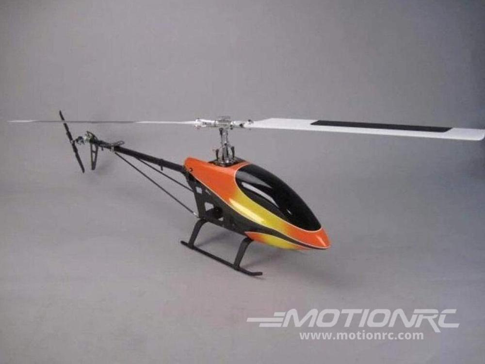

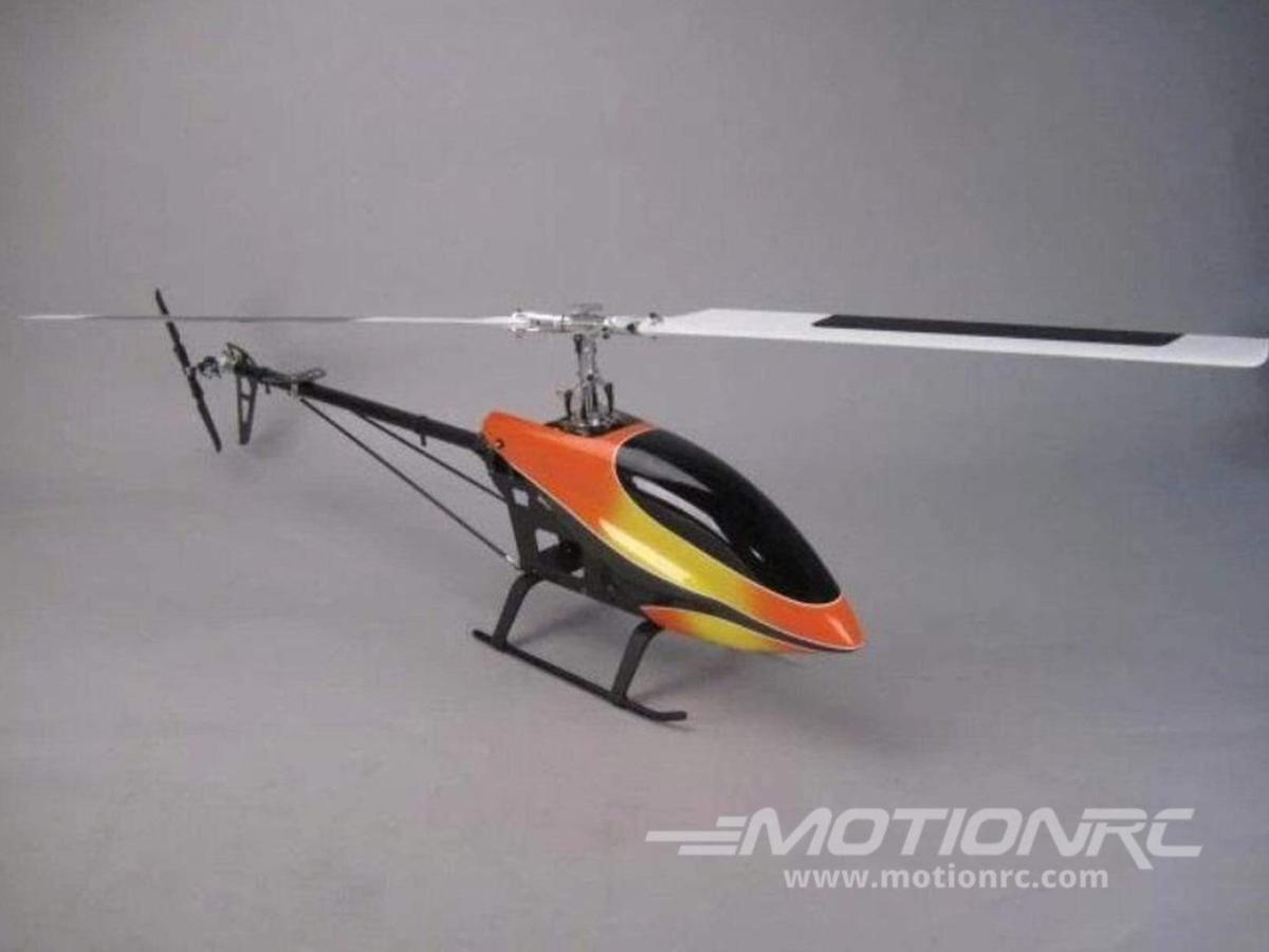

    Note: Canopy shown in the product photo is NOT included
    The Phoenixtech 600ESP helicopter KIT is a popular helicopter that requires pilots to provide their preferred electronics. Assembling in one or two evenings, the Phoenixtech 600ESP features carbon frame plates, aluminum CNC finished parts, and a torque tube driven tail. Carbon main blades are included, in addition to all required bearings and hardware. Stainless steel link balls and control rods, and hardened steel ball bearings are all provided.
    While the 600ESP can be built and flown as a conventional sport RC collective pitch helicopter, it is also an excellent "donor" to install into certain compatible Roban 600 size fiberglass helicopter bodies.
    As an advanced flybarless helicopter requiring assembly and both mechanical and electronic setup, the Phoenixtech 600 ESP is recommended for skilled modelers with extensive previous experience building and operating large RC helicopters.
