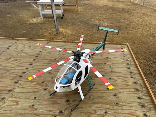

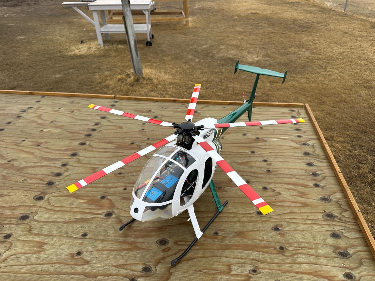

                  Went to fly this morning but when it spooled up, the main rotor was spinning backwards. It shut itself down (good thing). I guess the new ESC has it programmed that way. I'll need to swap a couple of wires but it was too cold to mess with it at the field. Hope to get it fixed and try a re-maiden in a couple days. All I've got for now is a picture. Looks real good anyway.

                    Swapping out the rotor head and ESC was very simple and easy. Did it with the guts still in the heli. Tracking seemed to be just right. The heli flew about the same as it did with the stock 2-blade. To me, it didn't sound much different. When switching to "angle" mode, it dropped a fair bit more than before the swap. Not a big deal, just have to be ready for it. It looks a whole lot better - the way a Hughie 500 should look. It's my favorite heli now. I'm happy with this mod. I think Motion should stock a few of these kits.

                      Looks good, and glad to hear it flew well! Is it also a slightly smaller diameter than the stock blades or is that just an optical illusion?

                        No optical illusion. The diameter of the rotor disc is indeed smaller. I'll take a measurement and post it here.
