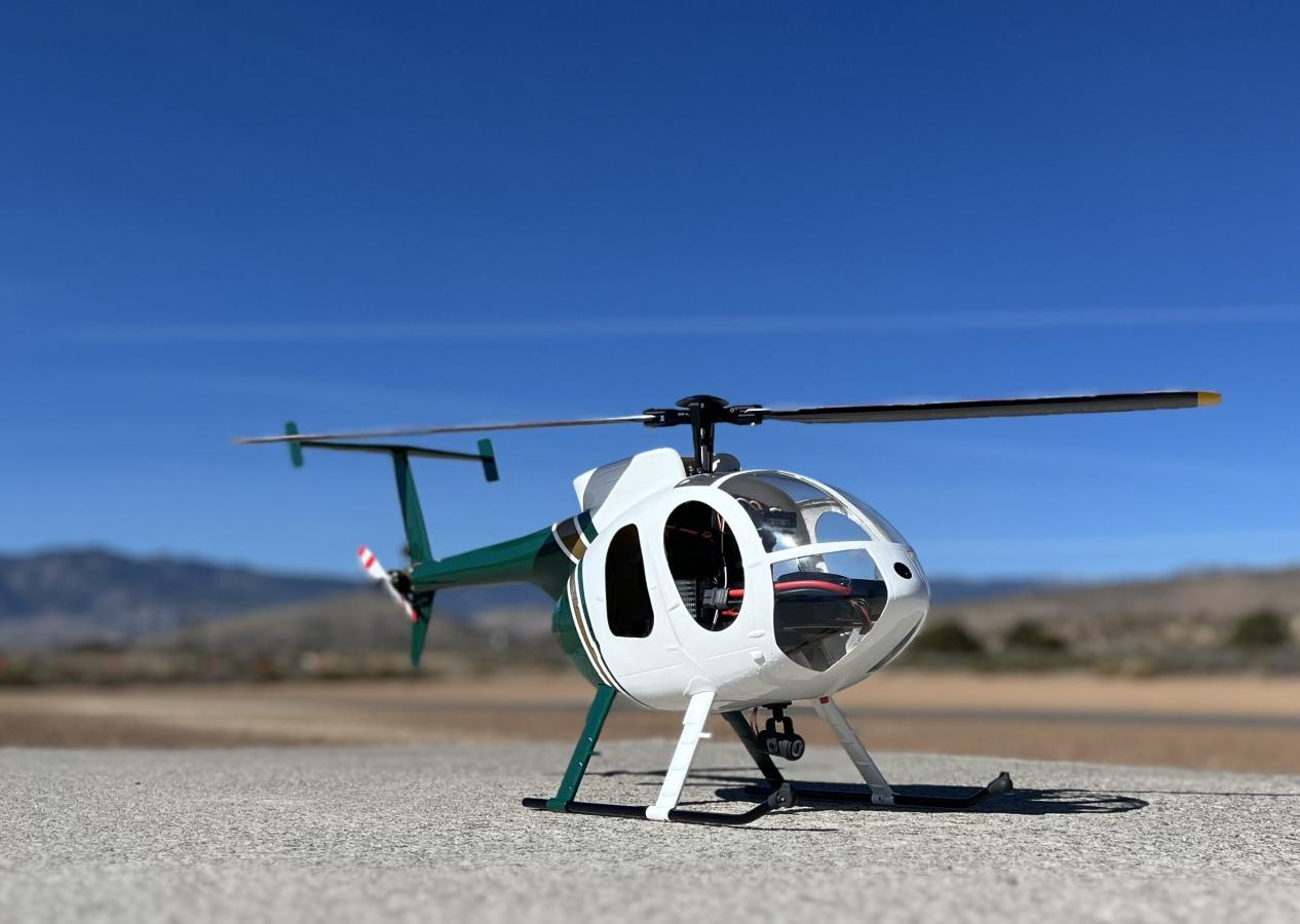

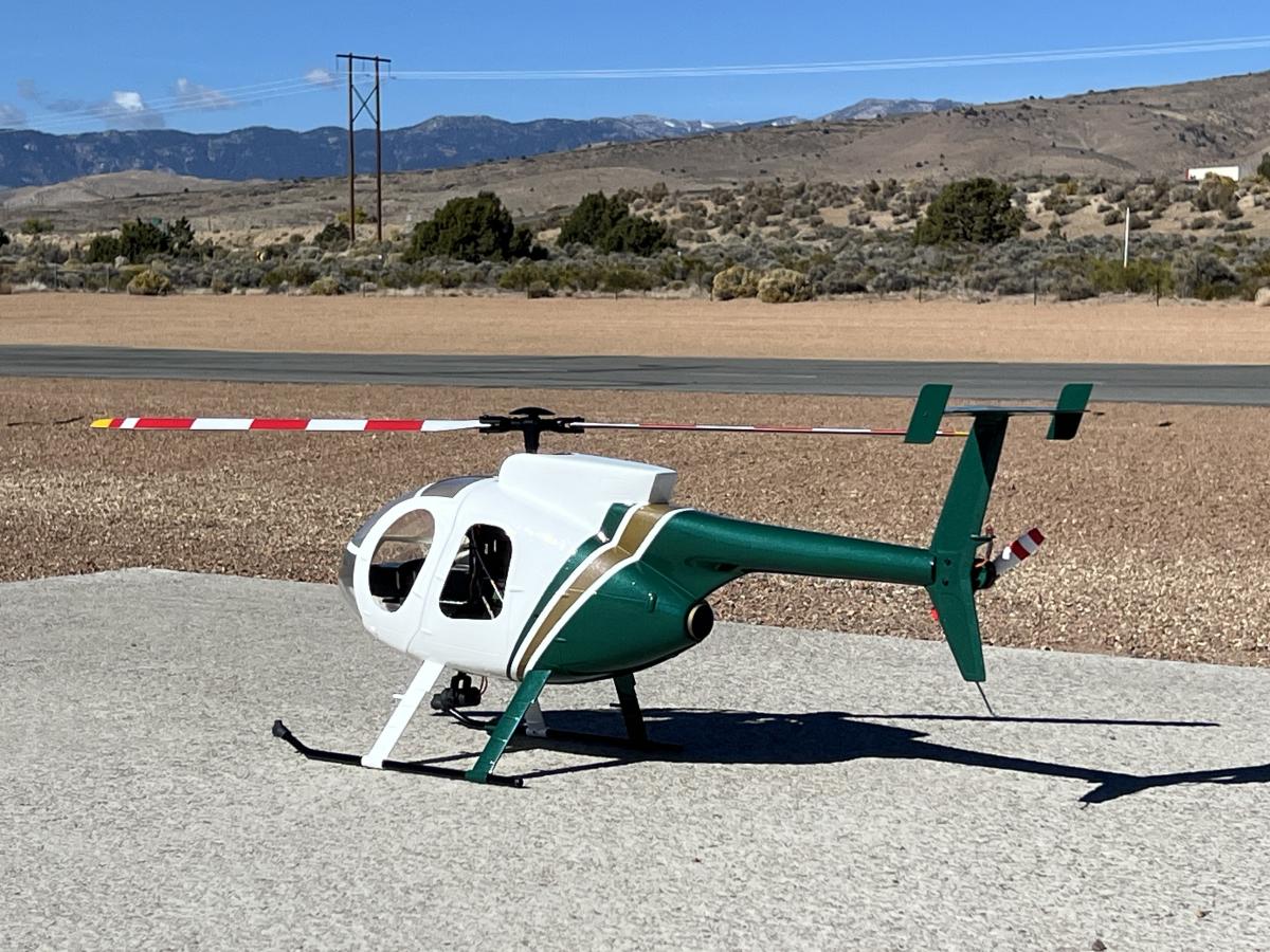

                  I love flying this MD-500 heli. It looks amazing and flies really nicely. If I could change anything it would be to have a constant sped tail rotor for the nose. Let the main rotor do the talking and ditch the drone sound. But.. Big deal… anyhow. Compared to FlyWing, which have nice 450 and 470 arf’s… I think the Roban 470 “Rotor Scale” series is a little bit of a step up.
                  Has anyone else with a Roban MD-500 noticed essentially zero difference between “ATT” and “Manual” modes in the flight control software? Typically “ATT” mode would be expected to have an attitude leveler (like safe mode in a fixed wing trainer setup) and in fact, it does. But.. I sort of figured Manual would have not featured an “attitude leveler” but rather allowed full manual helicopter flights. So far it seems “ATT” and “Manual” behave identically in my setup.
                  In addition to the stock battery pack, the SMC regular volt 5200’s are a nice option that perform very well and are competitively priced. I’ve got about 25 flights on mine now with half being at the flying field and half at my back yard. A few guys have made some scale upgrades to theirs including 3d printed pilots, 4 blade rotors and upgraded light modules with 3w strobes for full daylight dazzle. For me I’m just going with custom graphics and the 3w high light kit and some pilots. I’ll keep the 2 blade rotor for the nice “whoop whoop” sound, lighter weight and to keep the motor cooler with good flight times.
                  I intend to use mission planner software to see if perhaps my X2 is simply set up with the wrong configuration in the settings page, to try to get manual mode (acro) capability. Anyhow… anyone else notice this?
