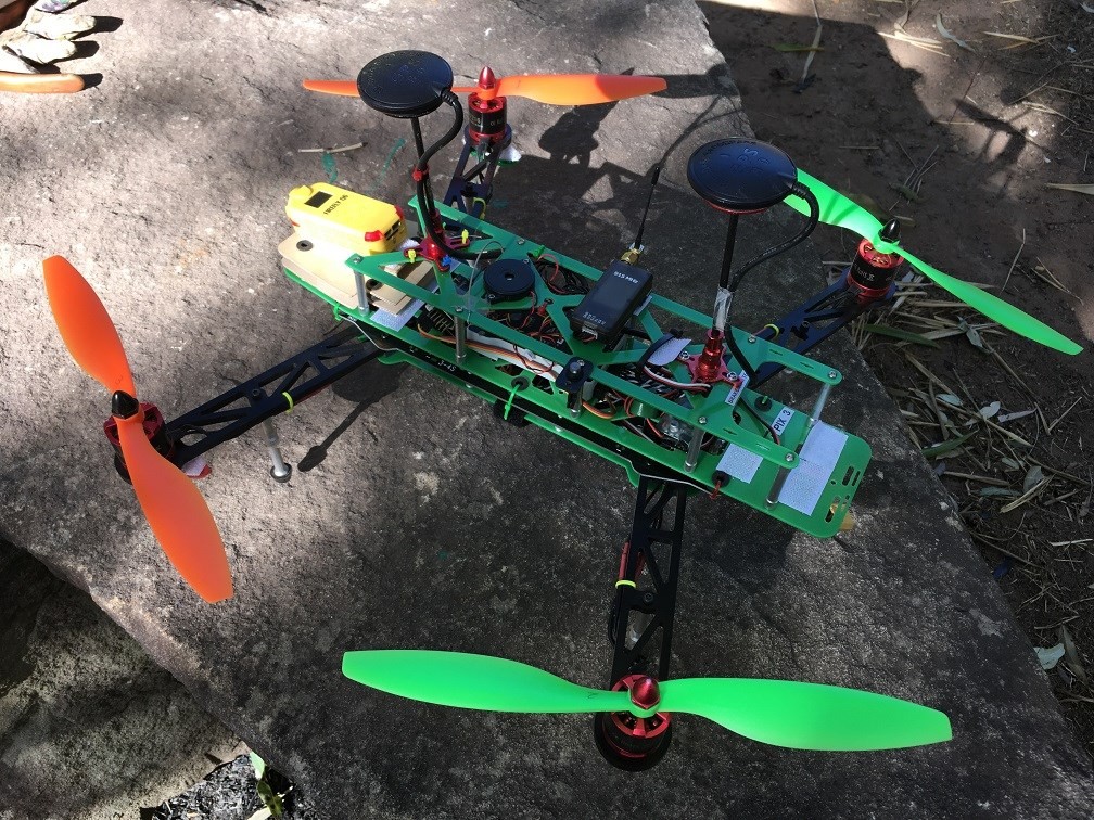

    I took the opportunity to buy 3 of these since the price has been drastically reduced down to $17. 00. (1 for parts)
    They have a lot of features for the money. Built in PDB, front and rear LED lighting, Warning buzzer and more.
    I have been using mine mainly for missions which I really enjoy. These little Quads fly very well even in strong winds.
    I use Emax MT3506-650KV Multi Copter Motors which are fairly large but only draw 5 amps on full throttle with 10" props. (max size on this frame)
    The ESCs are Racerstar 30 Amp (V1) from Banggood.
    Flight Controller is a PX4Pilot. I use a Toshiba Laptop for missions and hopefully a new WiFi system will also let me use a iPad Pro. On missions I fly it at 5 meters per second (18 klm) but it will go a lot faster of course.
    I also have a larger Quad I use for videos but this is my favourite.

    I built another one yesterday/today. It is the same except for different motors, ESCs and GPS.
    It has already flown 7 missions and is performing perfectly.
    I have ordered a Hawkeye Firefly camera for it as they were on special at BG. The Firefly has a built in Gyro so I shouldn't need my gimbal.

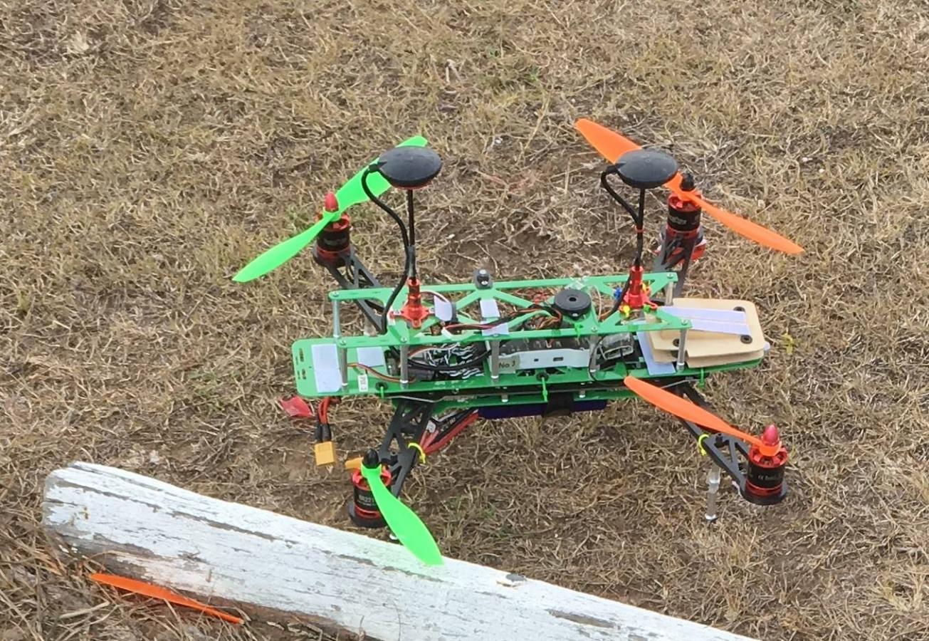

                    Here is a Dart that I tried 2 GPS units on for the heck of it Click image for larger version
