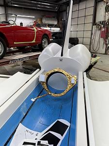

    Been working on many issues, like getting set up on designing a hanging mechanism for this very large and heavy (135 lbs) model. It will be hanging over the heads of probably millions of museum goers over time, so ensuring an extremely reliable system was of the highest order. We got that approved recently, won't drill the hole for the eyebolt until the entire model is together to see where the exact CG is to place the hole. The eyebolt is a Crosby forged piece, in-line hanging strength of 1200 pounds, which is overkill, but I didn't want to leave anything to chance with this model.
    We have completely sanded, patched, and smoothed any imperfections in this 40 year old model. We found many, including some delamination of the fiberglass at the seams in a few spots. Everything went into primer, and then sanded and checked for any small imperfections still needing a bit more work. On Monday, (this is Saturday) we will start spraying the entire model white, and after that work on all the black patterns of the model. Callie made up the graphics for me, although we are thinking we might use some of those vinyl transfers as patterns and paint all the black patterns on. Things like the USA flag, Discovery name, etc., we'll use Callie's transfers when we come to that point.
    I am working on a 1/15 scale model of the Tracking and Data Relay Satellite (TDRS) that was released into space from this STS-26 mission of Discovery in October 1988. This was the "Return to Flight" mission, the first shuttle flown after the Challenger accident over 2 1/2 years previous. It had a simple job to do on this first flight, covering 4 days: Make sure everything operates normally and safely, and release the TDRS satellite into orbit. It had a booster on it that carried the satellite up to a geosynchronous orbit around the Earth at 22,500 miles high.
    I'm very much looking forward to getting this last project completed that I am doing for the NASM. It's been a very busy year!
    I'll attach a pic of the fuselage taken last week in primer, and a photo of the real TDRS launched on that mission. My version will be about 29 inches long in that scale.
    Davegee
    Click image for larger version Name:	0.jpg Views:	4 Size:	114.7 KB ID:	389042 Click image for larger version Name:	shuttle fuselage in primer coat.jpg Views:	4 Size:	181.2 KB ID:	389043

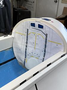

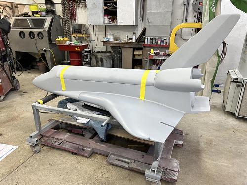

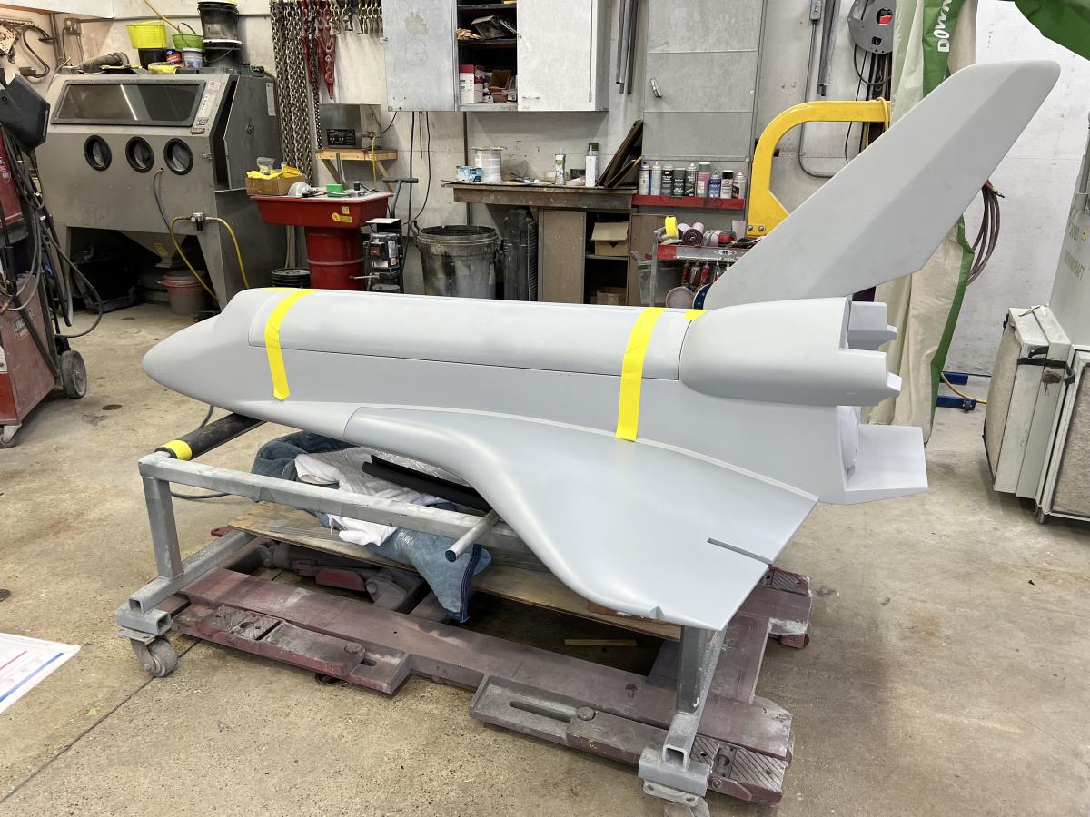

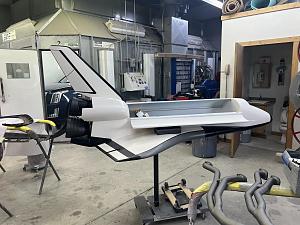

    Today we started painting the shuttle model. We're starting with a coat of white over all the parts, and then will mask off the parts that will be sprayed black, and some grey, namely the wing leading edges and the nosecone. I'll post more pics soon. I'm hoping we can wind this project up in the next several weeks and get it shipped to Washington, DC. It will remain in strorage in its crate until sometime next year when they are ready to install it in the new gallery.
    I'll attach a pic at the auto body sho p today where we have been doing most of the work on the model since we got it last May. It is 8 feet long, wingspan of 4 feet, and weighs about 135 pounds. Been quite a project! Looking forward to getting it painted and completed, for sure!

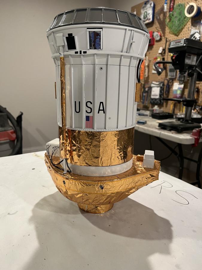

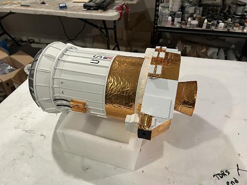

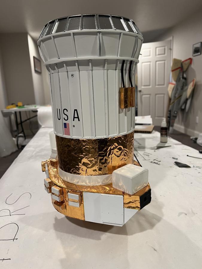

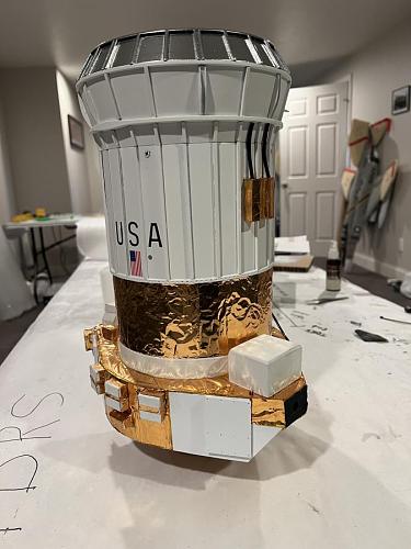

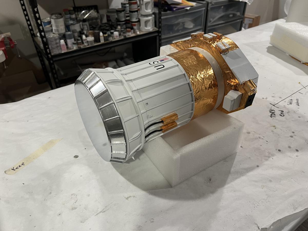

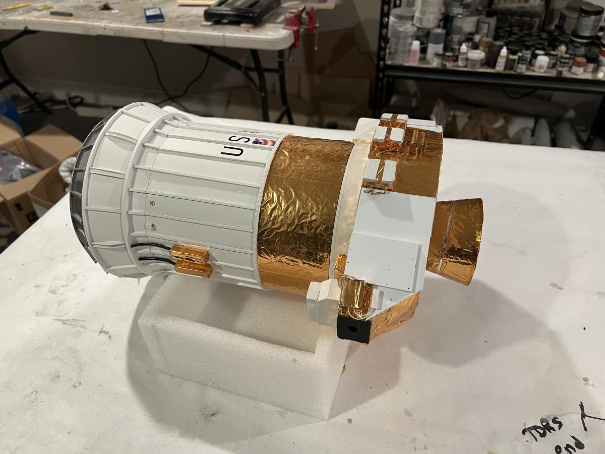

          Been making some progress on the 1/15 scale TDRS satellite and its booster, called an IUS, or Inertial Upper Stage. I am hoping to wind this project up completely by the end of the year, if at all possible. Painting continues on the shuttle, and I look forward to dropping over to the shop to see how it is looking now. Several areas should be painted black now, and then the final detail black areas around the nose will have to be masked off and painted. A seamstress here in Cody who normally sews wedding dresses consented to being contracted to make scale looking thermal blankets for the entire cargo bay. Those will be one of the last things to add to the model before we finish it.
          Regarding the TDRS/IUS,that's coming along. In the previous post, I put up a photo taken of TDRS/IUS just after it was released into orbit by Discovery in 1998. They let it drift off about 100 miles or so from the shuttle, and then ground controllers ignited the two-stage solid rocket motors that propelled it up to a geosynchronous orbit 22,000 miles above the Earth.
          I'll attach several pics from earlier today. The top half of the model where the solar panels and antennas sticking out the top is still being designed and built by colleagues in Denver and Phoenix. When all is done, we'll need to test out how it sits in the shuttle in aluminum brackets one of the guys at the shop designed and fabricated. The curators at the NASM want the model to be angled up 30 degrees from the lie-flat position it was in for liftoff until orbit. This was the "checkout" position where they tested all the TDRS systems. Then they further raised it up on its turntable mount to 58 degrees, and released it into space with the assistance of some springs.
          There was almost no information to go from for making this model. Mostly pictures from space, and one small design drawing I found online from several years ago. In this scale, once the TDRS is mounted on top of the silver transition section in the photos, it will be just over 29 inches long, but will only weigh about 4 pounds or so. I've been trying to keep the weight as low as possible for this display. The shuttle will be upside down with the payload bay doors open, and the TDRS ready to be released into space for this display. I've done totally scratchbuilt projects since I was a kid, but this one has been a challenge. Still, I think it will come out looking good on display with shuttle.
          Click image for larger version  Name:	IMG_1390.jpg Views:	0 Size:	115.1 KB ID:	391159 Click image for larger version  Name:	IMG_1389.jpg Views:	0 Size:	116.7 KB ID:	391160 Click image for larger version  Name:	IMG_1387.jpg Views:	0 Size:	71.4 KB ID:	391161 Click image for larger version  Name:	IMG_1386.jpg Views:	0 Size:	77.9 KB ID:	391162

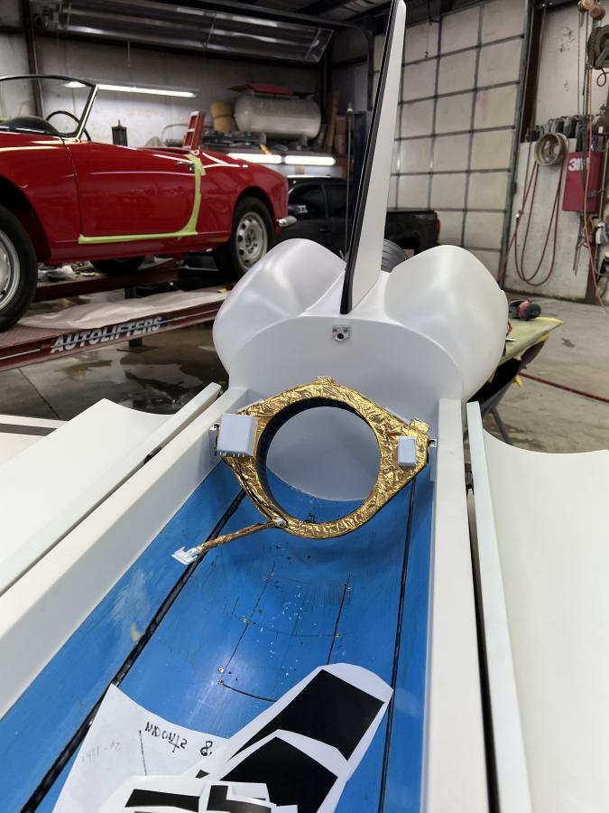

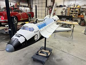

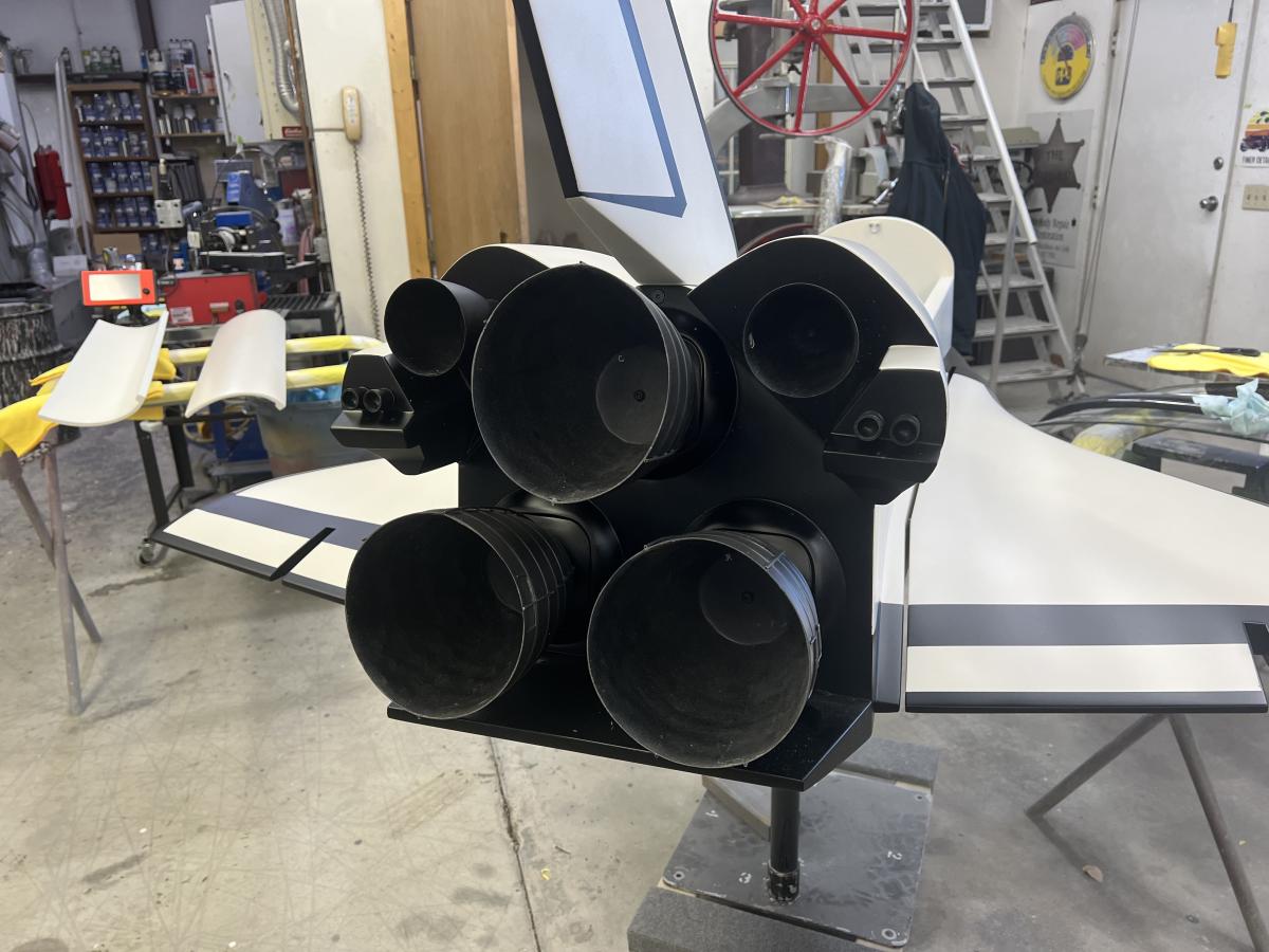

                Here's a few update photos of the shuttle project. It is getting closer to being completed, still many minor but important things to add like the thermal blankets that will line the interior of the cargo bay which is now blue. On one pic you can see the tilt table with the round hole in it near the rear of the cargo bay. The satellite has been removed to put the mounting mechanism in for the tilt table. The TDRS satellite and booster will be installed again after all the interior details are completed. The tilt table is positioned in a 30 degree up from the lie flat position it was in for launch into orbit. This is the position we will use for display. The shuttle will be upside down suspended from the ceiling about 12 feet above the gallery floor. The cargo bay doors will be locked fully open and the 29 inch long satellite will protrude out of the cargo bay at that 30 degree angle.
                This was the "checkout" position where they tested all the connections and electronics before raising the tilt table to the 58 degree up position for release into orbit from shuttle. They used some springs to gently push the satellite away and it maneuvered away from the shuttle about 100 miles or so. At the right time, the two-stage solid propellant booster would push the TDRS up to an eventual geosynchronous orbit of about 22,000 miles above the Earth.
                These satellites worked very well and they are still using newer and more advanced ones for communications enhancement for spacecraft zipping around the globe at 17,500 mph!
                Here's a few shots taken in the past few days. I am hoping we will wind this project up in the next few weeks and ship it back to Washington, DC when we get final approval by the staff at the NASM to do so. I am still working on completing the TDRS satellite with some colleagues in Denver and Phoenix, as the decision from NASM as to which satellite they wanted in the shuttle for display came relatively late in the game.

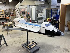

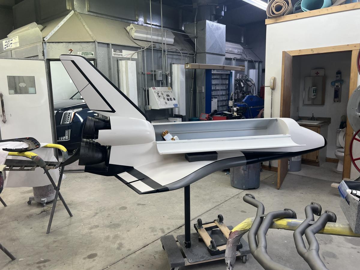

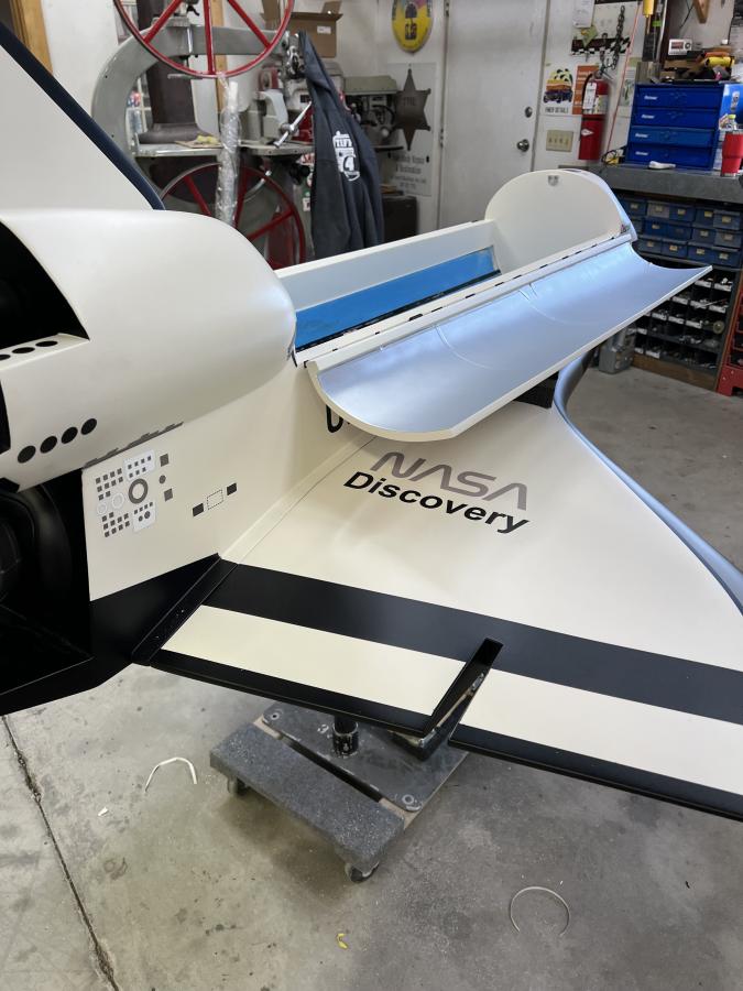

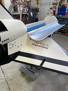

                                          We're making steady progress on completing the shuttle. Still some work to do to finish it, but I'm hoping that we have it pretty much done this week. The TDRS satellite won't be complete yet, but we'll put the lower portion of it that is complete in place in its tilt table mounting stand. We have to have everything more or less finished before we take the final photos of it to send to the NASM for them to give us a yea/nay on permission to ship it to Washington. Obviously, after working on this thing since last May, we're hoping they give us a thumbs up to send it, and that part will be done, at least!
                                          Once it is on its way, it will be placed in storage in Washington for close to a year before the new gallery is ready to install it in 2025 in its position hanging upside down from the ceiling with the shuttle bay doors open and showing the TDRS satellite as it would have looked shortly prior to releasing it into space. The TDRS satellite when it is completed in a month or so will be mounted inside the aft part of the cargo bay, pointed up 30 degrees from level. Total completed length of the satellite is about 29 inches, but we are keeping it as light as possible, about 3-4 pounds or so, completed.
                                          The attached photos are all "in-progress" shots taken recently. Things are not totally in place yet like the scale looking thermal blankets that go in the cargo bay that were just placed there for a test fitting before we put them into place permanently. Will send more shots as we try getting wrapped up with this project!
                                          Happy New Year, everybody! And Happy Birthday to my dad, who would have been 106 on this day, unfortunately, he only lived to 38.
                                          Cheers
                                          Davegee
