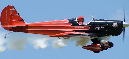

      And a new paintjob to something like this!

        Now that's a nice looking Spacewalker. Plenty of attitude.

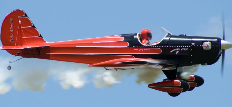

          Hey that's the smoke I'm needing.
