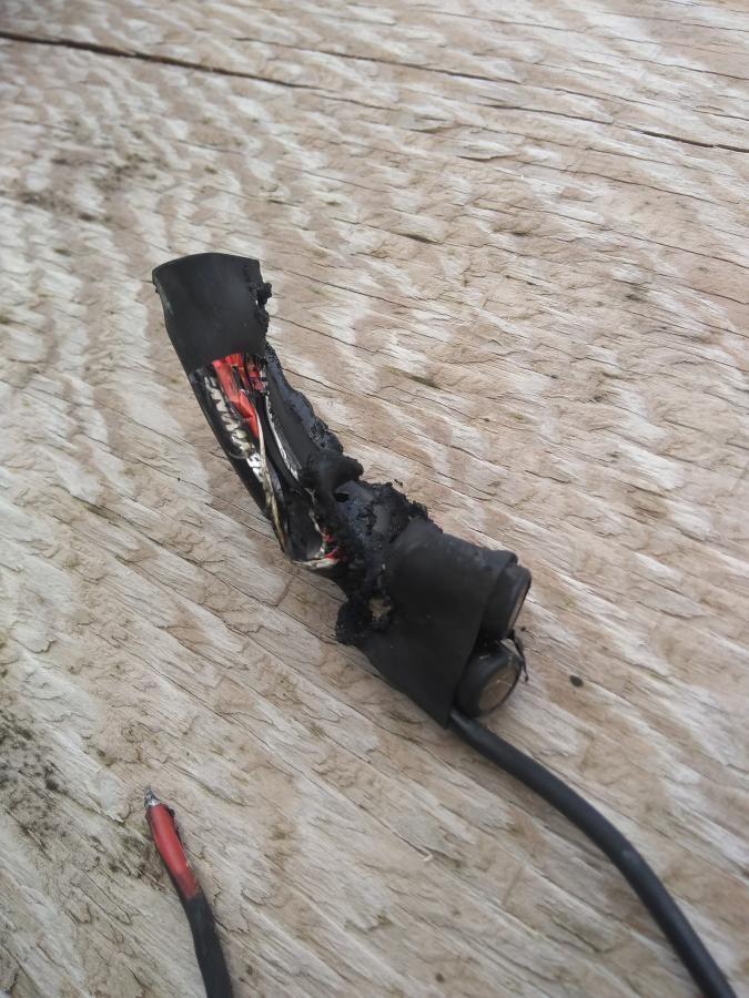

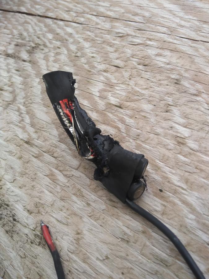

                    How do you tell if your ESC is blown? If it looks similar to this....it's blown! Click image for larger version
