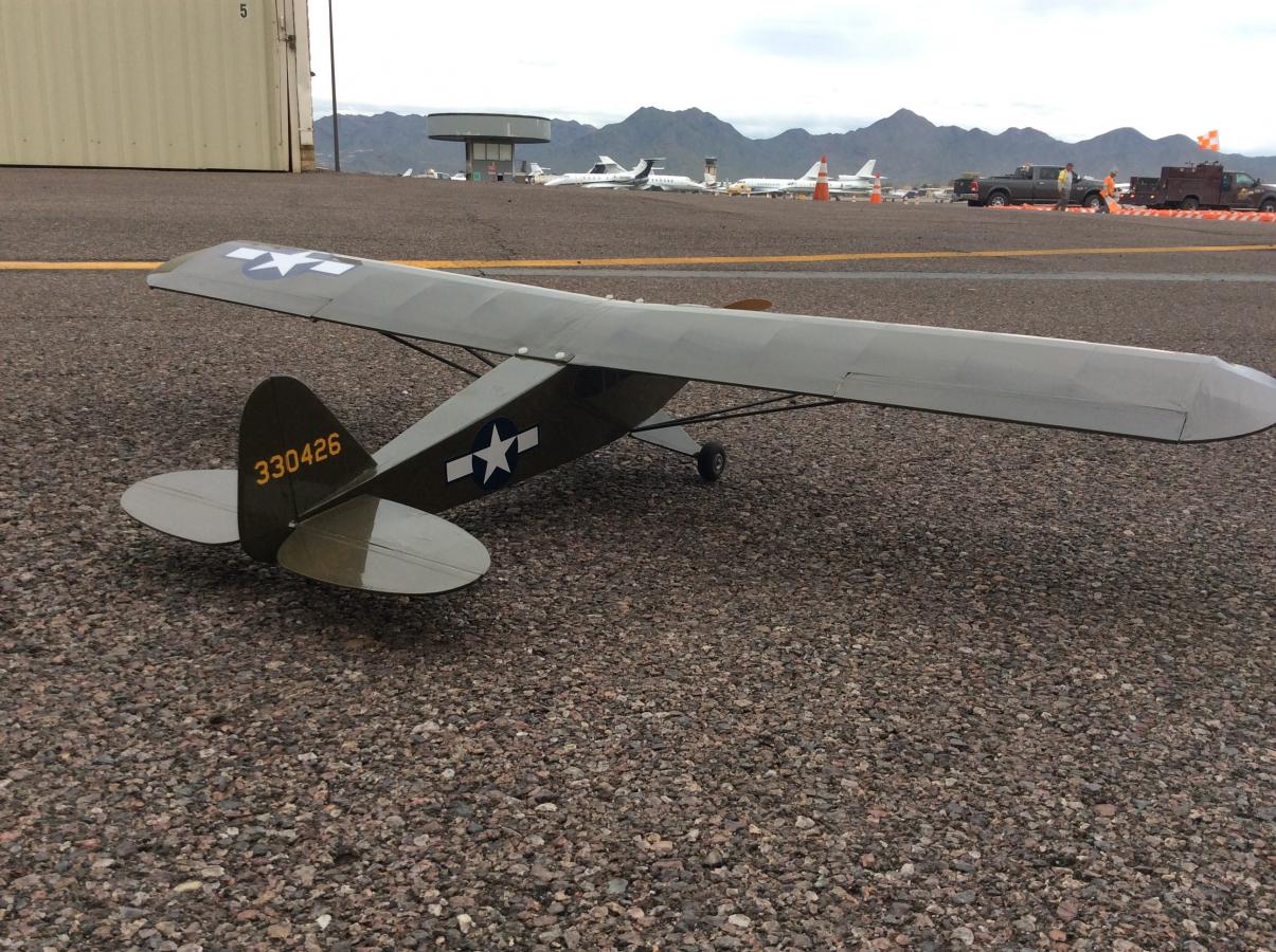

                                    #37
                                    Originally posted by 13dyna
                                    Hey all can I use the dxe transmitter that I got with a carbon cub s on the RX600SP?
                                    It will work...but I wound up buying a DX6 to program the switch. I don’t think I was able to get the switch program on the DXe, despite trying several workarounds and the using the program app on an iPad.
                                    I have never used the recovery mode at all, only the stabilization- and only occasional with that. While it is in a Cub and the same size as the S+, it weighs half what the foam plane does. Had to dial the rates way back to about 25%.
