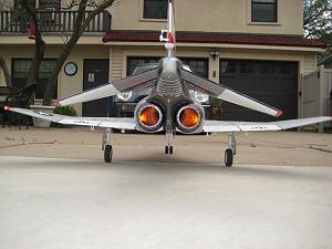

                    Hugh, Keep killin' me. I airbrushed 'Burnt Iron' in my Phantom. I tested the Aluminum Foil-look and even a Flat Gold Foil and opted for the paint. Not as 'Go Fast' as the Aluminum Duct Tape, though 'it'll do'. To each their own as my Gran-pappy used to say. Best, Steve

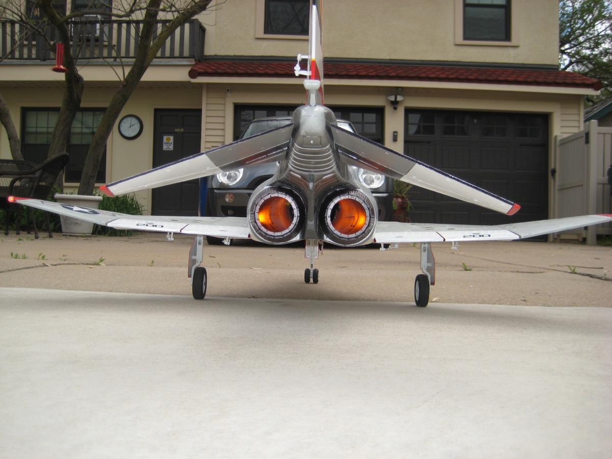

                                I just finished installing the RC Geek afterburners in both my F-4's and my F-16. I now have them in all five of my jets, even though the Avanti and Stinger 90 shouldn't really have them, but man are they cool looking.
                                These are such nice pieces of equipment, I'd recommend them to anybody, easy to install and with the aluminum foil tape, incredibly bright even in sunlight. The only challenging part is lining the exhaust tube with the tape. I took JC Jet Dude's advice and used the dowel sticks, thanks for that great advice. After cutting a piece the correct length, it helps to curl it in the circular fashion as the tube, even more of a curl while installing. I then attach the foil to a 1/4 inch dowel with a small piece of painters tape at the end going in first, while holding the back up against the stick. Then you can place it in the correct position and press down the center line with the dowel, rolling it sideways to stick down the rest and the painters tape comes right off. Then I use a 3/8 or 1/2 inch dowel to smooth it down all over, with the end of the dowel which is rounded to burnish it down, just like RC Jet Dude said. Man, this guy's got some serious grey matter.
                                The F-16 already had a factory installed ring, but I decided to add the RC Geek afterburner as well, the more fire the better!:boom: The ring AB is red and the RC Geek AB is much brighter and yellow, so when both are on, it kind of gives it a burnt orange hue. Mikey likes it!
