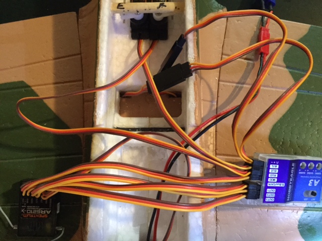

                        If you could send me a picture of how you have things set up, I am almost certain I can help you. All I need to see is how you have the leads connected to the A3L, especially how you have the rudder, elevator and ailerons connected to the gyro. This would be OUTS 1, 2, and 3 as shown on page 1 of the manual. This is the key to the whole setup. The red light will blink if this is setup wrong.

                          Here is a photo of setup Thanks for looking

                            You have it set up wrong from what I can tell. Out puts 1, 2, and 3 are connected directly to the servos and not to the receiver. Connect the servo rudder wire to output 3; take the elevator servo wire and connect to out 2,and take the aileron servo wire and connect to output 1. These are the wires that comes directly form the servos. You have these wires connected to the receiver. This way your gyro will not work.

                              OMG. What a dumb S#%T I am embarassed!
                              Thank you Pheonix.
