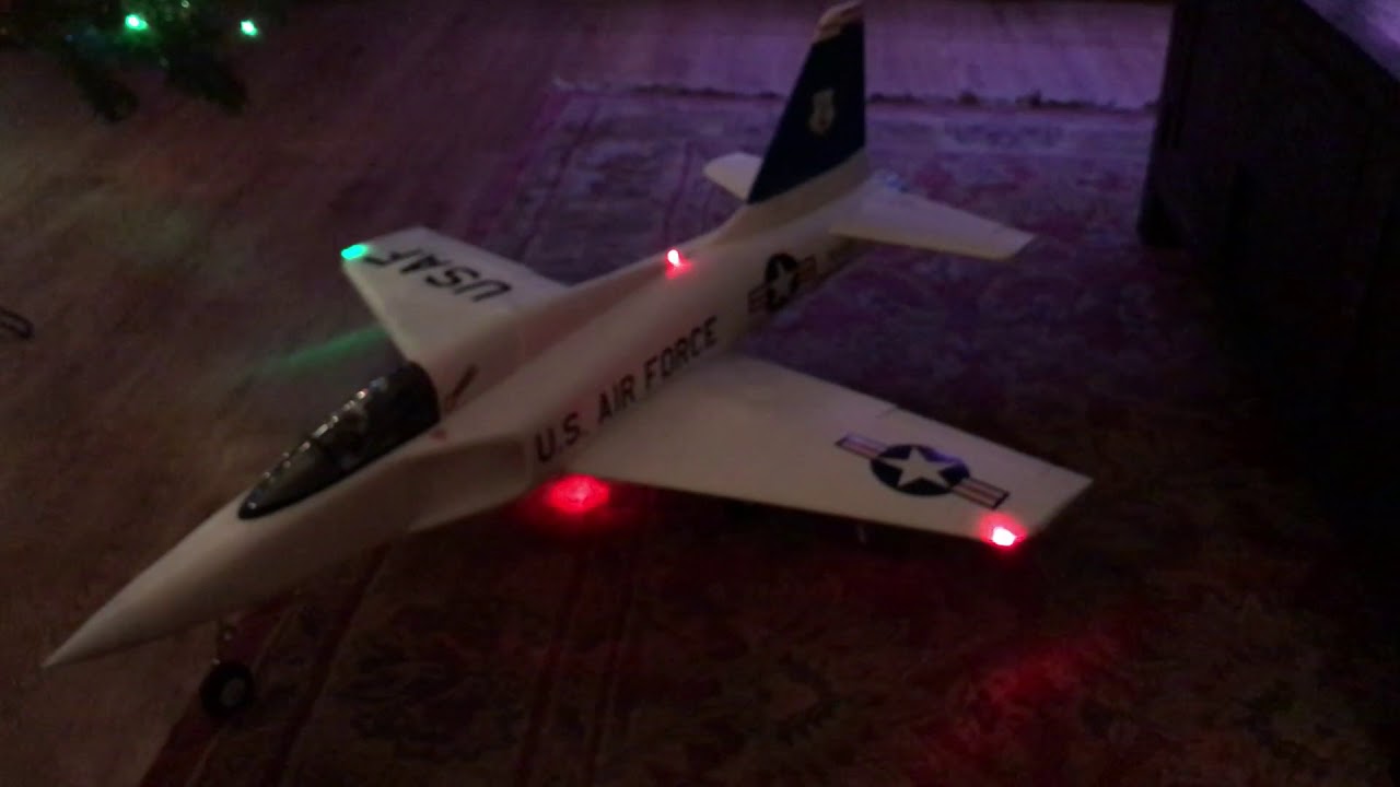

With a little planning it's quite easy and adds a lot to the model.Originally posted by CVA59 View PostCan you guys please tell me the best way to install the wingtip lights? Should I use my soldering iron and make a slot on the underside of the wing to lay the wires in? I'm new to the EDF foam plane scene.
Ideally, and if you can use the same channels already cut for flap and aileron, you'll save yourself a lot of work. When there are no channels, look for handy panel lines to disguise your wiring. I would also recommend kit bashing parts for lights and lenses. The Blue Box, (also a handy spare part if you need it) has all the you need for strobes or landing lights.etc.
For example, I added wingtip navigation lights on my Freezing T33
The lights came from the L39 spare parts, as did the plastic lens covers. Other planes I've modified have used parts from the A10 and other models from several manufacturers. The point is if someone has done it already, don't try to reinvent the wheel.
Basically I carefully routed and cut out the foam for the lens on the the wingtip tank, then soldered up the LEDs to extensions and inserted all into the wingtip tank so that the wires came out where the tank meets the wing mount. Foamtac or canopy glue secures the lens in place.
Then, I used a drill to bore through the plastic end cap where the wing tanks attach. I then cut a small square of foam out of the wing at the end of a panel line. I saved the cutout to plug the hole later. Then using a sharp xacto or thin razor saw cut a shallow cut following the panel line until it met with the trench already in place for the ailerons. I then routed the wire from the tank through the bore hole and up outside of the wing at the square hole and pressed it into the cut along the panel line and into the preexisting wire channel. When everything was in place, I glued the plug back in, and it was done.
A little paint, weathering and you cannot tell it is there.

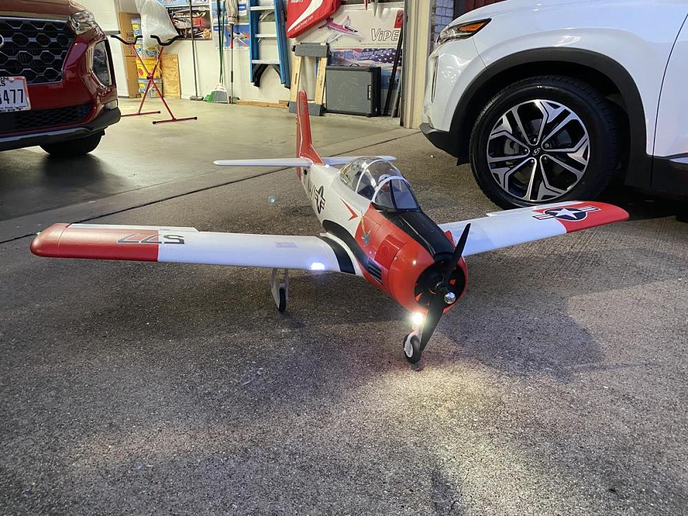

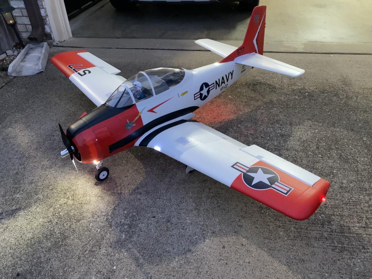

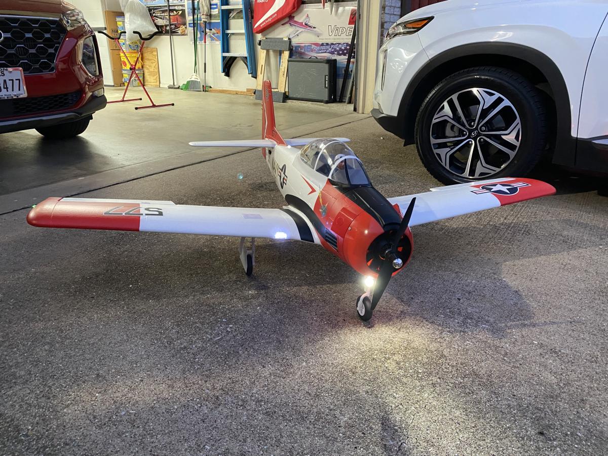

I have a question using the Freewing Light Controller on a E-Flite Carbon-Z T28 and am using a light kit from a Freewing F-15, the landing light snaps right on to the front stock landing gear, and will use the strobes on the fuselage, but the landing light works only with the gear up. Does anyone know how to correct this?
I came across this problem using the xwave gear on an arg with the tigercat box.Originally posted by ken.swa@outlook.com View PostI have a question using the Freewing Light Controller on a E-Flite Carbon-Z T28 and am using a light kit from a Freewing F-15, the landing light snaps right on to the front stock landing gear, and will use the strobes on the fuselage, but the landing light works only with the gear up. Does anyone know how to correct this?
Essentially the blue box and freezing gear are set up opposite of everyone else. I ended up using an electronic switch and mixing the landing lights with the gear.
