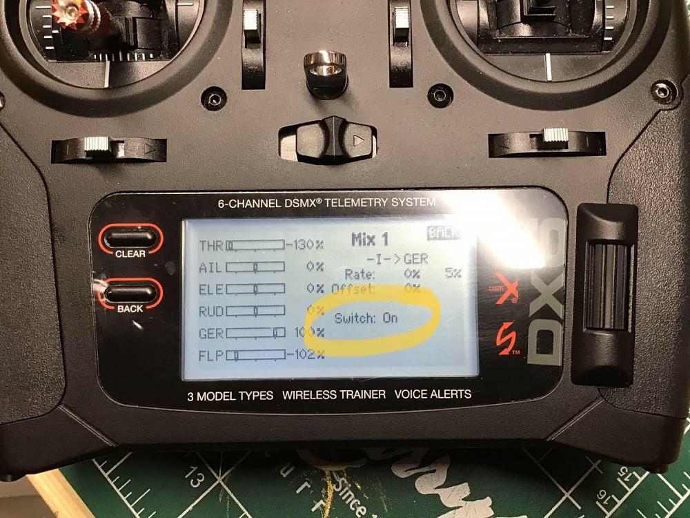

                        Hey Guys,
                        I am having the same problem installing the RX600SP. My transmitter is a Spektrum DX6
                        I feel like I have performed all the proper steps for setting up the transmitter and receiver properly, but I am not getting the receiver lights changing when I push the momentary push button. I have the receiver set in "Stabilization Combo A". I have a solid Green light on the receiver and the ailerons do seem to be correcting (in the proper direction) when I roll the aircraft quickly with my hands. However, when I push the momentary button, the receiver lighting does not change. I changed the receiver to combination C but, again, no change when the button is pressed.
                        I'll walk through the entire binding process again and follow every step and followed the suggestions above with no success.
                        - latest firmware in my Dx6 (Ver 2.01)
                        - gear switch was tested in both default position and inverted position.
                        - tried both +5 and -5 in the mix. (Also tried increasing to 10)
                        - radio shows switching on display but receiver never responds with changing lights
                        - tried creating new model but same issue with RX600SP
                        - changing to combo b and combo c the gyro stays on at all times. (Appears to be problem in RX600SP.)
                        - I can turn the gyro off and on with all dip switches off but cannot do it remotely from radio.
                        Has anyone else found a solution to this type of problem?
                        Tks
                        Kevlar

                              • Kevlar
                                • May 2019
                                • 7

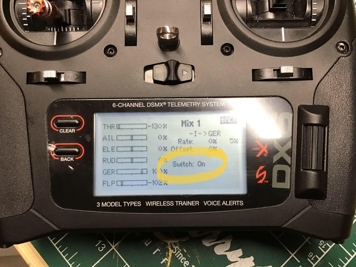

                                Like this?
                                • thisguy65
                                  • 509
                                  #17
                                  Yes, when pressed you should see the gear value change by 5 points

                                    #18
                                    Click image for larger version  Name:	D210028E-7B58-42E5-A5FA-E7303C93F63E.jpeg Views:	0 Size:	247.4 KB ID:	193455 You need to highlight the “SWITCH” heading and the assign it to something on the Transmitter like Switch B or C ( a 2 position switch to turn it on and off.) The way you have it now is just. ON. No switch assigned.

                                      #19
                                      thisguy65 yes when I press the button “l” it changes by 5. Just like the videos.
                                      F22trainer i have tried you suggestion and it did not work. No where in the instruction for
                                      the RX600SP do they mention that and also in all of the videos from MotionRC they also don’t mention that.

                                        #20
                                        Switch H is usually for Throttle cut. Did you try switch C? I don’t remember which video, but he does tell you how to assign it to a mix and such.
