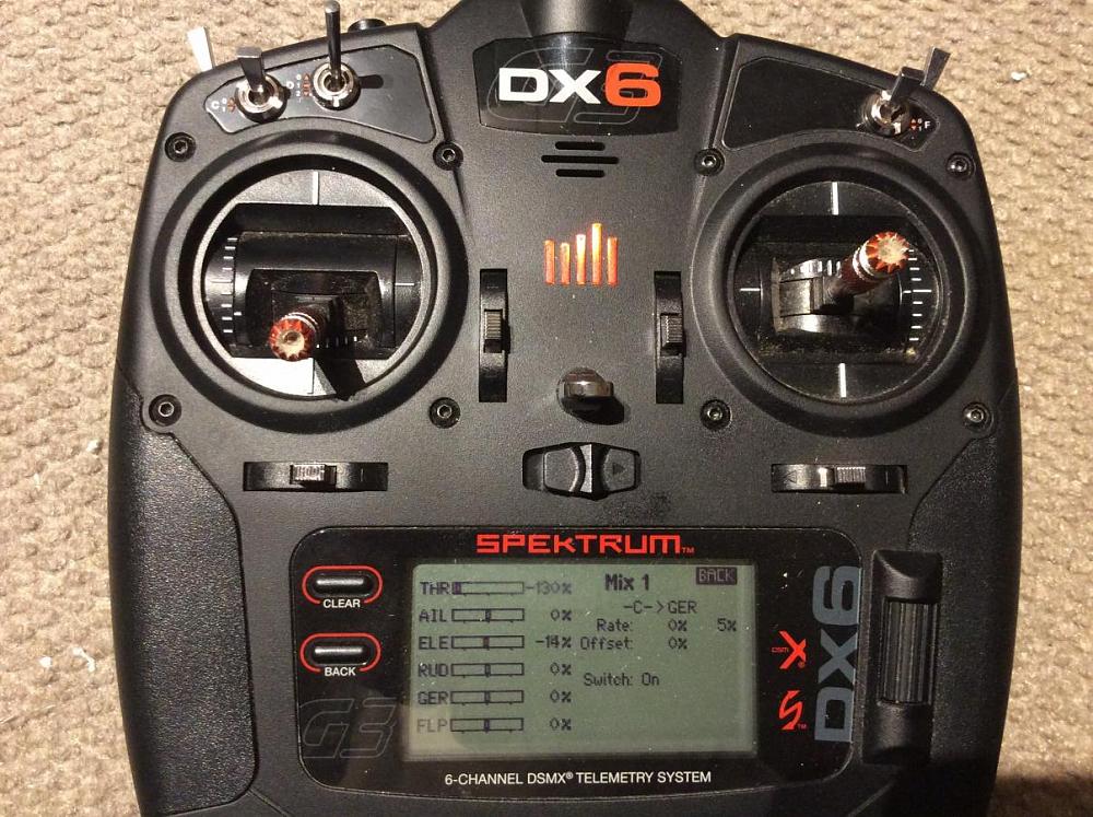

        #23
ID:	193548 I just realized the videos on UToob are not the ones with Ryan and Mike...
        My plane is set up for Combo C, and truth be told, I seldom use the gyro but it does work well. I found I get the same results with a low rate at 70% and an expo of 20%. When I use the gyro I put it into high rates and expo off. Been awhile since I set it up so I was wrong about the SWITCH setting...yours is ok as mine is same.

          #24
          The problem with my RX600SP happens regardless of rate or expo setting.
          as indicated I’m my previous post the receiver responds incorrectly regardless of any radio connection.
          I have a DX6 and I'm trying to set up my 600SP on gyro combo C with no luck. I followed the video instructions to the letter but when I'm in combo C I can't get any switch including the bind switch to turn on the gyro, nothing happens, no lights change color, nothing. I did set up the mix just as the video shows. The default
          I have a ticket open with product support and they are looking into the issue.
          Thanks for you help in trying to resolve the issue..
          K
