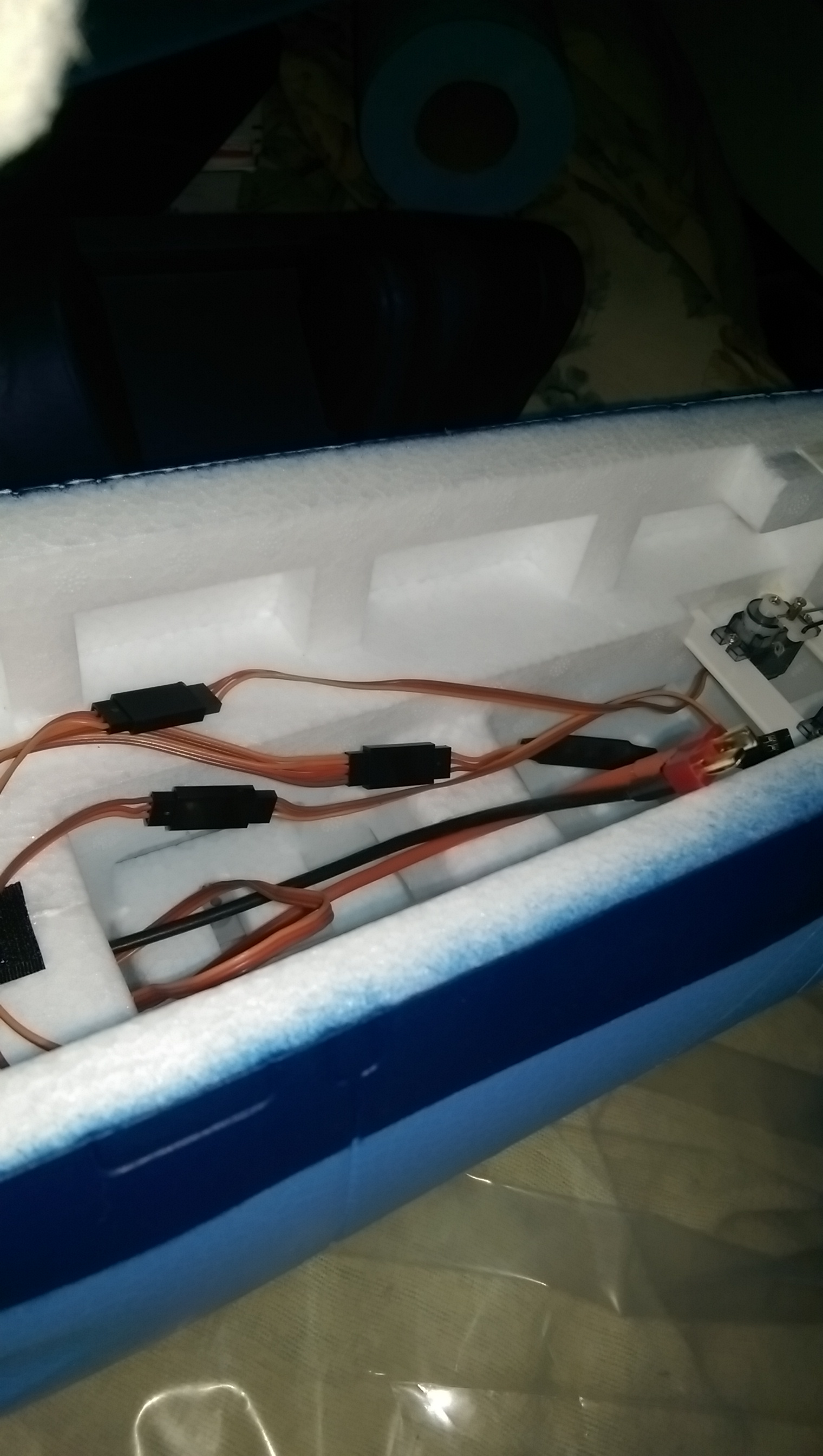

The F6F has a rather large bay area to work with and would like a recommendation on placement for the a3l and the tactic 8 channel receiver. Had thought of adding a platform in the plane to mount both sides by side or just mount them vertically on the sides. I would appreciate any suggestions and comments. Here is a picture of the bay area. Well I thought I was going to add a picture but having difficulties doing so. Anyhow Dynam Hellcat. Thank you.
F6F Hellcat Gyro/Reciever placement

I would put the gyro in that recessed spot aft of the wingbolt hardpoints. Then the rx can be anywhere. I'd prefer the gyro be centered rather than tucked away on its side, especially since you have the room. Of course it can be mounted on its side, just not necessary on this application. -

Raynn , are you speaking of the flat area below the flat area under the hard points for the wings.Dewey lComment

I believe he is, Dewey.
