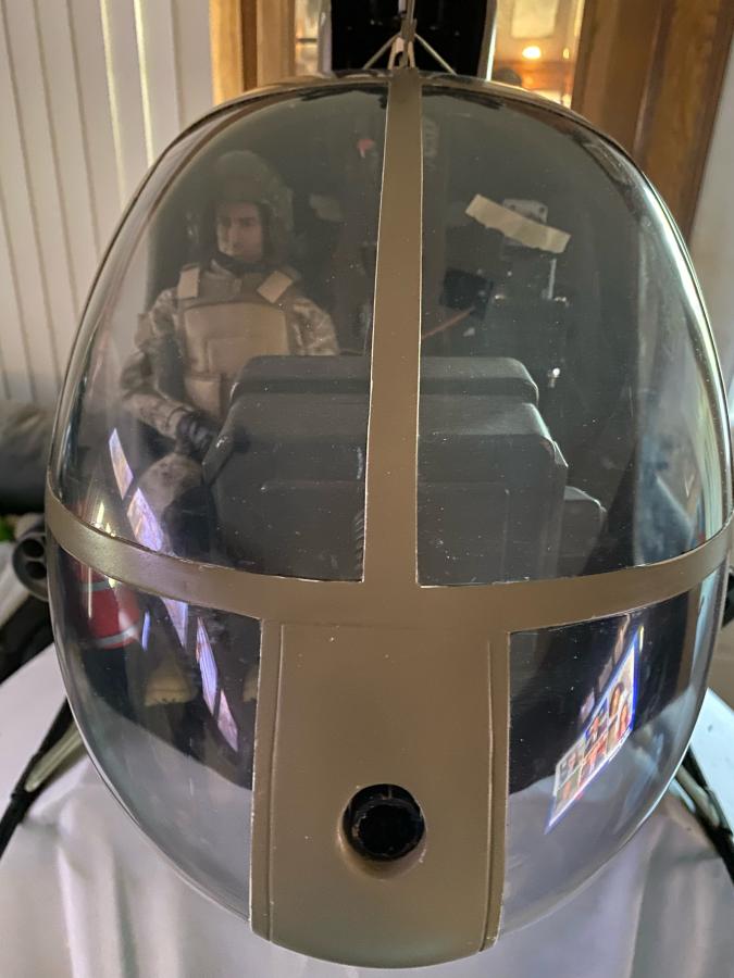

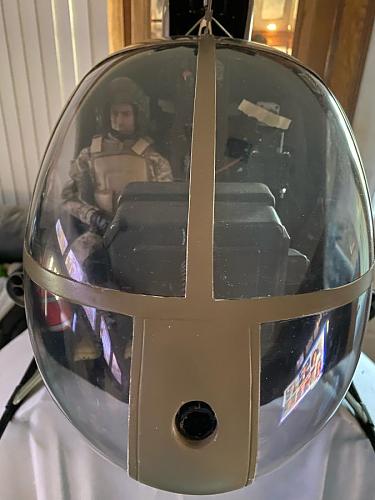

    I got the cockpit interior section finished and installed between camo painting sessions on the fuselage. I received the Futaba trainer cord from Motionsic and their head tracker unit works great. The software install for the tracker is a little tedious but got the unit configured easily once configured on my PC. I am a little disappointed that Futaba assigned the Tx trainer switch to a non-configurable spring loaded one, so unless I open the Tx up and resolder switch pins (not happening) I am stuck with using a tie wrap to hold the switch “on” while flying. The good news is the head tracker automatically defaults the camera to center position if the tie wrap slips off so I will still see straight ahead. Getting closer to the maiden daily…

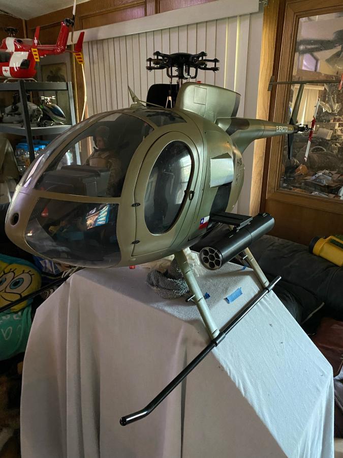

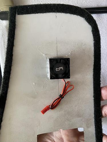

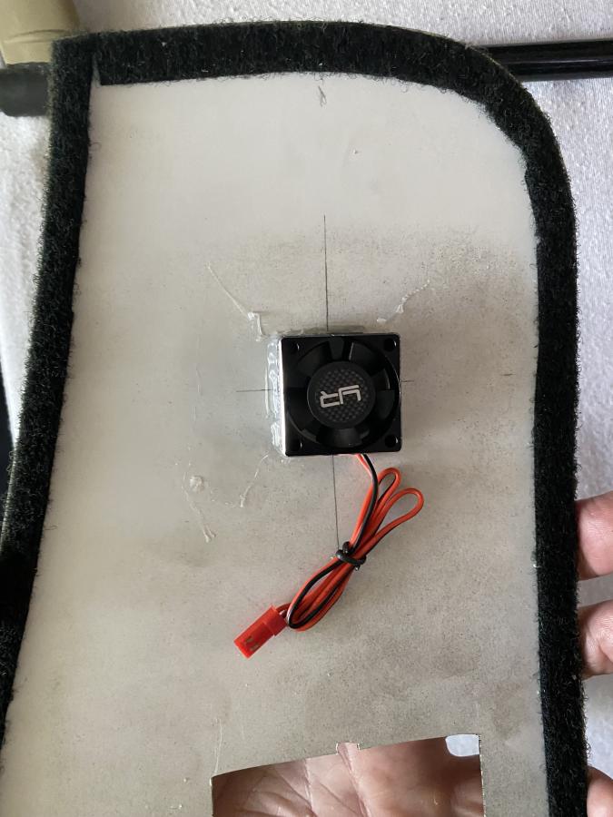

                I discovered the single Tornado Plus fan mounted on the Caddx FPV air unit helps, but doesn’t fix it’s overheating issue when the heli is outside in 85* air temp and the ESC and motor are heating up the fuselage interior. Since the MD-530F can be configured with vented solid rear doors as an option, I built a set of doors from styrene and mounted a 30x30x10mm Tornado Plus fan in each set to exhaust mode. These fans are rated at 5.5cfm each so will completely replace the fuselage air volume 4 times a minute and hopefully help the Caddx fan. We’ll see…. Click image for larger version

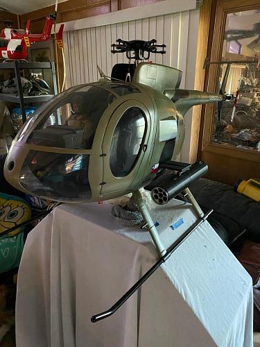

                  FPV MD-530F Updates: The door fans mod worked, at least for 3-3 1/2 minutes in 82* OAT and 70+% humidity, which is typical of SE Texas summers. The door fans create just enough negative pressure in the fuselage to keep decent air flow. Definitely will be an early morning flyer which suits me just fine.

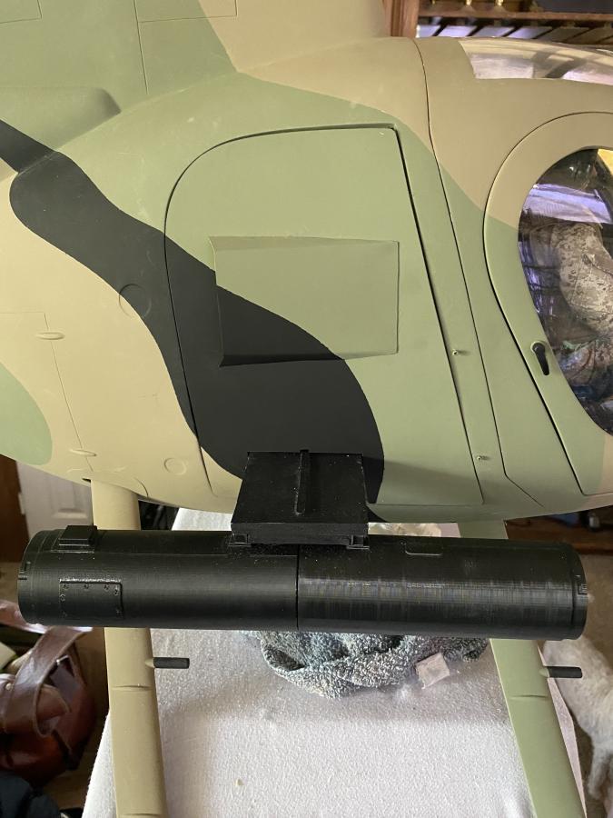

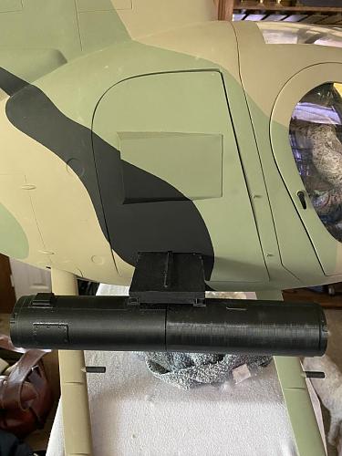

                  I am a little disappointed with her weight: 7303g all dressed and ready to party. IMHO, that’s a little too heavy for 600 mechanics with nylon gears so the rocket pods and mounts won’t fly…at least at first.
                  I still need to upgrade the Beast X to the Pro version for the rescue feature. Also, I am giving some serious thought to upgrading my T10J Futaba to a newer radio just because the 16/18 SZ series radios allow the assignment of the trainer switch (needed for head tracking) and the T10J does not. Haven’t made peace with a tie wrap holding that spring switch on while I’m wearing goggles Click image for larger version
