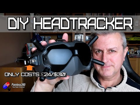

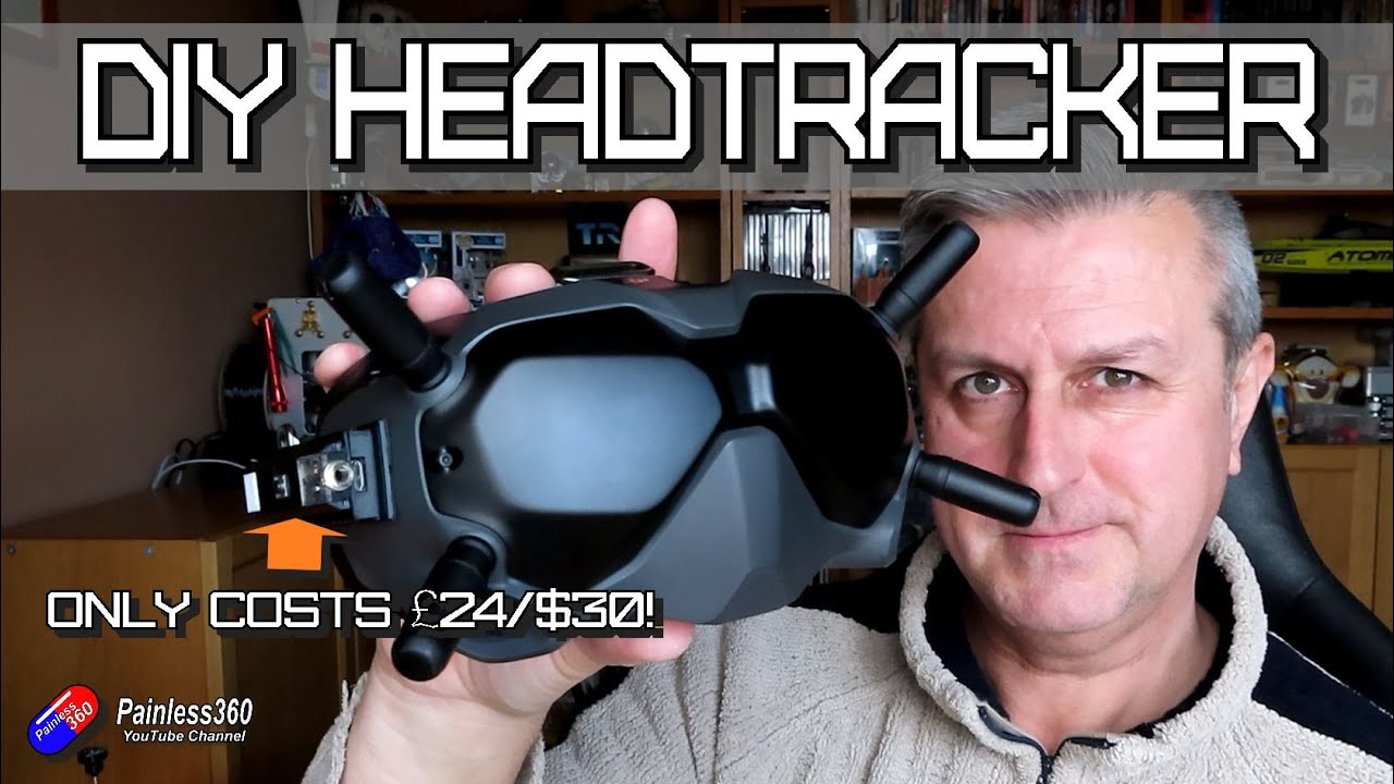

                  for setup using FrSky radio, checkout Painless360 on YT. You can also build a head-tracker on the cheap:

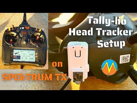

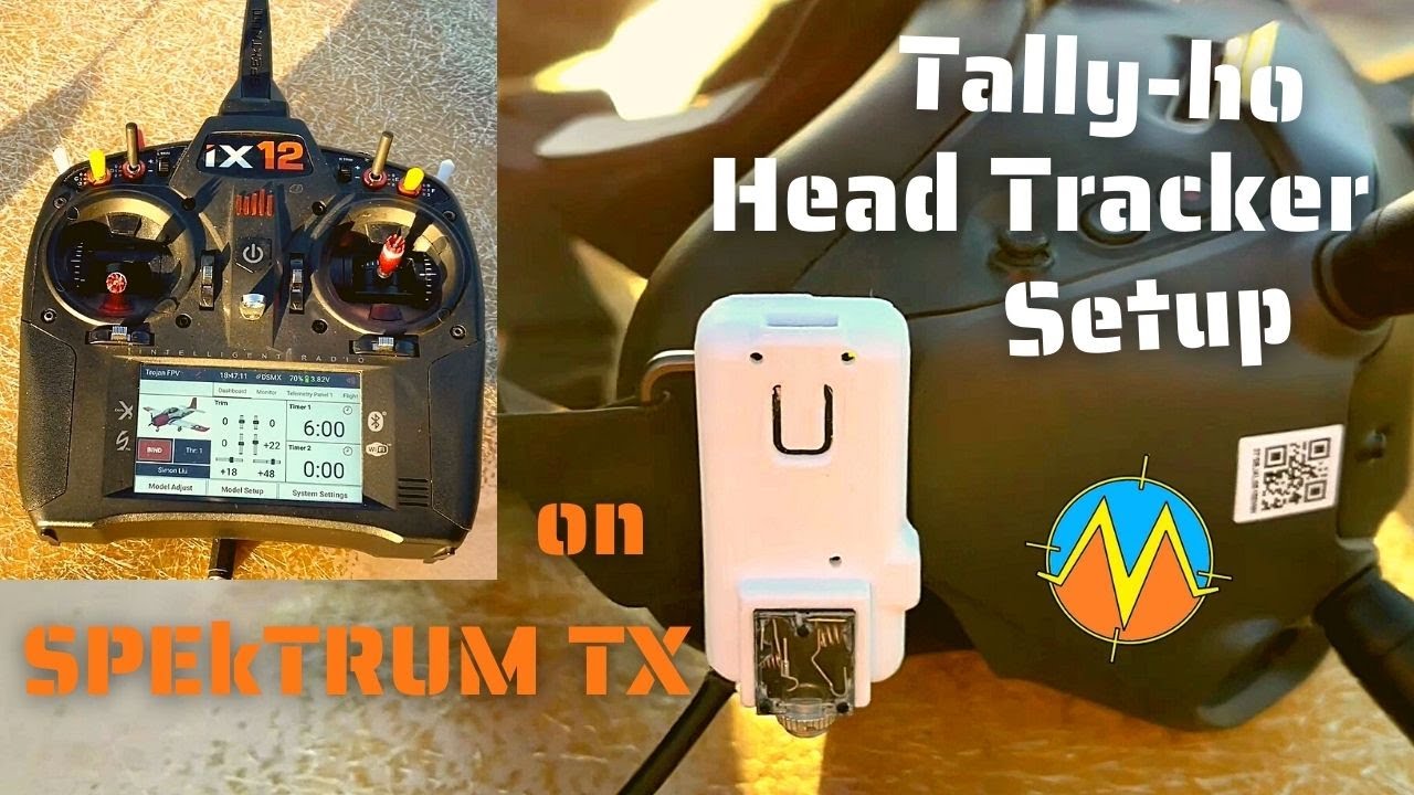

                              #74
                              Made a little how to video to setup head tracker on Spektrum radios. Hope it’s helpful
