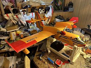

    I'd like to put differential thrust on the following seaplane for better ground steering. I can do it in one of 2 ways ................... 1 way is to go into channel assign and tell AUX1 to be controlled by throttle OR 2, by doing a mix of Throttle>AUX1 (INH switch D). Doing the diff thrust with RUD mixes is easy. That part is easy. However, no matter which way I do it, I can't get Throttle Cut to work on AUX1 (2nd throttle channel), only on the main throttle. I've tried various mixes but the 2nd motor will not completely shut off with TC, only slows down. I would like TC to work on both motors. Anyone know of a solution?
    Spektrum NX10, Lemon 8-ch. RX.
ID:	362486 BTW, this is what I did with my old Flightline OV-10 motors, props, spinners and unused ESCs from my AL-37/PJ50.

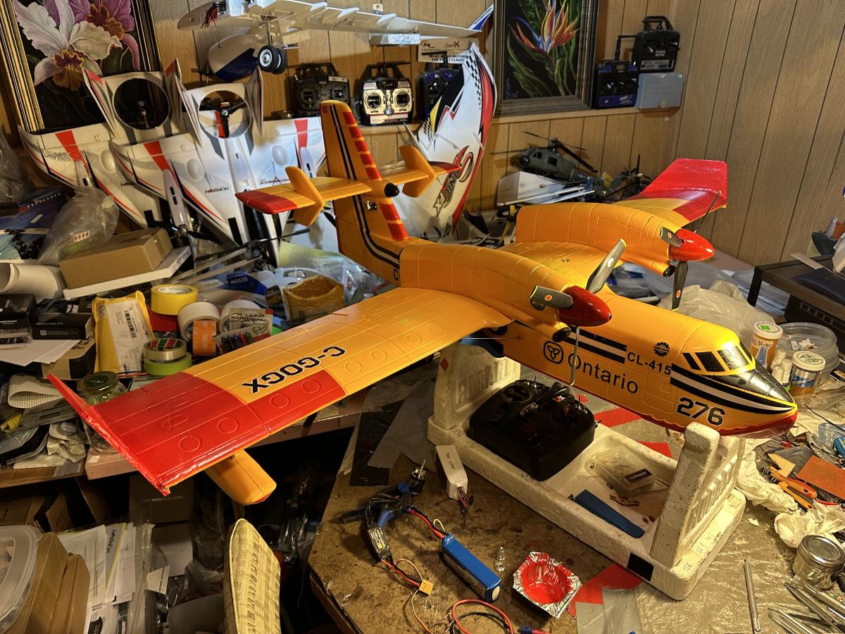

            This is my second Canadair CL-415. The first one was able to turn "OK" on the ground but it took some effort and space.
