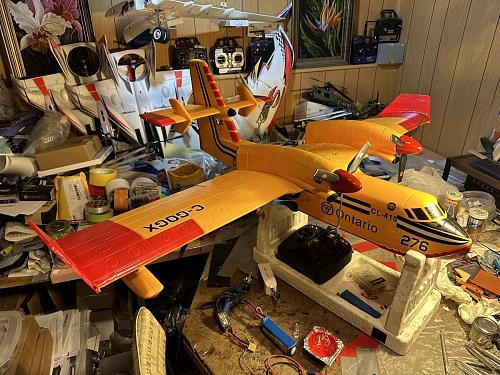

                                I've just programmed your method into my Canadair. On monitor, it works. I'll need to power up the plane to make sure I don't need to reverse something. At the time the Widgen first came out, nobody in Canada sold it and to ship it from a seller in the US cost almost as much as the plane was worth. I gave up on it.

                                • Ricky R
                                  • 40
                                  • Wallkill, NY
                                  #36
                                  Let me know. I haven't done an actual test either.
                                    • 8766
                                    #37
                                    Couldn't wait for spring. Had to do it now. It works.
                                    • Ricky R
                                      • 40
                                      • Wallkill, NY
                                      #38
                                      Excellent!
