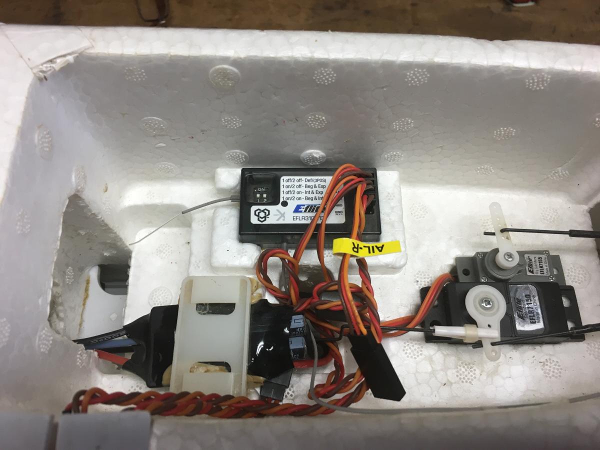

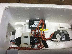

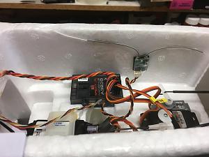

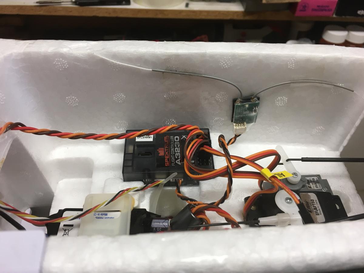

        If it will help I can take pics of old (no flight controller, the SAFE was built into the receiver) and new (separate receiver and fight controller and the SAFE is in the flight controller)... I happen to have FOUR Apprentices here at home I use for teaching.

          Evan if you would take pictures for me because this is the 3rd apprentice I’ve had and the sts wiring is different to the older ones with safe rx. Thanks Gary

            STS on the top, the actual receiver is on the side of the fuselage.

              Evan I can see the wiring is different on the first picture. The wires coming out of the side and going to the rx did not come with the airplane. I’ve tried to contact horizon hobbies to find out what I was missing but have gotten no response. Can I use any spektrum rx with the A3230? The cable going into the side of the rx has me confused because I’ve never had a cable and plug like it. Thanks Gary

                Evan I got a buddy who researches well to help me and he found where a Spektrum 4650dsmx srxl2 is compatible with the A3230 and has the cable to hook up to the rx. I’m glad you sent the pictures which helped very much. I ordered one off eBay for $27.00 which was not bad. Hope to get it flying soon. Thanks a lot Gary
