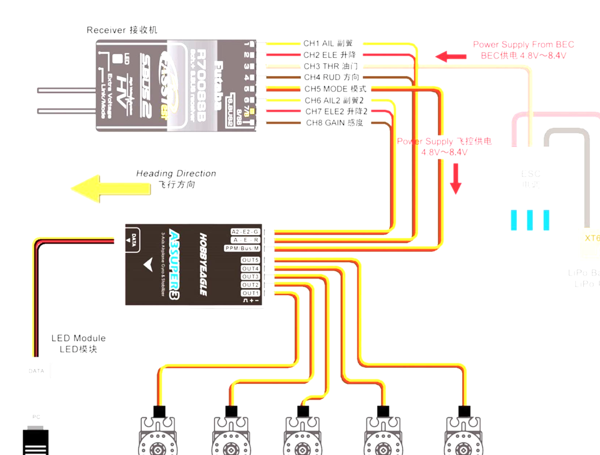

    I have it hooked up and when I do inputs on the radio, everything works as it should, but when I hit the self-leveling, if I bank to the left or right the elevator levels, if I pitch up or down the ailerons level. I know something is backwards, but can't figure out what it is...any ideas, thanks in advance
    I've tried all of the different mounting positions, no change...thanks

        Of all the mounting positions, the end with the pins must always point to the rear. The A3S3 uses those weird wires where on one end, there is the standard single plug with 3 wires. The other end of this cable splits off into 3 separate single wire plugs. You must disregard the color of those single wires. ALL of them are "signal" wires and therefore must be plugged into the RX in their signal pin. Can you confirm that this is the case? Or have you inverted one or more of these plugs? Additionally, do you have the AIL plug and ELE plug in each others port?
        Pay particular attention to the "A-E-R" port on the gyro and where it leads to in the RX.
