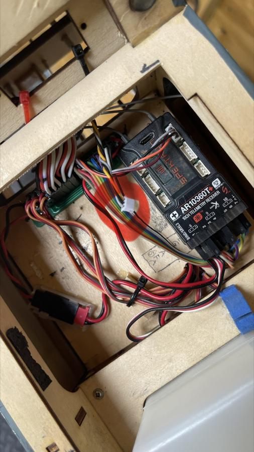

3 pin remote aerial to SRXL2 port ?
  • Simon Bee
    • Oct 2021
    • 135
    • Leeds UK
    I want to connect a remote aerial to the SRXL2 port on my AR10360T receiver. It’s a 3 pin connector but a 4 pin port. Do I need an adapter? The 3 pin will fit but it’s a question of which side of the port to fit it.
    • 5395
    My understanding is you can't put a satellite into that port, only a remote receiver. I would ask in the radio section of RCG.
    • Simon Bee
      • Oct 2021
      • 135
      • Leeds UK
      Sorry yes, I meant remote receiver.
        • 5395
        Again I would ask but maybe this will help. One pin is not used.
        57601.2 Spektrum DSMX Serial Race Receiver V2 Manual_MULTI.indb
        • kallend
          • 1874
          Older (3 pin) remotes don't work with the AR10360T, they use a different protocol. They changed to a 4 pin plug to prevent people from trying.
          You need a remote like a SPM9747 or a SPM4651T which come with the correct cable.
          • Simon Bee
            • Oct 2021
            • 135
            • Leeds UK
            Ok thanks very much, I’ll get one of those. Trouble is, it’s a big old 19.2 lb Hangar 9 Spit which I bought off somebody and the remote is hidden somewhere in the wing, so I’ll have to try and remove it. Think it’s some kind of Lemon remote.
              • 2696
              As kallend pointed out, that old SRXL sattelite will not work with the SRXL2 AR10360T. I wouldn't waste time or surgery on the aircraft removing the old one, just remove any exposed wires and leave it for posterity, obviously small enough to not affect balance.
