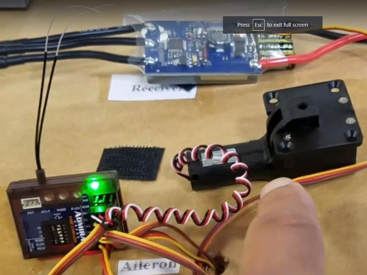

    Here is a screen cap from a video I made showing one of the gyro/receivers. You can see the entire antenna in this screen cap.
    Gyro/receiver antenna
  • Tom
    The Antennas are slightly cropped for the pictures. There is a metal portion of the antenna which is about 2" long which is cropped off along with part of the black plastic outer portion. If I had to guess, I'd say there is 3 inches (or so) cropped off for the pictures.
    Originally posted by davecee View Post
    The pictures do not appear to be cropped. Enlarge the pictures and you'll see what I mean. I've used receivers with satellites and I've used diversity receivers with long whiskers. I've not had problems with either. Careful positioning of the receiver (as far as possible from large signal blocking masses), maximum distance separation and orientation of the whiskers as well as the satellite (if used) is paramount. I'm constantly amazed to see some of the receiver set-ups of some flyers.
    Now that I look at them on a larger screen, I see the pic is not cropped. Also noticed that the diversity antennae are exiting the receiver at the same point on the case.
