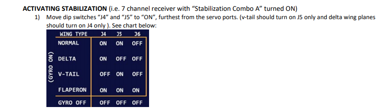

    Im putting this receiver in a fun jet dragon. Okay I got both ailerons moving, operator error of course, the left aileron servo was plugged in backwards, I guess that is why it was making the buzzing. Still having issues, both elevon aircraft type on my dx6e are not allowing the elavons to work together. Moving stick to the right moves only one side back and fourth and up and down moves the other. My dip switch J4 is on, left ail is in elevator. From what I’ve read/watched there shouldn’t be any mixing on TX to get it setup. Hoping to fly it today ????
    It's been said a couple of times. You DO NOT set TX for elevon when you are using a gyro type RX or a gyro. The TX MUST be set to "normal" type of wing. The wing type is ONLY set in the RX or gyro.
    PS. Are you sure J4 is ON? It's a tiny little dip switch. It may not have clicked into position. Try flipping it with something small and pointy until you feel it click. If it's not actually in position, it may still think it's set to "normal" wing.

    Originally posted by Corpster101
    I followed exactly as your instructions above and right aileron operates but Left aileron isn’t working. Do I need a y harness for this to work? I’ve tried plugging in left aileron on all ports of rx with no luck
    What aircraft specifically do you have? Since you are going to an Elevon/delta setup, then one aileron servo lead plugs into the aileron receiver port and the other aileron servo lead plugs into the elevator port. You definitely do not want a Y harness for this.
    NO, a "Y" harness CANNOT be used for a "delta" wing plane for the ailerons because they double as elevators. A "Y" joins them together. They must be separate for a delta to work. You need to use a servo tester to see if both servos are actually working. It's possible that you have a dead servo. However, without a servo tester, you can still see if the other servo is working. Plug that one into the port that IS working the good servo. If it works, then you may have a defective RX or you've still not got the proper switches thrown on the RX. Those little dip switches are hard to see if they are activated. You have to almost feel them click in to know they actually went in.
    Oh, what happens when you work the ELE stick. Does this work the "dead" side? If it does, the dip switch is NOT flipped.
    Yeah I’ve watched the how to videos about 30 times but my lightbulb it’s going off I guess. Oh I thought the dip switches are for gyro on? I would like to use gyro/rec but figured I’d get the elavons working first before getting the turning them on. Had this same issue with my friends BNF delta ray, dual ail and flaperon was the only way I could get it work. My steps for my funjetbare
    create new model, (I’ve tried all types now)
    ive been skipping the mix setup also because I got agitated lol
    i leave dip switches off(again just trying to get elevon a to work first. Insert bind plug. Power off rx, power on RX then TX while holding bind, bind is confirmed, I only have ESC plugged in at this point, I put r elevon to aileron and the right works, tried all ports for left and no luck. I’m wondering if I’m missing a step in my TX?
    Start from the beginning. Create a new model and make it just a standard plane. Don't tell the transmitter it is a delta/elevon setup. Just a standard plane and get it bound up.
    now you should see this picture (below) on the back of the receiver:
    Click image for larger version  Name:	admiral gyro.png Views:	0 Size:	68.0 KB ID:	178599
    This is where you are going to tell the receiver what type of aircraft it is. You will see 6 switches on the receiver. Ail/ELE/RUD/j4/j5/j6. for a delta wing, you need to only have switch j4 in the ON position, j5 and j6 are off. then the ail/ele/rudder switches will be to reverse their correction later once you have it working.
