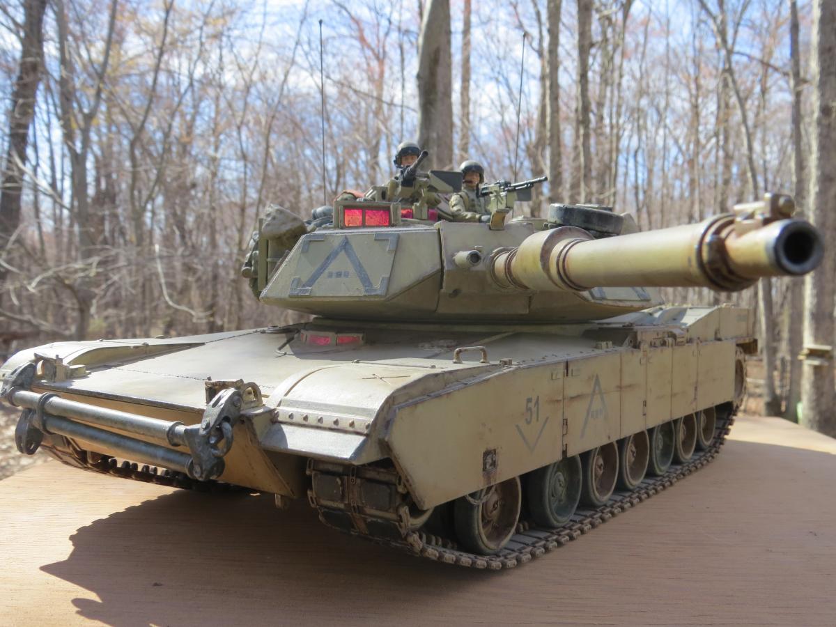

        I have used various flat clear sprays on my 1/18 scale military vehicles and Tamiya Flat Clear is the best hands down. Unfortunately it is not cheap.

          It's only $400 per gallon! :Crying: I agree, Tamiya spray paint/clear is the best.

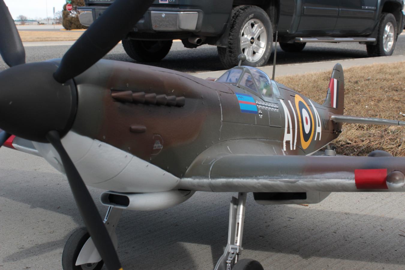

              I know everyone has their preference, recently I tried Minwax Spar Urethane matte with an airbrush (airbrushing will make any paint duller than using a brush to apply) with great results.
              Worth looking at as a quart of this is very reasonably priced (Amazon)

                I was thinking of trying it in a detail gun - does it need thinning and what delivery pressure?
                  • 7369
                  I watered it about one to five, pretty thin as it is.
                  I used the small compressor, which peaks out at 60 psi, but loses pressure quickly, so between 30 and 60 psi. Thin layers is the secret. I gave her three with 8 plus hours in between.
                  Great way to seal decals as well.
